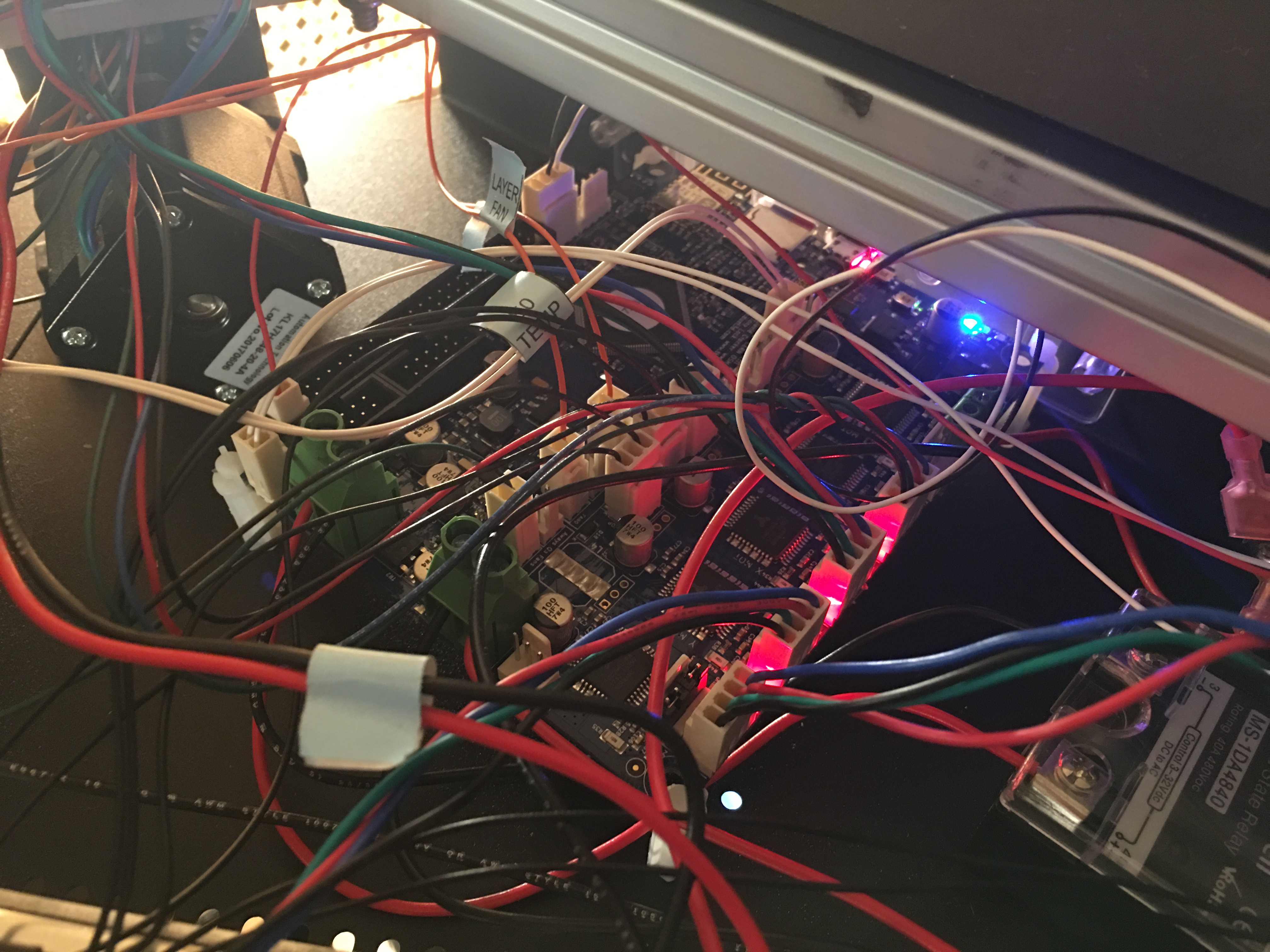

OK, this isn't my first rodeo, but I don't see anything in the way of the motors or belts. The movements are very "jagged" or "stuttering". I'm afraid to do the First Probe. It skitted across the bed and then probed a few times but sounded horrible so I emergency stopped.
Also, the Z tower homes down first... I know, check the wires, but they are all correct as per the instructions: Blue, Red, Green, Black.
I had some really close blue/green wires, but I quadruple checked in good lighting--I'll check again after posting.
Anyone else get this problem and know what I did wrong?
*edit, here's a photo of the duet in case it helps.
And, a youtube upload (never did one before...)
https://youtu.be/wivW865AECE
messy wires as I reconnect and attempt to debug.
*edit2, I forgot to mention that I did download the latest config.zip and upload it... I've got the first probe macro.
*edit3, I got it to accept a homing so I could test moving again. The Z axis alternates from going in one direction then the other every time I ask it to move in the same direction.

How does it go when you home all the axes? Is it just the Z axis you're having a problem with?
adarcher
Posts: 138
Re: First homing: horrible grinding sounds
Post by adarcher »
Just added a video and a picture.
I've only tried homing all axes at the same time. I tried moving 100mm up and down and it sounds horrible too.

I suggest you test the tower motors individually as described at https://duet3d.com/wiki/Configuring_Rep ... dividually.

First thing I noticed in your video... the USB cable is connected to the Artemis.
Is it also connected to the computer? If so, it should not be... that caused grief for me when doing the first probe... it kept timing out. So remove the USB cable entirely once in Duet, then refresh the Duet web page.
I don't know if this is what is affecting your build, but it was worth mentioning.

dc42 wrote:I suggest you test the tower motors individually as described at https://duet3d.com/wiki/Configuring_Rep ... dividually.
Thanks, It's only the Z that is noisy and alternating. I checked the pins with a multimeter and red/blue and black/green are the two pairs.
It's the motor and not the board thankfully. I swapped the motors with another axis and it's the same motor that is noisy.
Have a resource that can help me further trouble shoot the motor?
adarcher
Posts: 138
Post by adarcher »
OK, I think I solved it. The spring side of the red pin wasn't super springy so the contact was not consistent. I pulled it out, bent it out a bit and now it's good.
It's now taking it's time doing the first probe... I'll post again if I get a first print :)
Thanks for all the help!

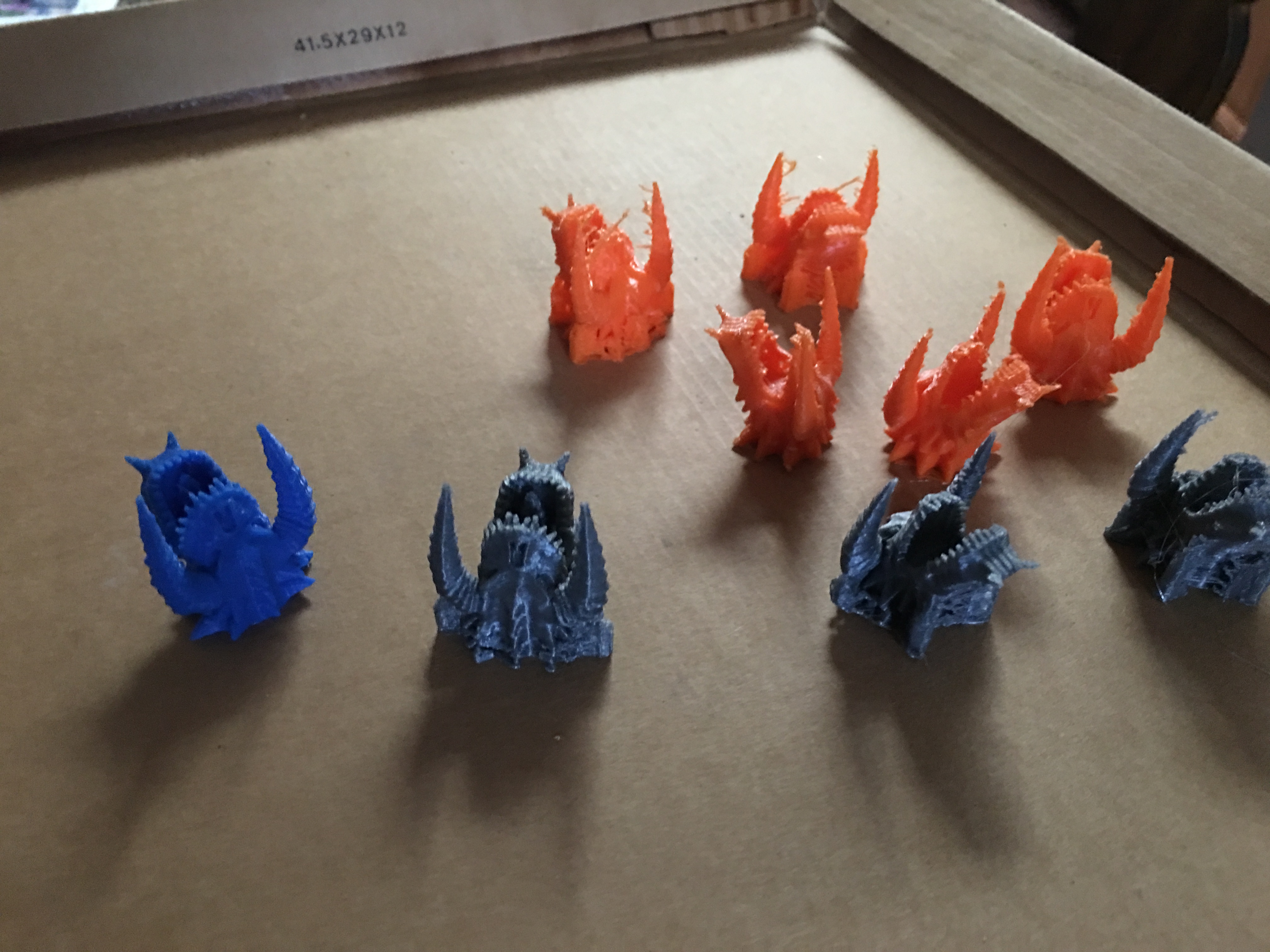

Well, I got a first print that night, but it was all stringy.
Been repeating the model with different retraction settings ever since.
I started with the cura 2.6.2 profile for se300 from the guide. I increased the travel speed and varied the most of the retraction specifics and even the temp (started at my usual 210 and went lower).
I compared it to a “out of box” settings print from my new prusa mk3, and have been disappointed. Not going to give up, but really wishing it would at least be as good as my old v2. Here’s a pic of most of my tries. The blue and silver print the same on the prusa. Blue is the prusa print. The silver next to it is the Artemis with my old v2 settings. Same speeds at 60mm/s. All the rest to the right are tests.
I’m having breakfast so I can’t post settings. But they really are just the imported values from the guide.

What retraction settings are you using, and how long is the Bowden tube? Are you using pressure advance?
On my delta I print PLA at 205C first layer, 200C or 195C after that; but that is with an E3Dv6 hot end.
adarcher
Posts: 138
Post by adarcher »
Looking around for pressure advance, looks like a duet setting... I'll look into it.
I've tried 3.5-12mm retraction, stuck to 6.5
25-60mm/s retraction speed, right now it's at 25 since that's what the profile has.
I upped the travel speed from 100 to 400mm/s and that seemed to do the most at reducing the strings.
Bowden is about 400mm I think, it's the stock one.
dc42
Posts: 454
Post by dc42 »
adarcher wrote:Looking around for pressure advance, looks like a duet setting... I'll look into it.
Higher retraction speed helps control stringing. I use 60mm/sec and 0.25mm Z lift. The Bowden tube on my delta is 600mm long. I was using 7mm retraction, but I now use 5mm and pressure advance 0.2.
HTH David

Have you tried reducing the extrusion temperature to control the stringing?
adarcher
Posts: 138
Post by adarcher »
dc42 wrote:Have you tried reducing the extrusion temperature to control the stringing?
Just tried 195 with the new cura 3.1 profile... no change. I think I'll just only print things that don't care if there are strings.
I spent hours today trying to test only for the test prints to fall off the bed most of the time too. Looks like I can't set the z height with G30 with the duetwifi.
On my V2/Rambo:
G28; G0 X0 Y0 Z5; G30; M500;
at the start of my print would give me a new z height for the temps I was currently running. Is there an equivalent? I can't run G32 with the bed heater on, the FRS's won't trigger.
I'm wondering if the Artemis has a special firmware, or if I can just update it myself to the latest.

In Re stringing
In terms of stringing it is as near non-existent in the Seemecnc Cura profile as it gets. that is with cheap Novamaker PLA which was OEMed by the now defunct Orb Polymer
Before changing any parameters
(1) I would check to see that my physical filament path was clear of friction
(2) and that the extruder gear was grippy.
Physical issue being eliminated, move to software;
(3) PID tune the hot end
(4) print one of these guys out for a baseline
https://www.thingiverse.com/thing:2640671
(5) repeat and rinse, keeping track of each and every parameter change in the slicer software on a notepad or spreadsheet.
I am at the point where I am getting minor-minor hairline stringing with Simplify3d. I am still tuning my Simplify3d profile because it has some features that Cura does not have.
There is one checkbox in Simplify3d which rocks in terms of stringing. "Avoid crossing outline for travel movements." You can see from the attached picture that, if I am going to get striging it is going to occur within the infill, or between support and support.
I am finding that Cura is much more tunable in terms of parameters, but on balance I have much more visual control of infill and supports in Simplify3d. Simplify3d also allows me to have multiple profiles in a print so I can change parameters as needed. My models tend to have holes for screws and bolts, Cura is better behaved because it retracts up and over interior bolt holes while simplify3d goes around them. Some tuning parameters in Simplify 3d include https://forum.simplify3d.com/viewtopic.php?t=1953 On balance, Cura is better in how it handles how the interior meets a perimeter.
Simplify3d also allows you to have multiple profiles in a print so you can change parameters as needed. If you needed to you could compare different settings applied to different layers of https://www.thingiverse.com/thing:2640671
If I get stringing it will be mostly within the model or from support to support. Here I have angled my support so it is not running in the direction of a layer line.
[img]https://i.imgur.com/xmgkupk.png[/img]
[img]https://i.imgur.com/3XbY51j.png[/img]
