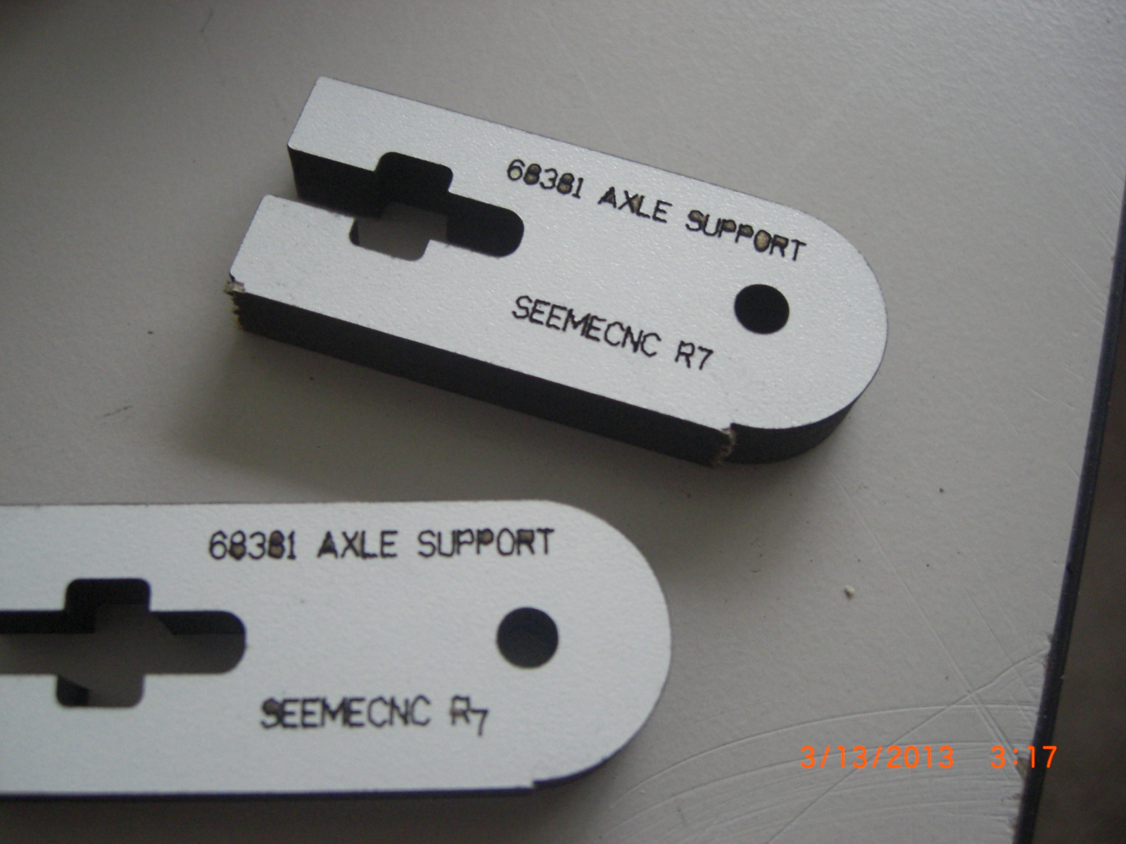

moving right along, after taking the protective film off the big sheets. 99% of the laser cut parts came right out, there were some spots that needed a little extra force. no big deal. The quality looks good. No parts look skewed from my naked eye.
looks intimidating ehh....
There was only one spot in the laser cutting that was slightly off. shown here but nothing a little sanding can't fix. Didn't look like it was drawn correctly. not laser related. All of the other axle supports were good.

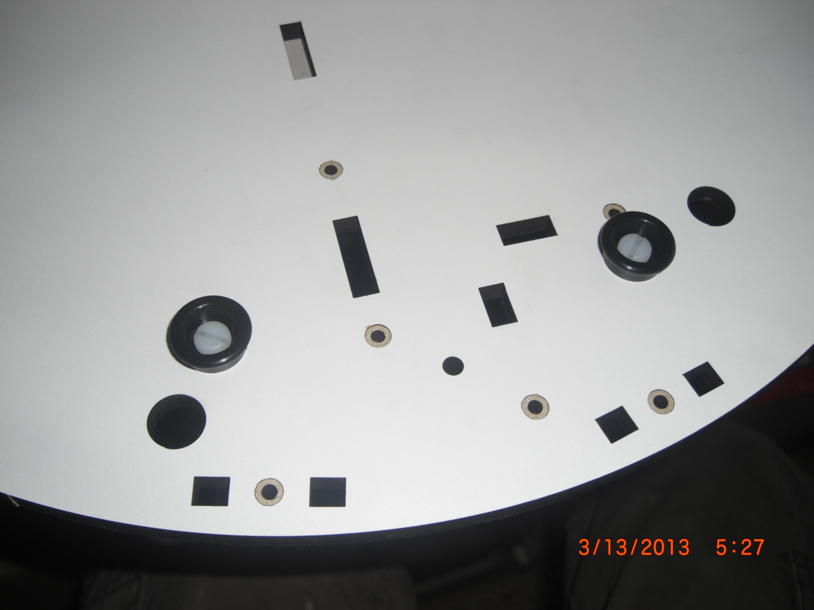

about an hour later, i'm officially rostock initiated. Maybe I shoulda worn gloves.
There were a couple of spots where the outline of the counter sink holes were not centered. hmmm
now to start base assembly.. whewww.. time for a dinner break.. more to come...
