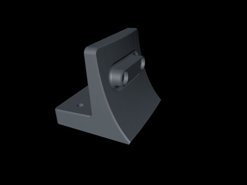

This is what the model looks like:

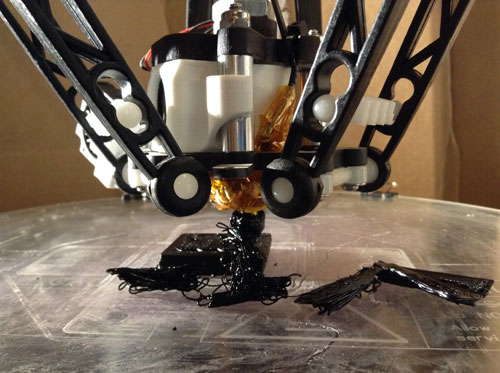

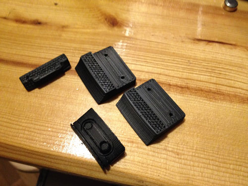

Over the past week I have, without hiccups, printed all the other little parts successfully. But this one always gets stuck. I have 5 misprints like this:

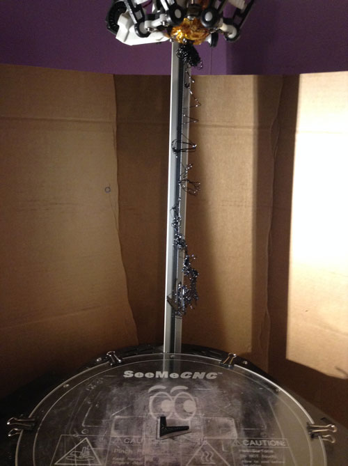

The print seems to lose a layer (it seems always at the same layer) and I end up with this:
The print gets "weird" and then the filament doesn't have anything to attach to and it starts attaching itself to the nozzle.
I am not sure where to continue trouble shooting.
