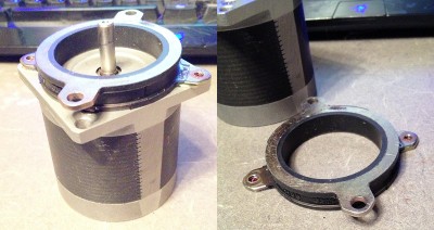

Would this work in this application?
There are other types as well, but this is what I could find quickly.
Nema23 Stepper Isolator

I think it will not work very well because in the Rostock the stepper is not only used to producd a momentum, but also to bear the pulley and tension the belt. The stepper will tilt and strange things will happen..

aehM_Key wrote:I think it will not work very well because in the Rostock the stepper is not only used to producd a momentum, but also to bear the pulley and tension the belt. The stepper will tilt and strange things will happen..
Trust me when I say that this mount will not allow for motor tilting of any type. I could stand on on side of this mount with almost no squish. I t is tuned specifically to the resonant frequency a stepper produces for each specific size stepper it is made for. The dampers were removed from a highly precise dental cnc milling application that claims accuracy down into the microns with very very high speeds. The belts were very tight. (cercon degudent mill)
It appears however, the steps may not be what the noise producer is judging by the post immediately following your initial post.
Re: Making the Rostock Max quieter
Posted: Sat Mar 02, 2013 8:18 pm
by aehM_Key
Flateric wrote:I t is tuned specifically to the resonant frequency a stepper produces for each specific size stepper it is made for.
Fair enough. Such mounts were new to me. I thought it would either be to stiff to decouple or to soft to hold the tension. Still not 100% sure, if it would work ;)

I've done a bunch more research and I am now convinced that these would benefit any 3D printer and mounting steppers to it.
I can only find 1 nema17 sized anti-vibration mount in my parts bin so this set me off on a internet quest to see where they can be sourced from.
They are not as well known as I had expected it seems. But the companies and industries that do use them generally employ their use for anything involving highly accurate positioning or placement operations. The use of the motor vibration damper (their official name) is even used for super smooth servo applications. Especially in the dental and medical equipment where accuracy is critical.
This cannot be a bad thing to add to a 3D printer clearly.
Here is a link with some information regarding them and they can also be purchased at the same link. I have used them personally on larger sized all aluminium and all steel CNC mill designs on up to nema34 sized motors. But only because I happened to have salvaged the damper from surplus equipment I had on hand and figured why not. So, just as a test I removed the damper from my CNC all aluminium moving gantry setup and the amount of noise and vibration difference is very substantial. Shockingly so actually. For a little part that does not really alter the final design by it's inclusion I will be including them in all my future stepper based creations.
http://www.astrosyn.com/section.php?xSec=44&xPage=1

appears that the mounting of the step motor is only to the damper so there are two screws holding the step motor in place, is this correct?
