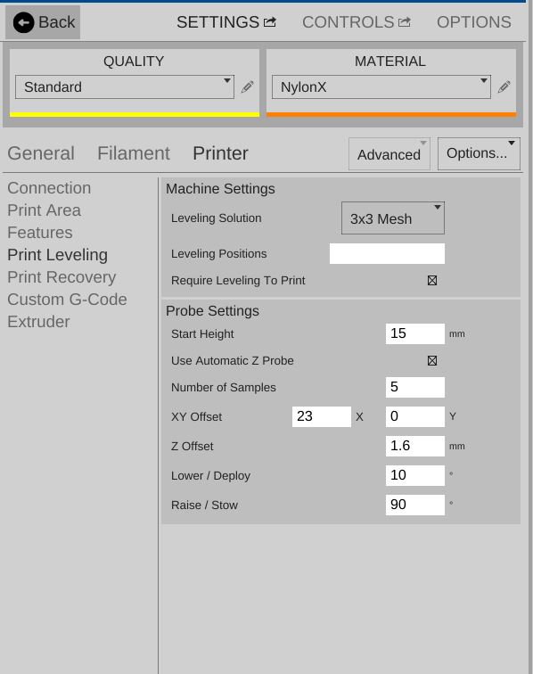

I did the twelve-point calibration, but it did as it has done in the past, which is not too much from what I can tell. It's high on the XY (front) side, while very low on the Z (rear) side. This is the same pattern that I've gotten using Matter Control's calibration tool for the last three times.
I've a tool in the past where I had to add an offset to the results to get the values positive and it did extremely well. I can't remember the name of tool, if anyone knows it, or has a recommendation, I'd love to hear it.

What type of Z probe are you using: FSRs under the bed, or something else?
How many factors did you ask the auto calibration to adjust?
Re: My printer has gotten an attitude.
Z probe? I wish... Probably the next thing to be added though.
I used the 13-point calibration routine that comes with Matter Control.
