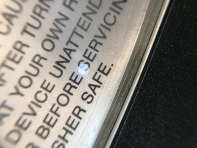

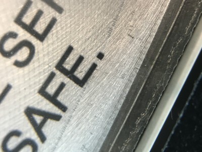

Interesting. I might be mistaken, but I think my bed has been glued on or fused to the heat spreader somehow. Could the decal underneath be sticking them together? Seems strange.
There's a kind of telltale mark of some sort of adhesive running around the perimeter of the bed. The picture doesn't show it great, I'll see if I can get a clearer shot in the morning with a lens.

Re: Bed Adhesion/Surface Treatments (Is My Bed Attached to the Heat Spreader?)
The vinyl decal on the heat spreader does stick to the glass a bit, but should come off when it's cold. There's no adhesive holding it to the glass.

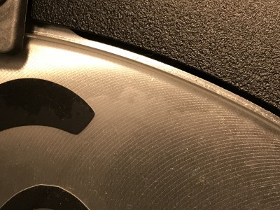

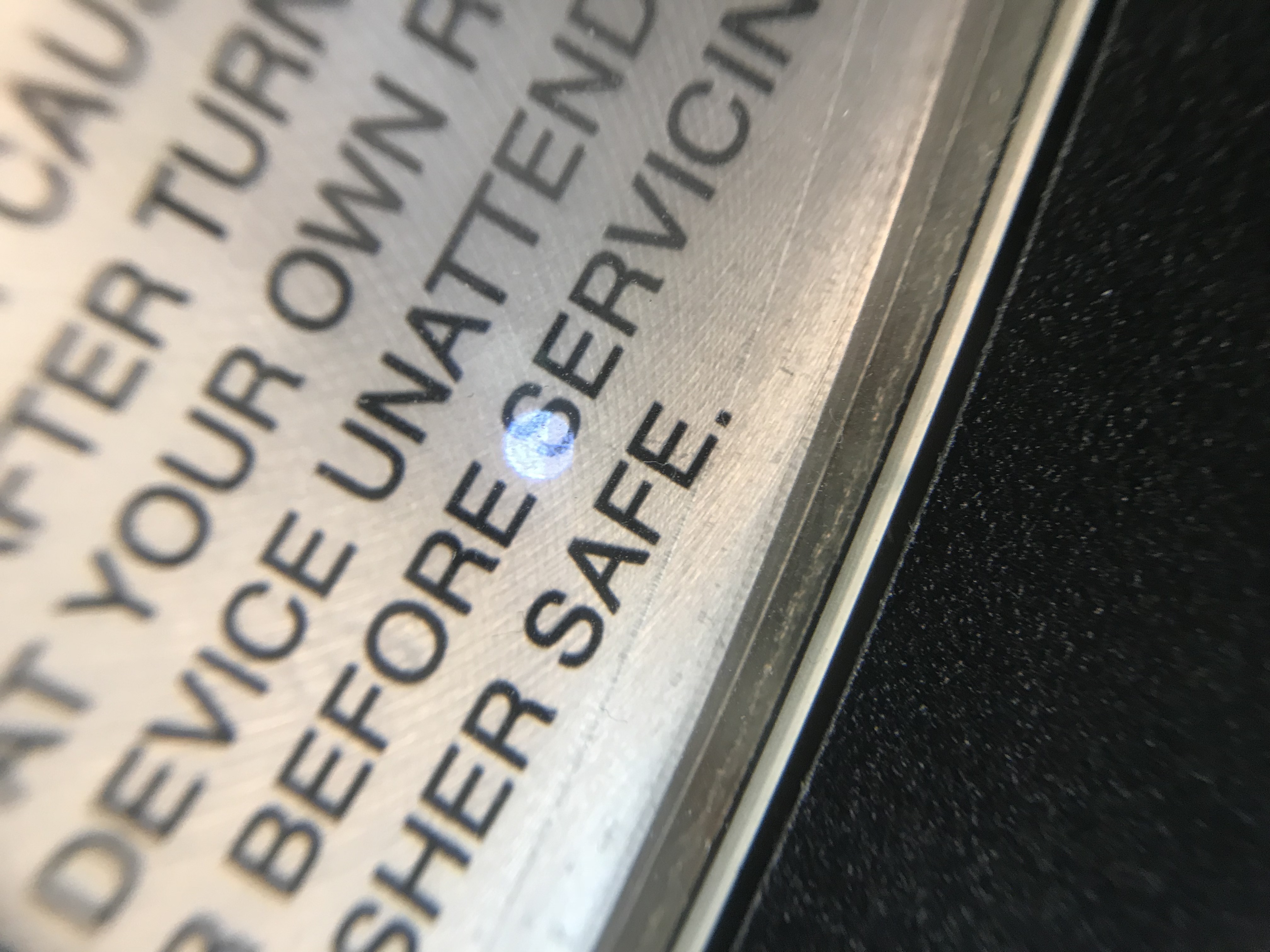

Gene, do you know anything about the assembly process, specifically re: application of the vinyl decal to the heat spreader? The (possibly unlikely) scenario I am envisioning is that the vinyl decal is manufactured with some sort of film backing on the top face which is not heat-safe, that this film was accidentally not removed during assembly at SeeMeCNC, and that the first time the bed was heated (either by me or maybe they do that while testing the sub-assemblies in house) that this mystery film melted and fused the glass to the vinyl.
It's really stuck on there. My apartment is pretty cold - I live on the top floor, my windows are always cracked, and I do not turn the heat on. You know how the weather has been around here. The bed rarely reads above 70F when I switch it on; the air temperature often gets as low as 60F in the morning before TVs and computers and lights come on and push it back up.
How much stickiness should I expect from the vinyl at these temperatures? Is it advisable to try to forcibly remove the glass with the bed still installed? Seems sketchy to pry it up with so little clearance around the edge of the body. And the whole heat spreader/clip assembly seems to shift around with the glass when I push it. Would it be better to remove it from the frame first?
I didn't come up with the film explanation totally by imagination; there's a weird seam of something transparent underneath the glass. Notice how it crosses the through the print on the vinyl.
Thoughts? Thanks for looking.

I'll pick one up, but I'm not sure I'm going to be able to get that under the glass any better than my print-prying tool. I did manage to slip the blade under the glass, but it's not lifting up at all. And I managed to catch and mess up the decal, so I'm not sure I should push it in any further.
Edit: after trying it from another angle I managed to get it to come free. There was an extra layer of film on the decal underneath - it was pretty messed up and couldn't flatten it back out, so I peeled it off.
They're not sure where it came from. The decals don't come with a protective film over the top.
