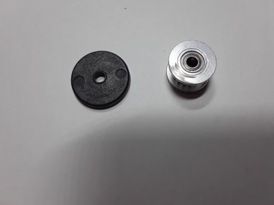

See the wear on both parts.. That's the squeak!!
Two of the three idler pulleys looked like this...

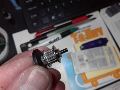

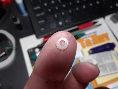

Went to local hardware store and picked up some small nylon washers. Had to take a file to round one of the edges down so it would fit the idler pulley bearing better. Then assembled it back up by tightening till it just becomes tight. Then I backed off a half turn. Worked out great. The small circle end stop is at the very end but doesn't seen to be a problem.
Nylon washer that has been filed...
You should be able to see how I filed one side of washer....
Assembled idler pulley assembly...
You should also be able to see that the small bearing was loose and had come out of it's location in the idler pulley. Was not a big deal to fix, still a little to loose for me which makes this fix worth the effort. Hope this helps anyone with a squeaky Artemis...

Hi Bones056 - I had the same squeaking issue and it nearly drove me out of my gourd! My coworkers would come into my office and ask me if I was torturing a kitten, which was especially painful as I bought my Artemis in part to be very quiet in an office environment. I was so annoyed with the thing that I couldn't stand to print anything on it and actually considered selling it.
I started off with similar troubleshooting steps - lubricating the linear rails, regreasing the ball joints, etc. Nothing helped or made any difference at all. When this squeak occurs, it's very difficult to pin down because it causes the entire axis structure to vibrate; it sounds like it is coming from everywhere. I finally isolated mine to the X axis by pressing my ear against each axis as the printer was running, and from there narrowed it down to my idler pulley just like yours. I discovered the location by pressing on the retention washer that holds the pulley in place - I found that I could get the noise to change in character and intensity by pressing on it. Bingo. In my case, I don't think the screw attaching the pulley was ever properly installed at the factory because I could rotate it indefinitely without it ever getting any tighter, indicating that it wasn't engaging with the nut I surmised must be on the other side. Sure enough, I removed the entire pulley structure at the bottom of the rail, and the nut just fell out when I did. I reinstalled it in its capture pocket, lubed up the idler with some teflon grease, and put the whole thing back together. I'm delighted to report that I'm now back to beautiful, stealthy ninja silence when printing. I actually thought of the same washer solution you implemented (although I was considering Teflon washers) and was going to try that as a next step, but was very happy to find that simply assembling the thing properly eliminated the noise.
My idler had an asymmetrical wear pattern like yours (see pic). In my case, it seems clear that because the screw wasn't tightened, it sat in the hole at some small angle because it was under constant tension from the belt, and that caused the high spot of the pulley to rub against the plastic end cap.
I hope your experience and mine will be useful to anyone else who suffers from this maddening problem. To anyone assembling the kit - these pulleys are already installed when you get the kit, so you won't catch the problem in your build unless you experience this same noise or go check all the idlers.

I thought I could get away with some lub only... Squeak came back so I opted for the nylon spacers.. Had to work on them to fit the bearing so I could tighten without locking the Idler up. Haven't had the squeak since I did the mod. Might just print me some replacements as the nylon washers are a little thick. But hey... these are still working.

I'll add this for anyone else who is facing this issue. When I complained about this to SeeMeCNC, Steve sent me some new idler pulleys which he said were of better quality than the originally shipped ones. I tried replacing them, but as you can see from the picture (newer one is on the left) they're considerably larger along the axis of rotation. I got one of them installed, but the belt was then misaligned and produced a rubbing noise that was almost as irritating as the original squeak (plus I'm sure it would have resulted in premature belt wear). I removed it and reinstalled the original.
