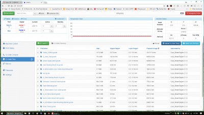

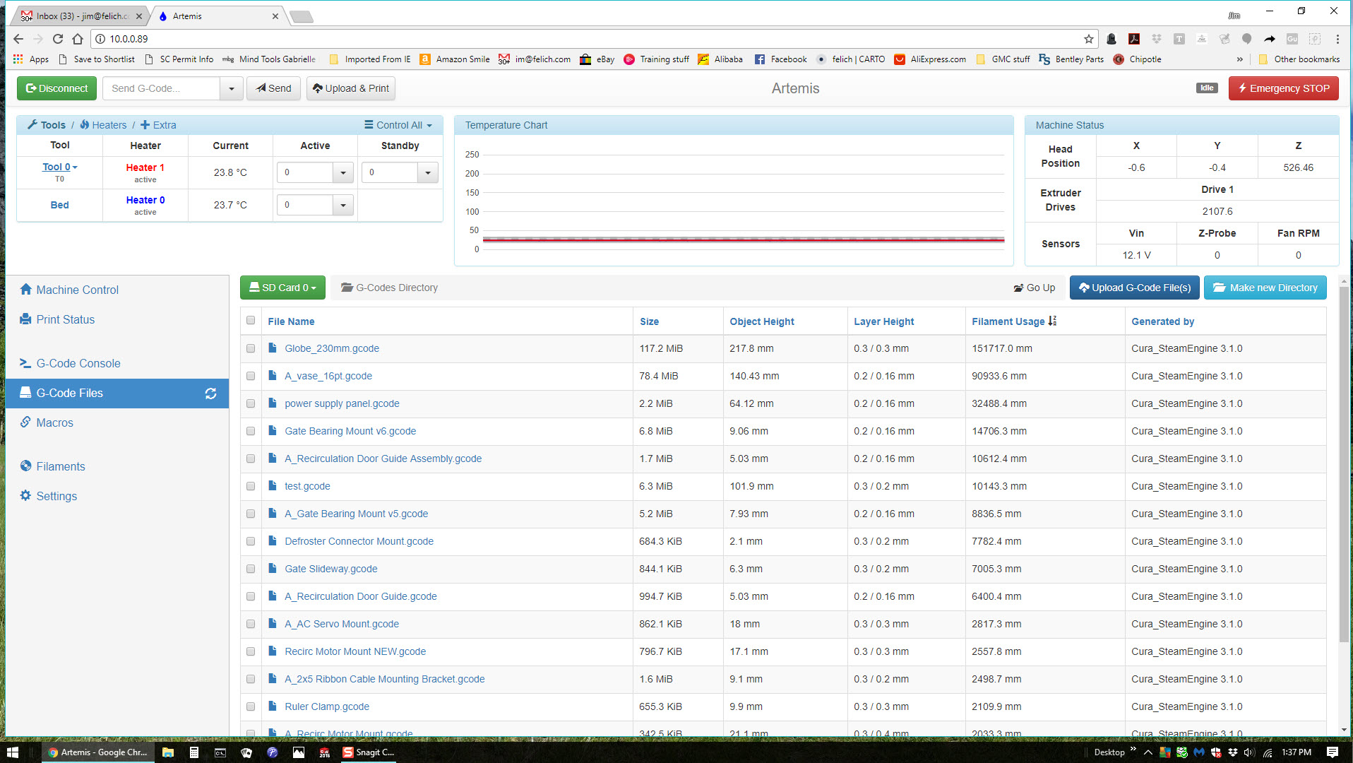

Duet Web Control does include the file date in the GCode file listing, and the most recent few versions allow you to sort the file list by date. If you are viewing the list on a smartphone then you might need to scroll the display (horizontally?) to see the date.
Re: Artemis Browser Interface
I don't see it. Please point it out.
- Posts: 1561
It looks like SeemeCNC may be using an older version of Duet web control. It's at least before 1.20, given the limit of 6 extruders was increased to nine for the Duet wifi then. If you were to update your Duet firmware, as well as Duet web control, such a column was released in 1.19a, released in september 2017. So check your DWC and RRF version numbers, and update appropriately. For reference, DWC current is 1.21, released march 21, 2018.
