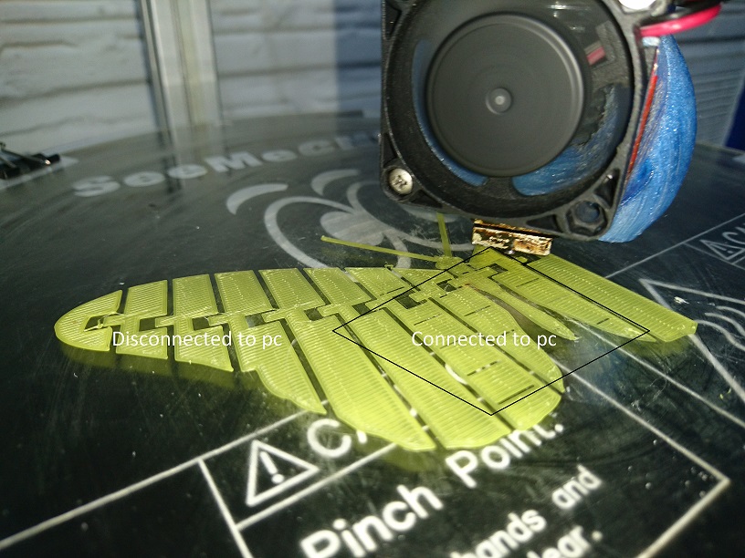

Hello everyone.
I want to know if this happens to someone else in MatterControl.
this happens to me with MKS 1.4 board and Rambo in Repetier or marlin.

I used the printer with a better PC and it did not show the error.

I suspect that one of the controllers (USB, USB to serial, etc), has a finite buffer, and at times it was filling up and dropping lines, or an intermittent connection issue caused it to drop the lines of code. It would explain why a better computer wouldn't have the issue, as they have more fully featured USB controllers, which are more compatible.

I reinstall windows 10 and reduce Error:Line
