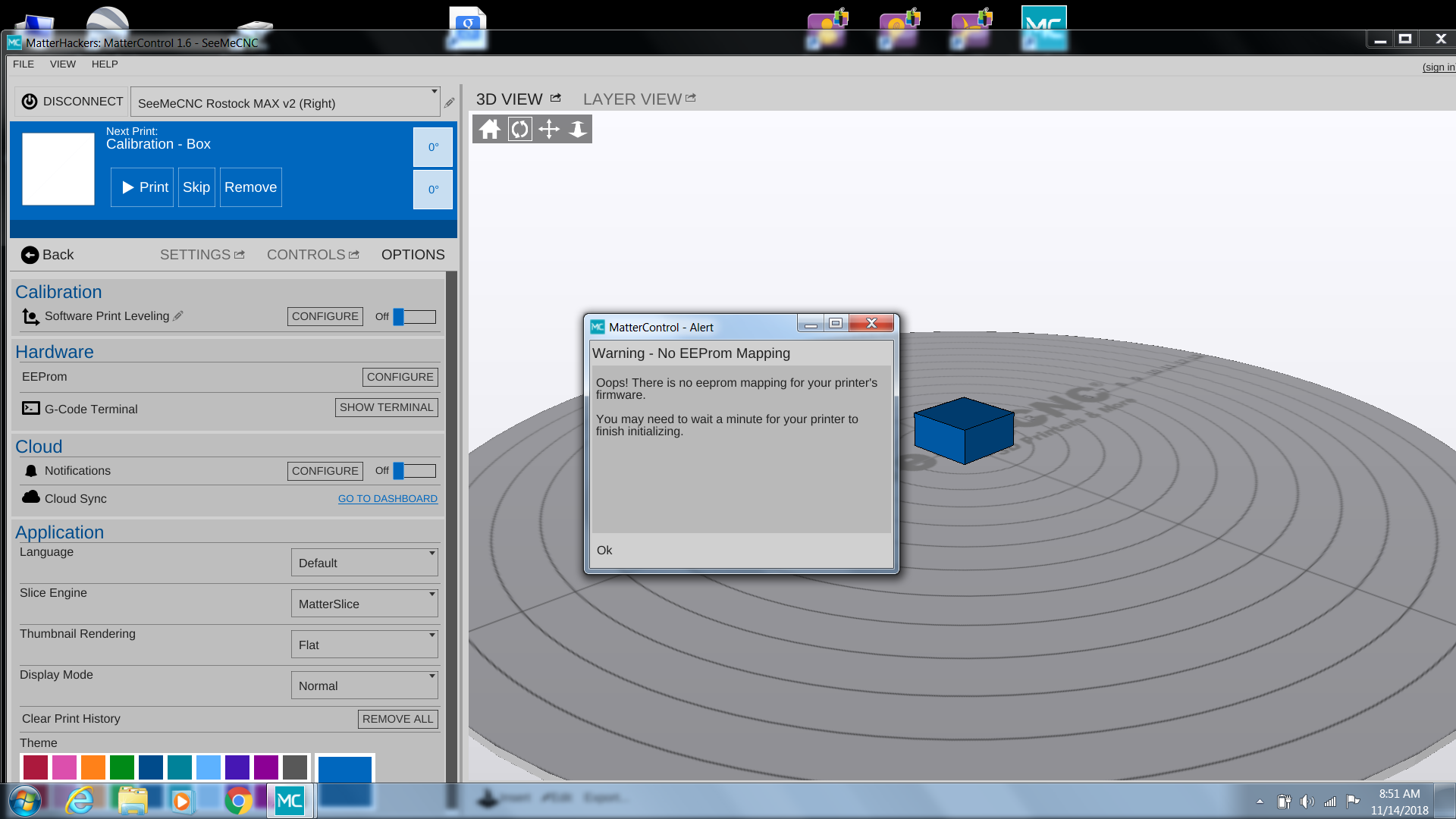

EEPROM isn't largely about connections. It's storing configuration information (In your case, Z height, is what we care about), which while it includes the connection settings, is mostly printer calibration data. Try options, EEPROM settings. You may want to use Show Terminal first, so that you can get a copy/pastable dump for us here on the forums.
Re: Stop during Calibration
This is what I have when I go into MatterControl Options, Eprom Configure. See attached image
