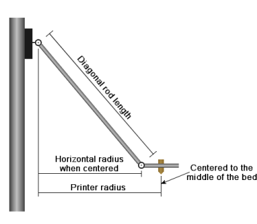

I adapted previous infographic a bit, maybe that clears up some things:
Like a Christmas bauble hanging on a thread, when moved horizontally it will describe a circular path with the fixed other end of the thread as a centerpoint. Delta kinematics is a bit more complicated than that, but following the same principle.
If you have your diagonal rod set to long, the head moves along the upper red plane because the real rod length is shorter than what the firmware thinks it is. The other way around gives you a plane following the lower red line.Obviously we want to go for the green line as much as possible, therefore the rod length in firmware must be as close to the real thing as possible. All this counts if we leave out any possible error in the bed itself (of which we know that not all beds are as flat as we hoped for!)
The diagonal rod length is the ONLY value that has significance to planarity of the head movement. So YES you will have to adapt your rod-length again. Also the rods need to be of exact the same length as possible, because there is no compensation possible for unequal rod-lengths (every effort to do so will lead to multiple of those red lines in different angles of the bed).
Endstop calibration mainly has influence on the carriages being in the same plane after homing, what in turn defines the position of the nozzle to the bed on X0 Y0 position. Sometimes you see the nozzle off-centering a bit after a homing. That is an indication of not well calibrated endstopscrews. You can have almost zeroed endstop values in your firmware if you calibrated the mechanical endstop screws well, and you should aim for that.
