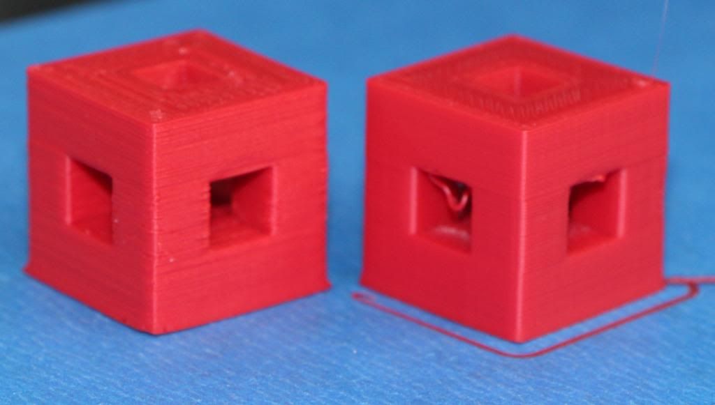

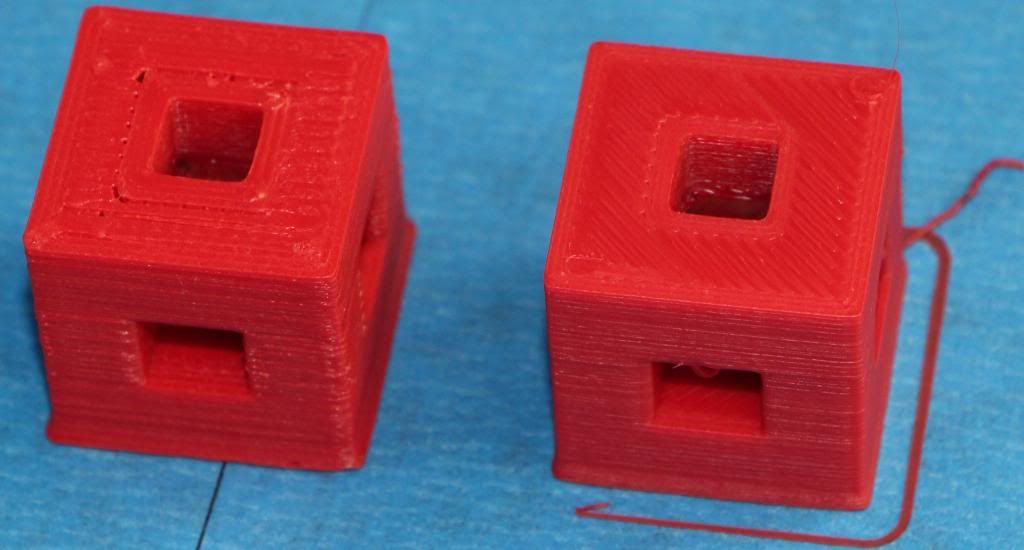

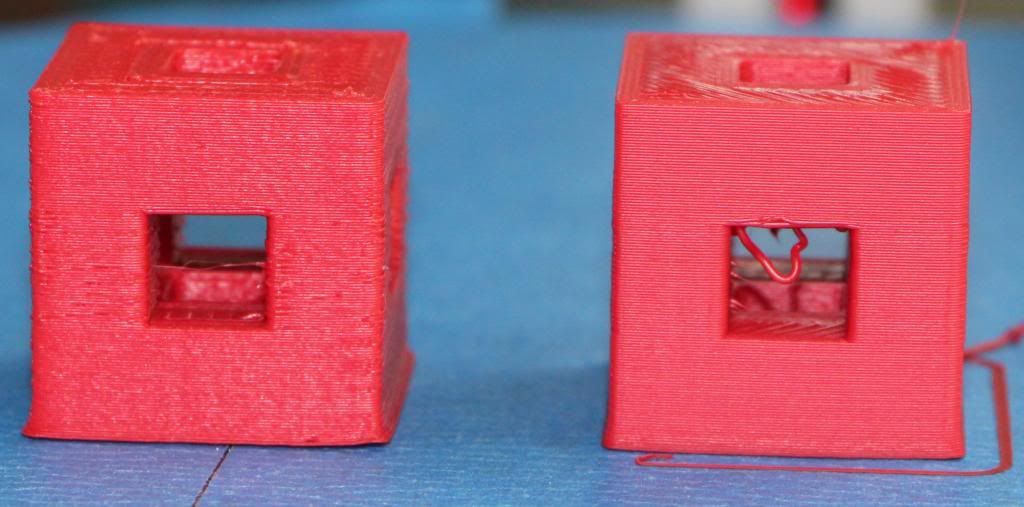

After adjusting my mechanical set-up based on geneb reccomendations, little to no friction in ujoints and arms. I printed the calibration cube using Slic3r. It still had some gaps on the last layer. So I tried Kisslicer using mhackney's setting he posted in his build blog. Only change I made to the config was 3 loops, .2 layers and a "G28" home command on start. Attached you will find the comparison images. The left part is Slic3r the right is Kisslicer.
The only issues I saw on the Kisslicer print was some bridging issues (expected as it did a 45 path not a straight path across the gaps). Also when printing in Kisslicer I did notice that when it was extruding there was less "popping/crackling" coming from the hot end, almost non-existent. All prints have been ABS at 230C. The Kisslicer print was at a slightly slower speed than the Slicer print.
I also want to add a horizontal move at the end before moving to home as the printer left a long string off the part.

KissSlicer by default prints perimeters outside to in which results in the cleaner outside.
The week point for KissSlicer is IMO bridging, it doesn't identify them and it fills bridges the same as it fills everything else. I resort to support for anything that would require a significant bridge.
But generally the difference between the prints you show is typical IMO.

In my limited experience I will agree that bridging is an issue and supports are required.
However, mine did print the inside perimeters first before the outside of the part. Confirmed it just now with my current print. I think the smoothness is a combination of me gaining experience and a slower feed rate. Up until the Kisslicer print I heard crackling/popping coming from the extruder regularly. Didn't know what it was but I suspect it was that I was printing a little too quick and was getting small blockages in my hot end. There were minuscule gaps in the printed thread. Now no crackling/popping and no gaps.
I do like the tool path better in Kisslicer as it appears to finish an area before crossing a gap. Just more logical. Again limited experience. Just sharing for anyone else new to this like me.

@MorbidSlowBurn, were there a lot of retracts in the Slic3r print? I hear that popping right after rapid retracts.
I also discovered that the beta KISS does not do the outside-in perimeters by default. I had to uncheck that little box.

Mhackney- yes there were a lot of retracts. And thinking back I was aggressive with my retract setting it probably was "sucking air" which could cause the pops.
My major trial between the two was to see if the different slicer would fix my last layer internal gaps and it appeared to do that. As you mentioned in my tuning topic-scientific method approach. I just didn't get all the settings the same between the programs. With more tweaks I may be able to get Slic3r to do the same quality but being new I am trying to find the least "painful" method of getting good prints.
