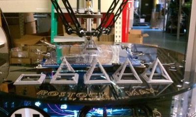

Hey Everyone,
My my Rostock Max kit is in the mail...yahoo! I've built many repraps and have even designed my own printer (behemoth http://xnaron.com). I'm looking forward to getting my romax up and running as soon as it arrives. I printed out a Hollow Calibration Pyramid on my behemoth to help me tune the romax.
Has anyone out there printed this --> http://www.thingiverse.com/thing:8757 with the Rostock Max in PLA? I'm attaching my pics of the one I printed on the Behemoth. I'm hoping to print one as good or better on my new Rostock Max.
So I throw this challenge out there to all you existing Rostock Max owners... lets see your Pyramids!
I'm hoping to see some awesome results and get some good tuning tips! I can't wait to get my kit and get it up and running. Kudos to the SeeMeCNC crew for putting such a nice Rostock kit out there!
BTW my picture is right after the print with NO cleanup...please post your photos raw off the printer.
thanks,
Brendin

The picture was from the reprap wiki ( http://reprap.org/wiki/Rostock_MAX )... here is the text for the settings used:jesse wrote:Could someone post the slicer settings to print that out on the Rostock Max?
The following settings were used to calibrate retraction on the hollower pyramid thing at http://www.thingiverse.com/thing:29429. Filament used was Makerbot 1.75mm Silver ABS. Use these settings for a good general baseline for printing. You can increase the print speed, but you may need to increase hotend temps as you increase speed above 40mm/sec. 235C+ is looking to print well at 35mm/sec speeds
.3 layer height
2 perimeters
0% infill (hollow)
30mm/sec speeds for everything except for external perimeters at 80%
200mm/sec travel speed
228C extruder temp
slow down if print time is below 25 seconds
minimum print speed set to 6mm/sec
10mm retraction @ 55mm/sec retraction speed
0 Z lift
0 extra length on restart
3mm minimum travel after retraction
This was done in ABS. I want to print in PLA. I know I need to add fans to the Rostock Max to print in PLA and I'm ready to do that.

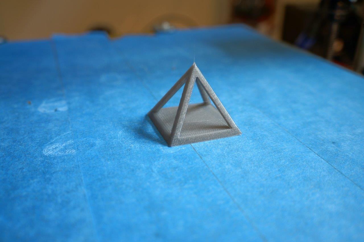

Re: Rostock Max Hollow Calibration Pyramid Challenge!
In preparation for my Rostock Max tuning I have been tweaking os1r1s's mm2 KISS settings for use on my behemoth. I printed out the pyramid again to use as a reference. I am planning on using KISS slicer with the Rostock Max. Picture attached.
That looks great. I tried to print that in abs. What a failure. More work to do. Waiting to see what you can do with the max.

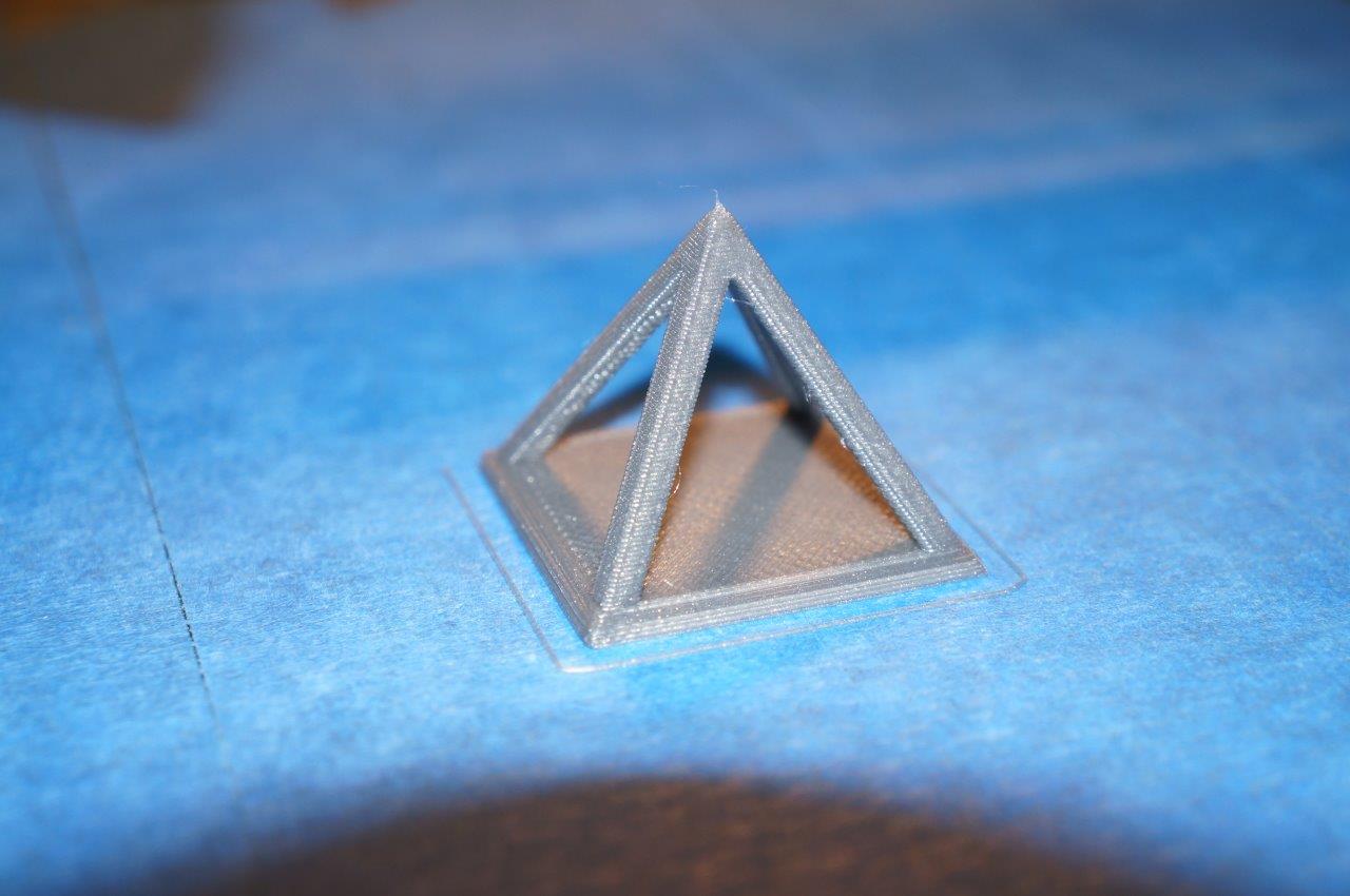

Well, I managed to print the cal pyramid last night. It is also my very first print to come off my printer ever so I am overall very happy with it.
I am using a hotend made up of my old melted hot end while I wait for my new one to arrive. So I suppose this is my first successful print with my home made all metal hotend as well.
Any tips on improvements that can be observed from the pic are of course very welcomed.
I used Slicer from within repetier host. I believe the firmware was marlin.
Print was completed in a hair under 50mins
It is printed in ABS

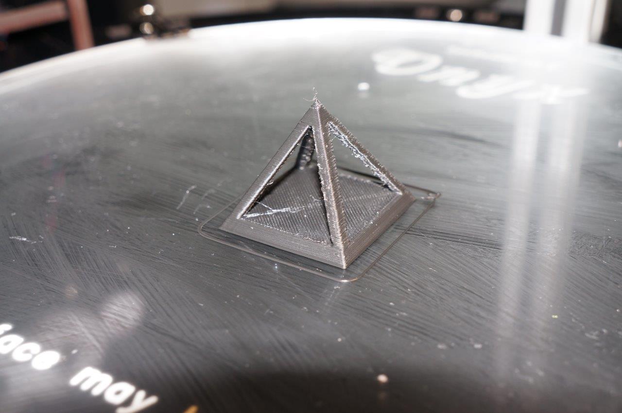

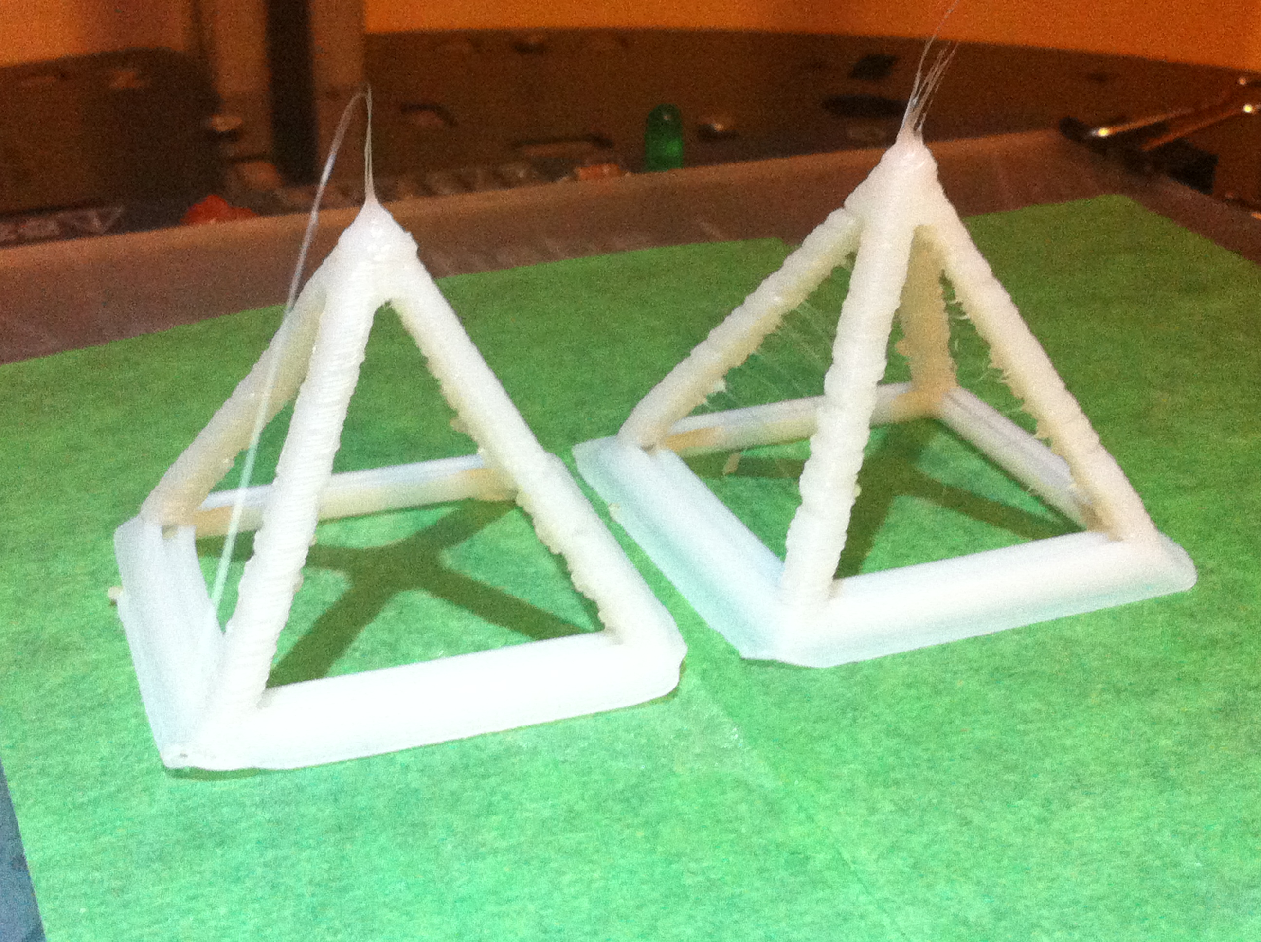

OK I've been having trouble with squashing but I tried this and used mostly the settings on the link just a bit back and with
0.3 layer height
0.4 first layer height
2 perimeters
0 fill
0.9 Extrusion Multiplier
220 degrees Hotend 70 Bed
9 retraction
0 lift
50% speed on the speed multiplier slider
70 Travel speed
The Right one with hairs in it, I increased retraction to 10 and travel speed to 90 from 50 in the first one, and Printed at 70% on the speed multiplier instead of 50% on the Left one
Still not nearly good enough for what I need but getting there
0.3 layer height
2 perimeters
0 fill
9 retraction
0 lift
70 Travel speed

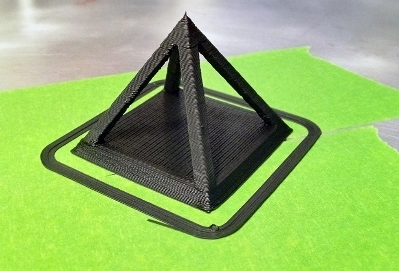

Hey Guys!
Its taken many attempts but here is where I'm at now. Printed with black PLA.
- 0.25mm layer
- 0.35mm nozzle / 188C
- KISS Slicer
Even though I have calibrated my filament I think I am still a tiny but heavy.
Brendin
- 0.25mm layer
- KISS Slicer
Brendin
