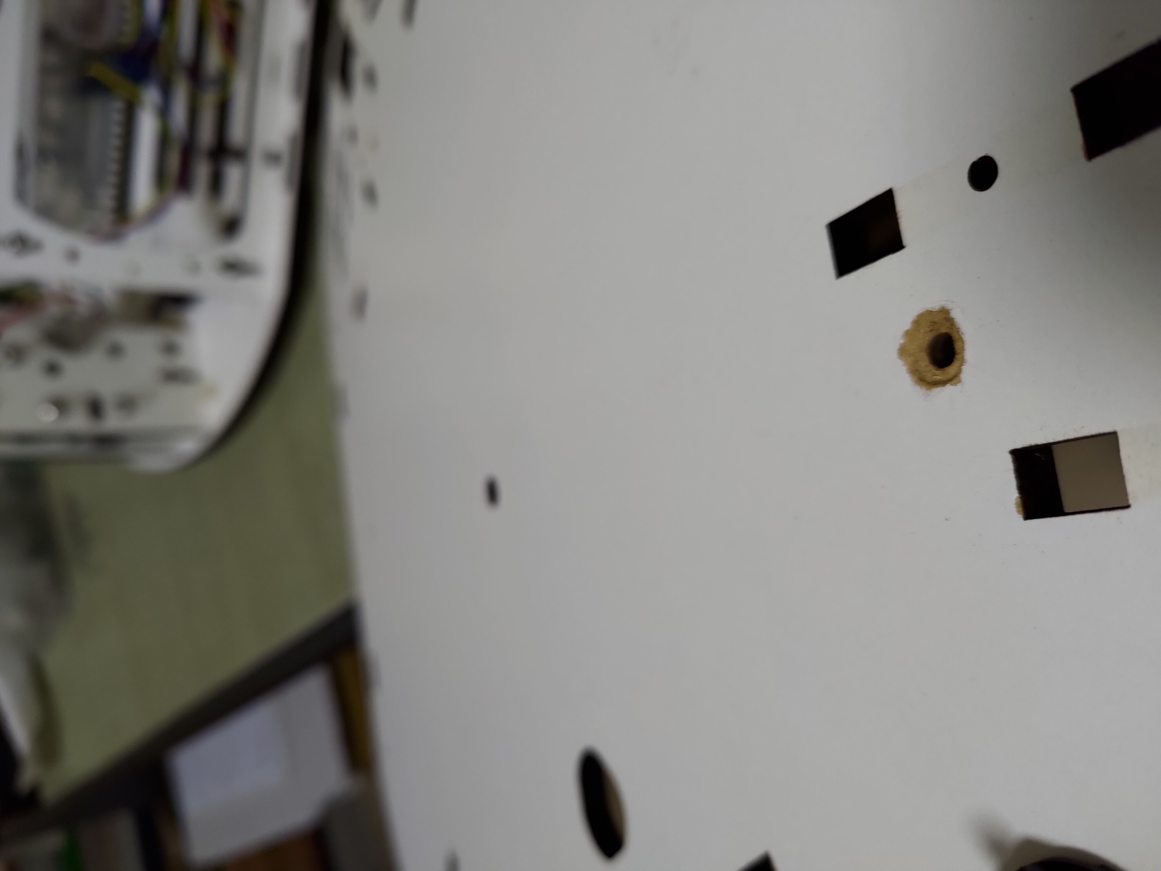

Hi guys,
Recently I got to work fixing my v2 and wasn't too careful when install the base top plate when i got engaged in an all out war with the t nut which just wouldn't let go
In hindsight I should've just taken the entire plate out before trying to unscrew the heated bed but well it's done.. what are my options here? Can I epoxy the t nut to the base plate? Or just get a new sheet?
Re: T nut dug into the base top plate - what are my options?
You can use epoxy if you're very careful to keep it straight and keep it out of the threads.
