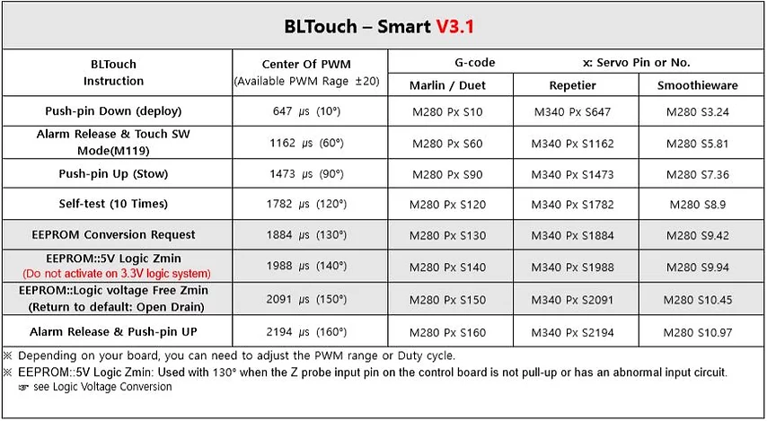

I added a bltouch v3.1 to the Smoothieboard and have the process working. However, it does not level the bed.
Code: Select all
G28; #home to max endstops
M280 S3.24; #deploy the probe
G32; #3-point delta calibration
M500; #save results of 3-point[attachment=0]IMG_6681.JPG[/attachment]
G31; #delta grid probing
M374; #save results of delta grid
M280 S7.36; #retract the probe

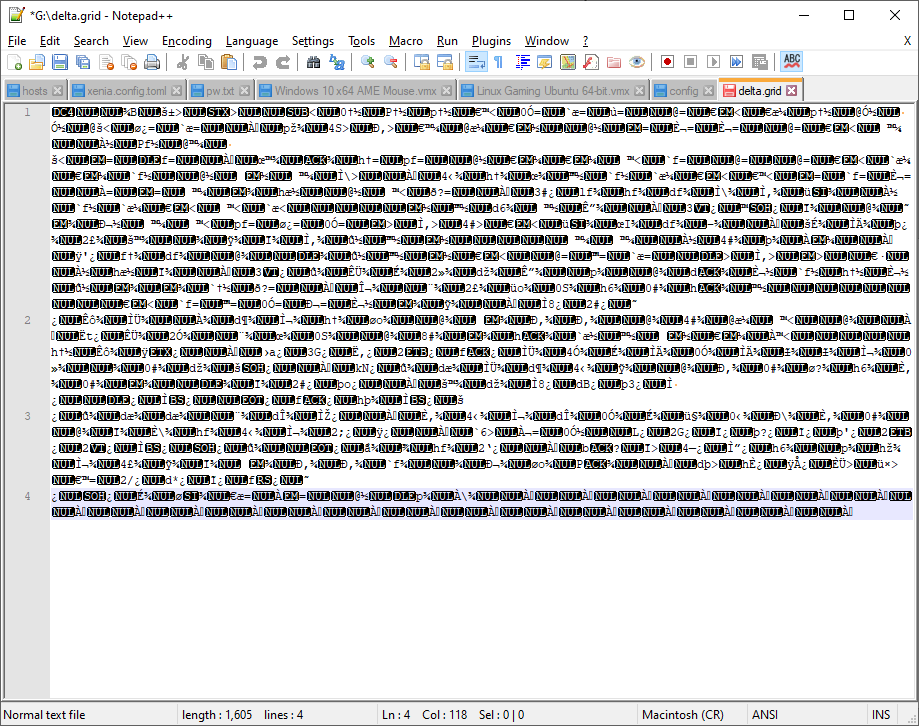

I was able to get to the delta leveling grid that saved the SD card.
Unfortunately it's in a serial binary format and I don't have the layout. If I can decode/encode the table, I might be able to put my own measurements to correct for the high/low spots.

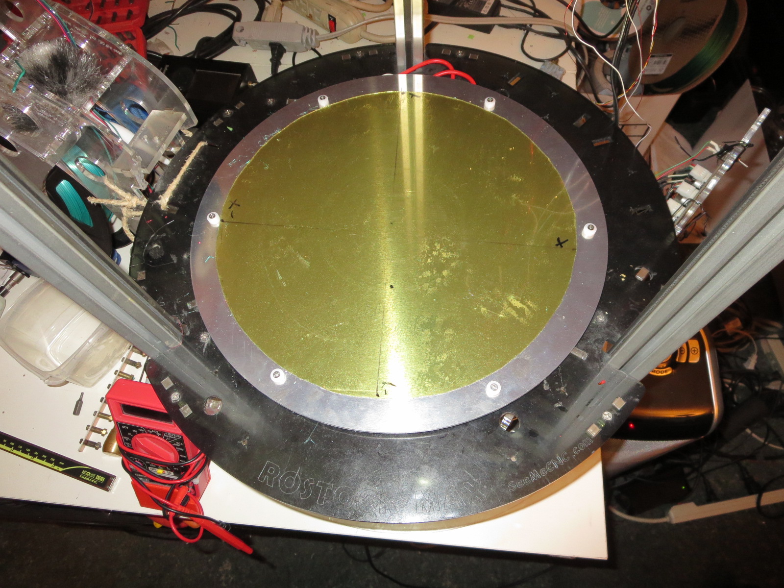

I think the autocalibration is needed because my bed is not flat.
I replaced the original MDF wooden fractal star with a solid disc of aluminum, thinking that it would help.
Maybe the acrylic has sagged over time or the aluminum disc is a little raised in the middle.

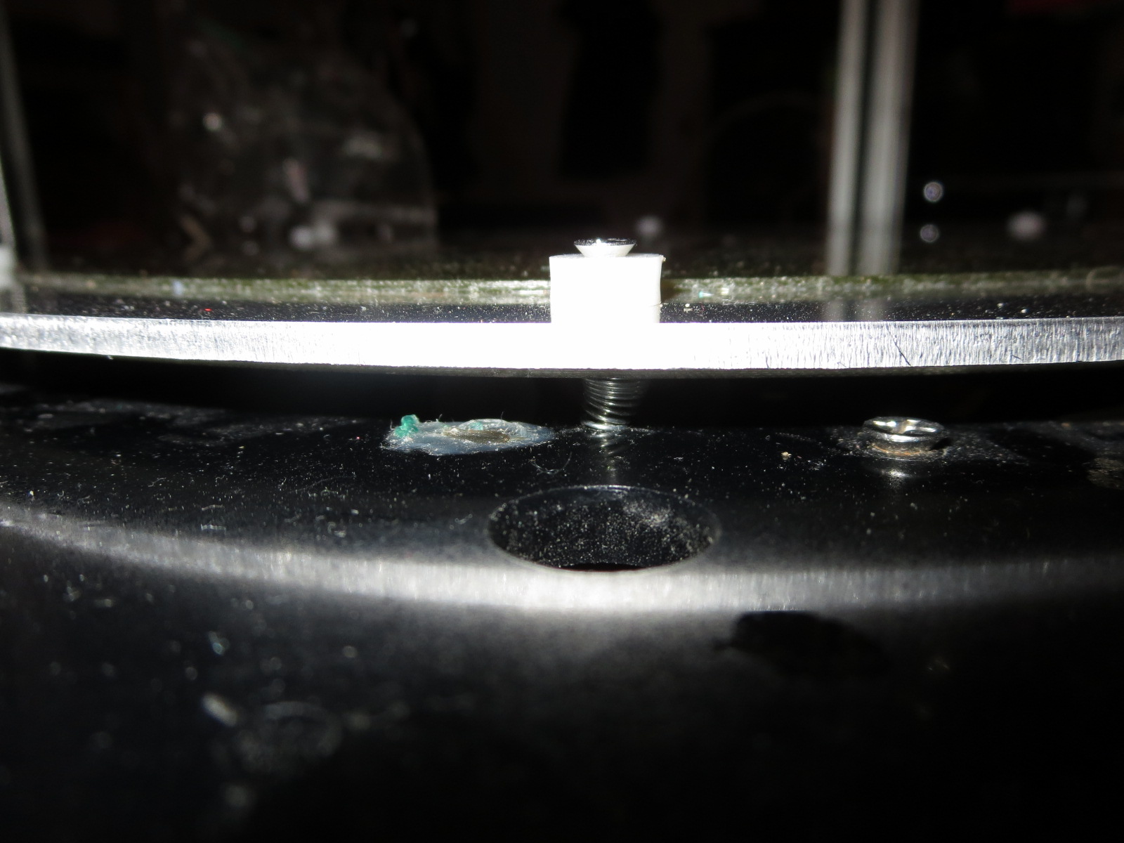

I put springs under each of the 6 mounting points and that helped enough for 0.5mm layers but not for 0.25mm layers.
Steve from SeeMeCNC sent me a few links to buy the parts to fix the looseness in the arms which will cost about $100 + shipping.

I suspect those springs are your problem. Even the Rostock MAX v0 didn't use springs under the bed - it was nylon spacers.
