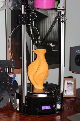

Vallick, yours is a valid question. Please keep in mind that the people who post in this forum greatly overrepresent two groups. Those who can't get their printers to work come here to get help. Those who can't stop tinkering with their printers come here to discuss their tinkering.
I started getting reasonable prints out of my printer within a couple of days of finishing assembly. I couldn't use the whole bed area, and since I'm one of the tinkerers (see my build log if you don't believe me (-: ), I nearly rebuilt the whole printer to learn what i could do to optimize it.
Right now I have a 99.3% stock printer. My mods are limited to: better power switch, better power supply, some silicone tape around the hot end, and a fan shroud around the cold end. I can use the whole bed. I can use the whole volume. Here is a PrettyTron 7000 scaled by 280% that I printed a couple of days ago. It took a little over seven hours. It's 332 mm tall, 264 mm wide. (13.07 by 10.38 inches)
I sure don't want to see the UglyTron!
You are correct that buying a Rostock MAX is risky. It might not work. It might work but not meet your expectations. It might sidetrack you from printing useful widgets into a new hobby of playing with your printer. (That last bit happened to me.) If you're looking to get some widgets printed and completely uninterested in learning about printers, this is not your printer.
