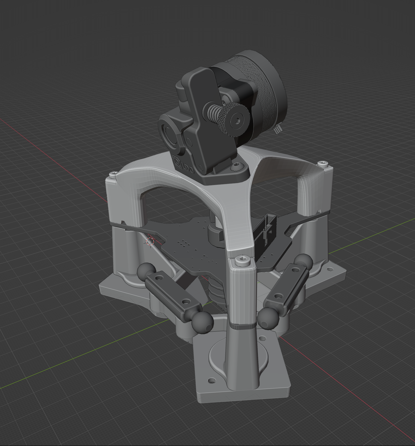

Posting this here because it seems like the mods subforum is dead and I did make this :D Admins feel free to move please!

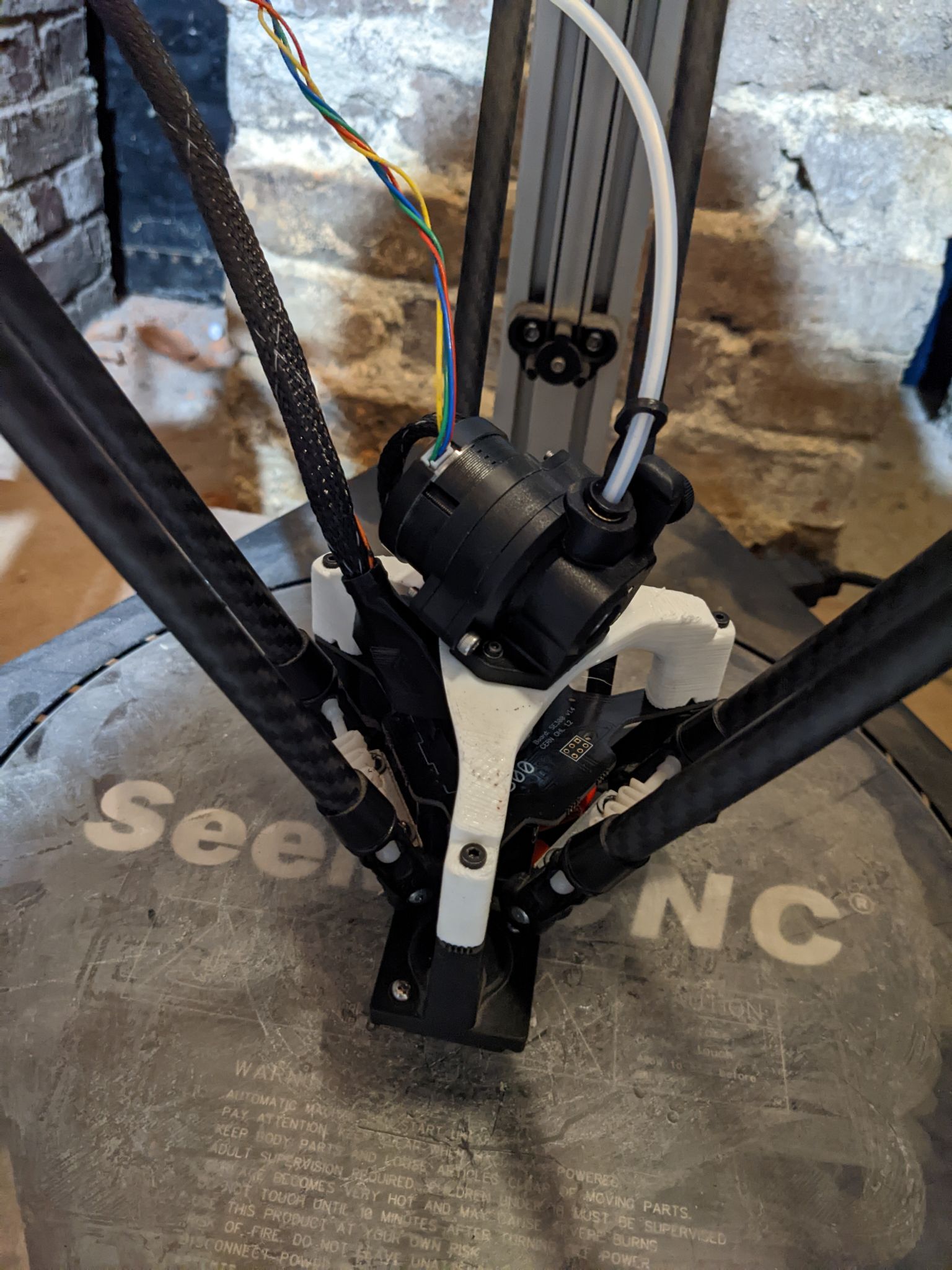

I've been struggling with my Artemis's print speed ever since I got it. No matter what I did I couldn't get it past 20 mm/s.
Now with the Orbiter V2 attached to it I'm able to get up to 40, even 60 mm/s; the machine is no longer the limit, only the material is (at 60 it tends not to solidify in time and get dragged around).
With a 1mm nozzle (.8mm layer height), Volcano hotend and this extruder, a 5.5" tall by 8"x8" part only takes 3 hours to print at 40 mm/sec!
The cable gets run up through the vents on the underside of the compute unit at the top of the printer. If anyone wants to try this and has specific questions please let me know!
I'm also attaching the file and McMaster parts if you'd like to do this yourself.

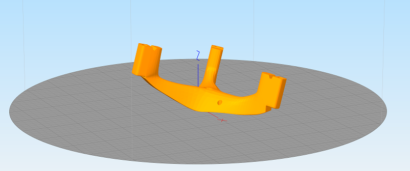

I printed it in this orientation:
