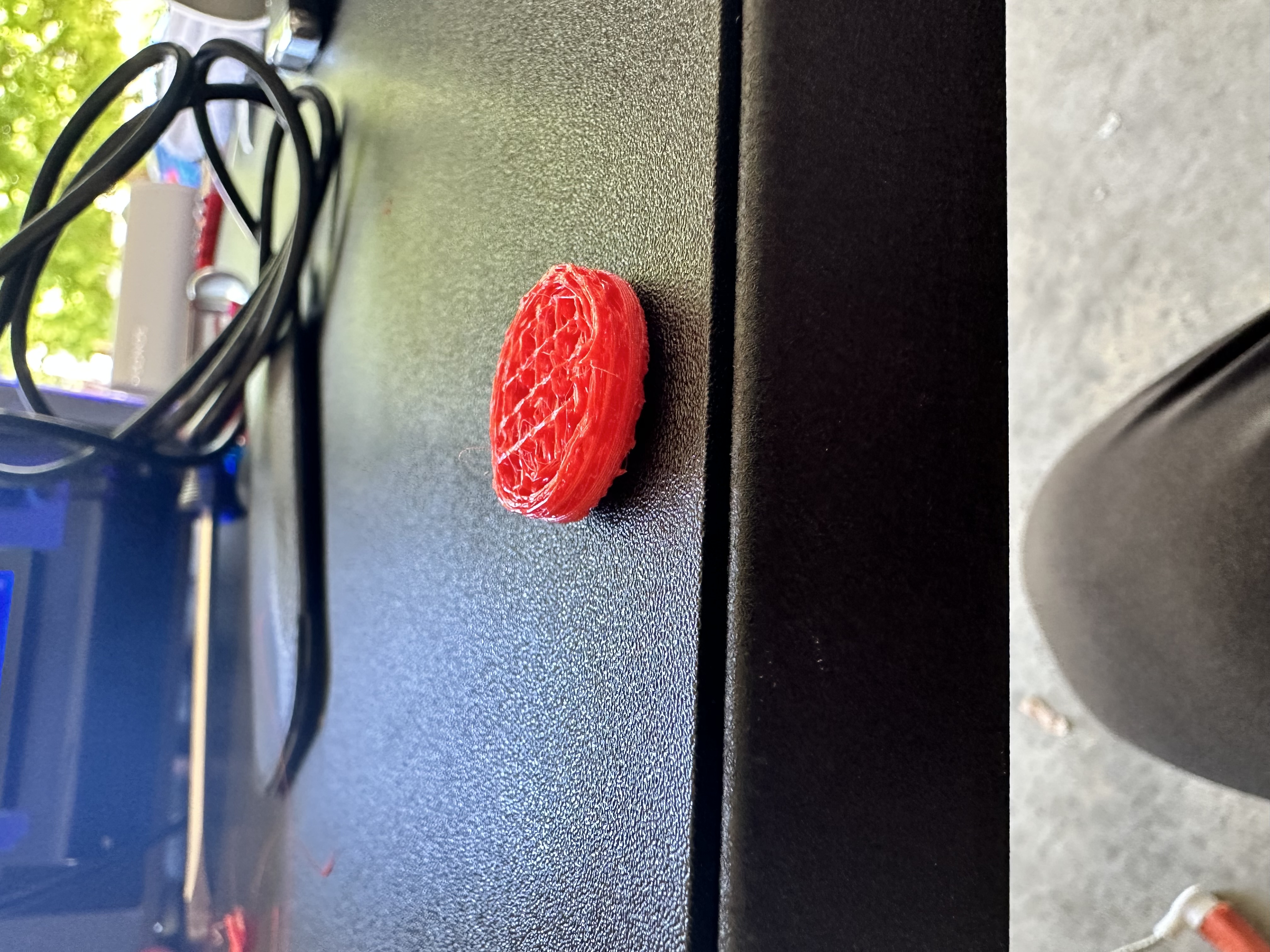

Getting closer on dialing this in. First few layers are pretty good but then it all starts to fall apart as it moves up in the print. Any setting recommendations for something like this? This is just a cylinder test print.
- IMG_2799.jpeg (2.57 MiB) Viewed 58338 times
Re: Orion HE280 upgrade poor print quality
It almost looks like wild temperature swings as the print height gets taller. Watch the temperature display on the front panel to see if it changes a lot. You might have an intermittent connection to the heater that is effected by the print height.
You might also try printing a 100mm circle about 3mm tall to see how that goes.

I finally figured it out. My hobbed drive roller on my EZR struder was not aligned correctly on the motor pin. Makes sense being the filament was not flowing smoothly through the struder and causing my wacky prints. Thanks for all of your assistance, Gene, much appreciated!!
