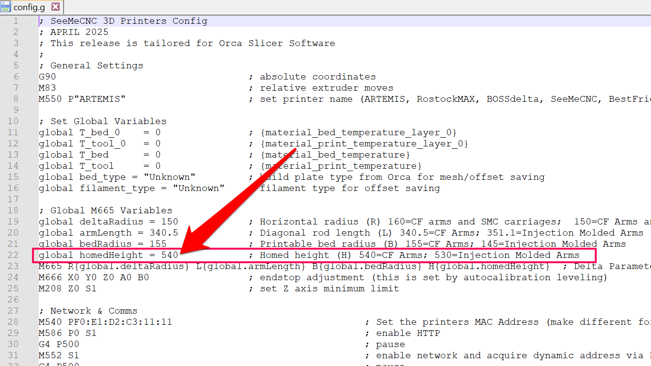

Here's the firmware on the SeeMeCNC github. Any SeeMeCNC Duet2 controlled printer will work with the ARTEMIS firmware files. The Artemis firmware files are the only files I will be updating. BOSSdelta, RostockMAX v4, etc., users need to open the config.g and edit the printer height for their machine.
SeeMeCNC Github New Firmware
The following picture shows where to change the height, the printer radius, and other settings that need to match your printer model & arms (molded or carbon fiber).

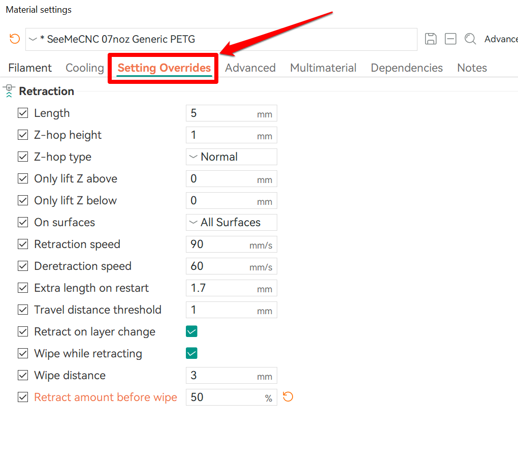

I'm open to all input and suggestions and shares 3MF Orca project files to try. Be sure to include any notes if you change the acceleration, instantaneous speed change (aka jerk), or other config.g settings in the firmware. I don't feel they need changed because Orca Slicer controls everything, including Pressure Advance.
My approach to Orca Slicer: Get one nozzle size and one filament type working acceptably.
Orca Slicer is very well done in my opinion. It can be used several different ways. Here's some things to know about how I decided to use settings.
There are three main sections for settings in Orca Slicer:
> printer
> filament
> process/object
Once I upload my machine & process settings, you'll be able to get a decent print (I'm still have some error getting "SeeMeCNC Generic" Filaments to show up when selecting our printer).
There's a number of settings dealing with the seam. The accelerations and Instant Speed Change (jerk), as well as wipe, retract before wipe (or not).

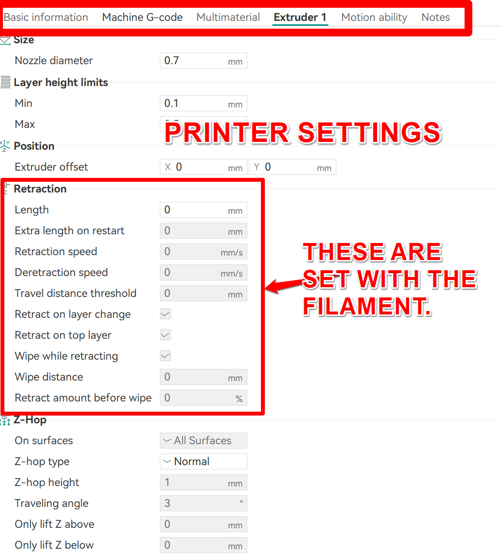

Pressure Advance DOES NOT BELONG in the firmware config.g. This is because different filament types & nozzle sizes have different compressibility (hysteresis) and require different values for each combination. We can have the same roll of PETG and change from a 0.4 nozzle having 1.2 pressure advance to a 0.7 nozzle which requires about 0.5 pressure advance. It was just this morning, I decided to zero "printer settings" and stick with all of the setting overrides for the filament and nozzle combination. Please give feedback if you have a different idea, just maintain your sanity when trying different things. :)
Printer settings
Filament settings
