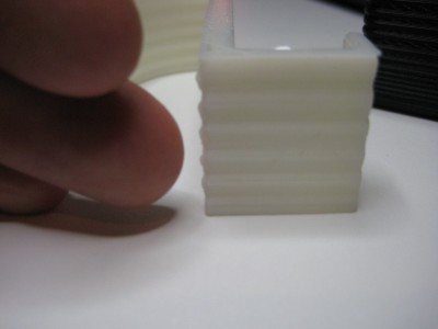

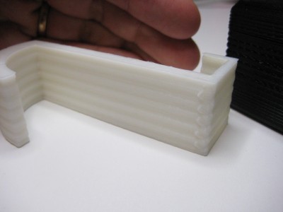

Hi there, my Rostock has been dialed in rather ok. I tried slic3r in the beginning and changed to Kiss later on. I think that Kiss produces better G-Code in most cases. So i modelled and printed a hanger for my bathroom door and it works well. But take a look at its structure. It seems like the layer is oscilating somehow. It is a perfect repeating pattern. Any idea what the reason could be?
Oscillating2
Oscillating2
and
Oscillating1
Oscillating1

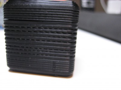

. Now yesterday i played with a different ABS plastic (Black one) and i printed out a box. Yeah i know its not perfect, but again i had some repeating patterns that i coudl not find what to do against but they do look different.
Box
Box
. Also i recognize that in the beginning the extrusion of the filament seems to be "late" and the some layers look like the flow is to low but i print at rather slow speed and the rest of the layers look right. Any ideas?

I am not sure about the oscillation but I'll try to help. What firmware are you running, what board version? Also when you assembled the rostock how loose were the arms and ujoints? Was there play, if only one side is attached can the arm fall straight down with only gravity? Also check your belts for wear/rubbing.
With the filament feed there could be a couple of things. Did you calibrate the feed length of the filament e.g. When you send a 10mm extrude command from repetier host does it take 10mm of filament (measured before entering extruder not after). When you setup your extruder tension did you check to see if when feeding it can still pull filament without slipping if you put resistance on the filament entering the extruder? You also don't want to have so much pressure the filament is crushed going through the extruder.
I just looked at an early calibration cube and it had some slight oscillation (not as severe as your picture) and filament starving. I corrected it by adjusted the extruder pressure.

First of all, thank you for your input. I am in the process of getting better results. Most of the oscillation happend because the ABS plasting was somewhere between 1.55 and 1.65 instead of 1.75 therefore i had some starving in repeating patterns. But one las thing is still not clear to me, right in the beginning it seems to not extrude properly but just the first 1 cm. I sitll try to find the issue. I use the repetier fw. Will report back with some pictures.

This is not soo good and could be (at least a part of) the issue. Mine is between 1.69 and 1.71.

With the morse code like effect on some layers, it would take a LOT more than that variance to see it, the filament is almost certainly slipping in those places.

Thinking about it again I agree, polygonhell. Most likely filament slip. But the 1.55 to 1.65 diameter does equate to a 10% volume difference when extruding. It may not be as pronounced as the first post but may cause some difficult to trace problems such as incomplete fills.

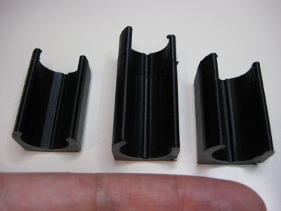

Just some more feedback. After playing a while i can tell you that most of the issue was because the filament size was configured to be 1.75 but in reality it was below 1.6 sometimes. Slipping was not an issue. But now i have some good results. Look at these pictures.
. After printing and No cleanup look at the amazing results.
Inside
Inside
The outside:
. Sure there are now very small blobs put hey its amazing! Seems like the correct diameter was the most important change.
