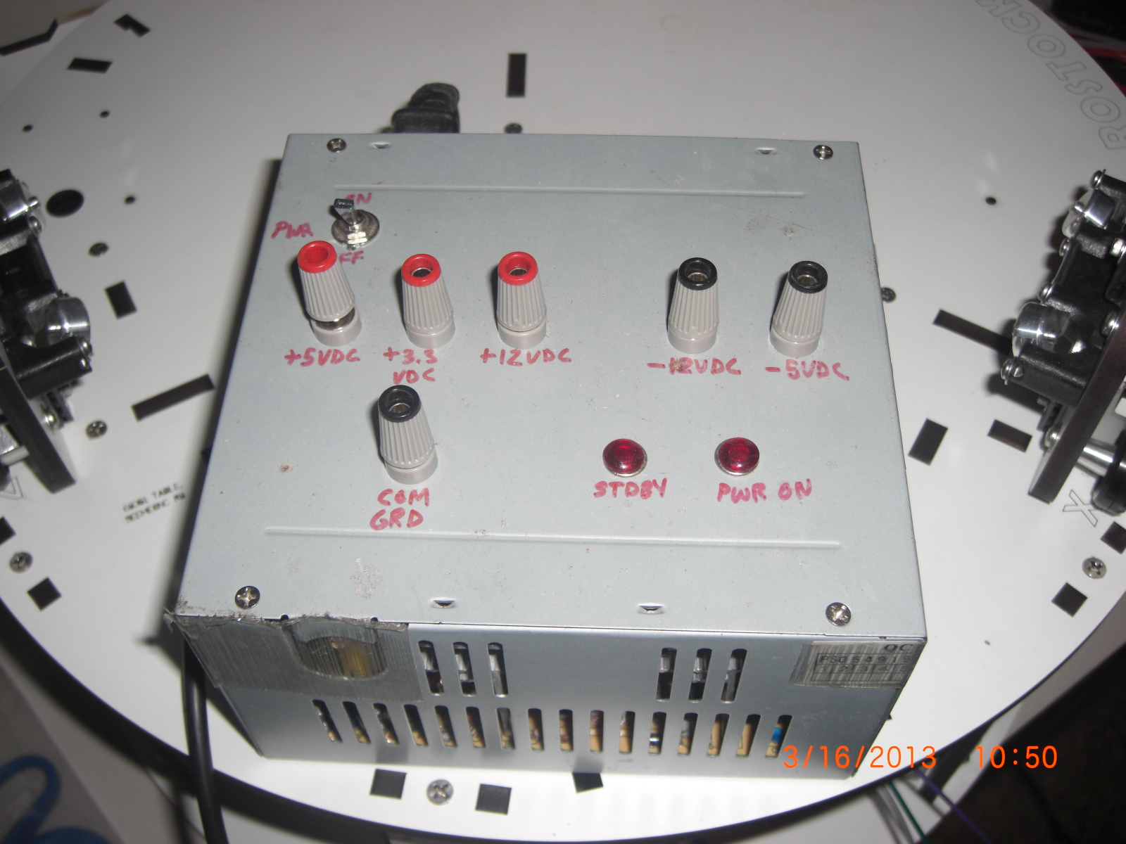

I'm using the gray wire as the positive lead on an led indicator (led comes on when power is switched on) and the purple wire as the positive lead for a standby power indicator.(stays lighted as long as the ac cord is plugged in)aehM_Key wrote:Ok, I'll add this
What about the grey and purple one, which cambo3d let in place: http://forum.seemecnc.com/viewtopic.php ... t=40#p7071 ?
here's an example of one that I modded A while ago for a bench top power supply. Same concept
