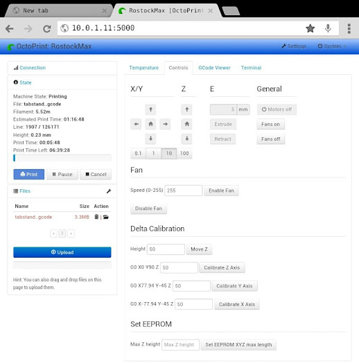

But the feature I like the most is the ability to make customizable controls.
[img]https://lh4.googleusercontent.com/-9D_7 ... ure_01.jpg[/img]
I think I could find some better names for the buttons. But basically that allows you to find the Z=0 for the center and each calibration point. Also, when you find new max Z height you can plug it in and store that value for all three axis in the EEPROM. All of that is so much faster than with repetier host.
