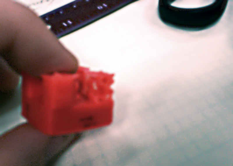

Hurray, happy day, I finally got the calibration cube to print! Okay, it failed of course, but I'm still excited to at least see something 3D! My issue is that I don't have the experience yet to know what problem causes what symptom in the print. That's what I'm hoping you guys can help with. ;)
Mainly the High (and hopefully Medium) issues are what I'm most needing help with.
I've listed everything tho, just in case one issue is related to another.
(Note: When I'm referring to "axis" below that's like the rostock z axis, not the cartesian z axis.)
High priority:
1) The corner post between the z-x axes is severely deformed. (See pic) Strangely the solid corner directly below it looks perfect.
Also, the corner post between the y-z axes is acceptable but has a few pinholes, yet both the posts between the x-y axes are gorgeous as can be!
Medium priority:
2) The side facing the X axis was slightly concaved in. This may be a result of my build platform issue below or it may mean something. I don't know.
3) In-fill goes all the way to the outside wall, but does not touch the inside wall. I'm not sure how to adjust that.
4) The print did pretty well, but when it got to the columns everything rotated counter-clockwise slightly -- about 0.25mm (estimating). The top solid area seemed to rotate back. Is it maybe supposed to look like this or something?
Low priority:
5) Hot end jammed when the print reached the top solid layer. I just need to take it apart and see what happened.
6) I'm having trouble getting prints to stick. I've tried varying temperatures, de-greasing, sanding the glass, adjusting nozzle height. Finally painters tape helped get me this far. I just need to work out my system better.
7) The corners of the print seem to be curled up. Probably due to the last item?
8) Finally, there are a few artifacts between the posts. I probably just need to fiddle with retraction setting or whatever it's called.

On the messed up tower, my best guess is that the printer is slipping on retract/resume (prime/suck), easy way to determine is disable it and see if it still happens.
Probably what happens is after the retract/resume you get filament starvation leading to the effect you see as the layer progresses the filament starts feeding again and you get reasonable towers.
I would strongly recommend you do calibration with retract/resume disabled, it can cause all sorts of issues with the agressive speeds and lengths required by Bowden tubes (and Steve's extruder makes it hard to see them), once you have decent prints minus the stringing print some calibration parts to set up retract/resume, at least then you know what the cause of any new issues is.

I did as directed and overall it did a lot better! :D
Items 2 and 4 are still an issue, but most of the rest were pretty well solved.
Of course, without any retraction the space in between the towers is a ghastly mess. Is there any tutorial or something that describes how to get this feature set up so it works right??
(Also I solved my jamming and edge curling problems but I still haven't found the right magic to make the prints stick reliably.)

Probably insufficient cooling, printing slightly too hot and probably extruding too much filament.
I recommend calibrating with a single wall cube followed by 100% filled cube, I wrote it up in the rostock forum somewhere.
