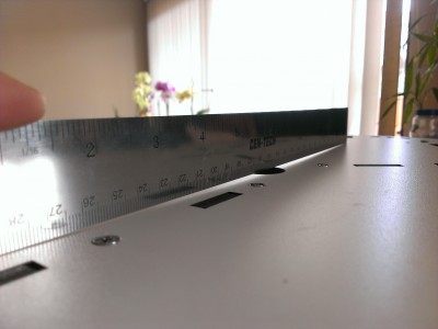

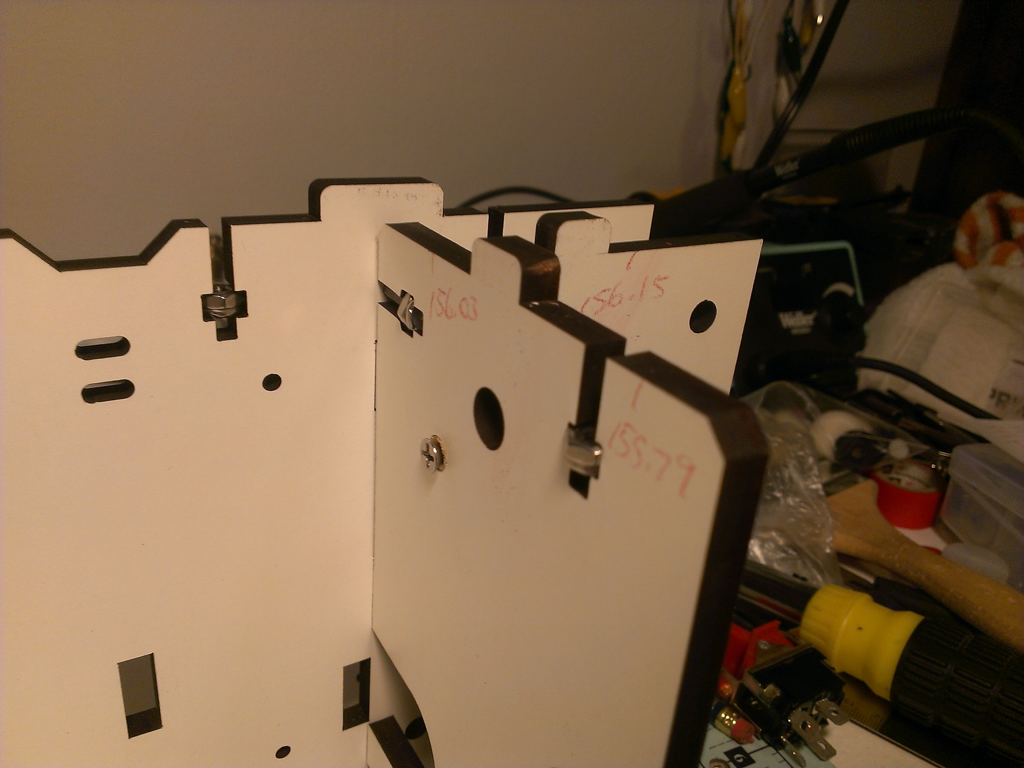

I finally got my Rostock Max kit in and dug into the assembly. Peeling the masking tape wasn't as bad as I thought it'd be. The most annoying thing wasn't so much the tape, but the charred edges. Soot kinda gets all over your hands and clothes.
Then I found that I'm missing the nylon nuts that hold the feet to the bottom plate. I emailed support and hopefully Seemecnc will send some to me.

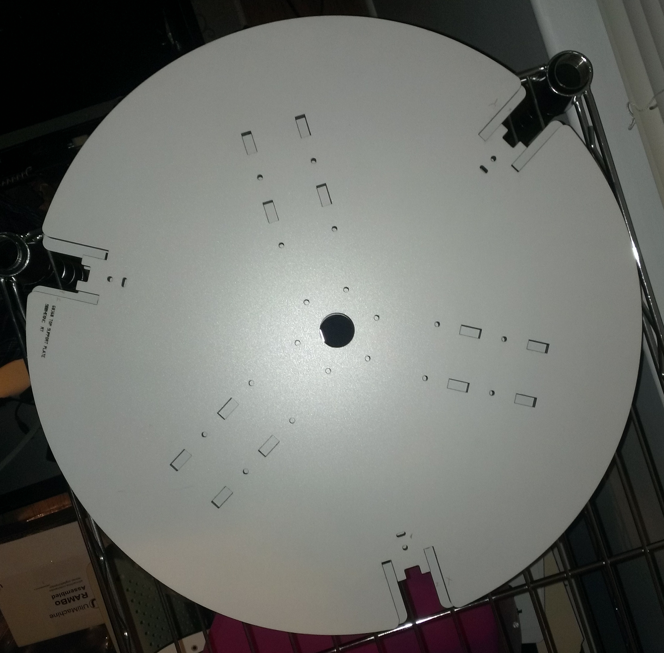

I put the base all together and I did have to file down the nut slots on a few spots. But after putting the top part of the base on, I noticed that it wasn't flat. I think I'm having the same issue as Cambo3d. Take a look at the pictures.

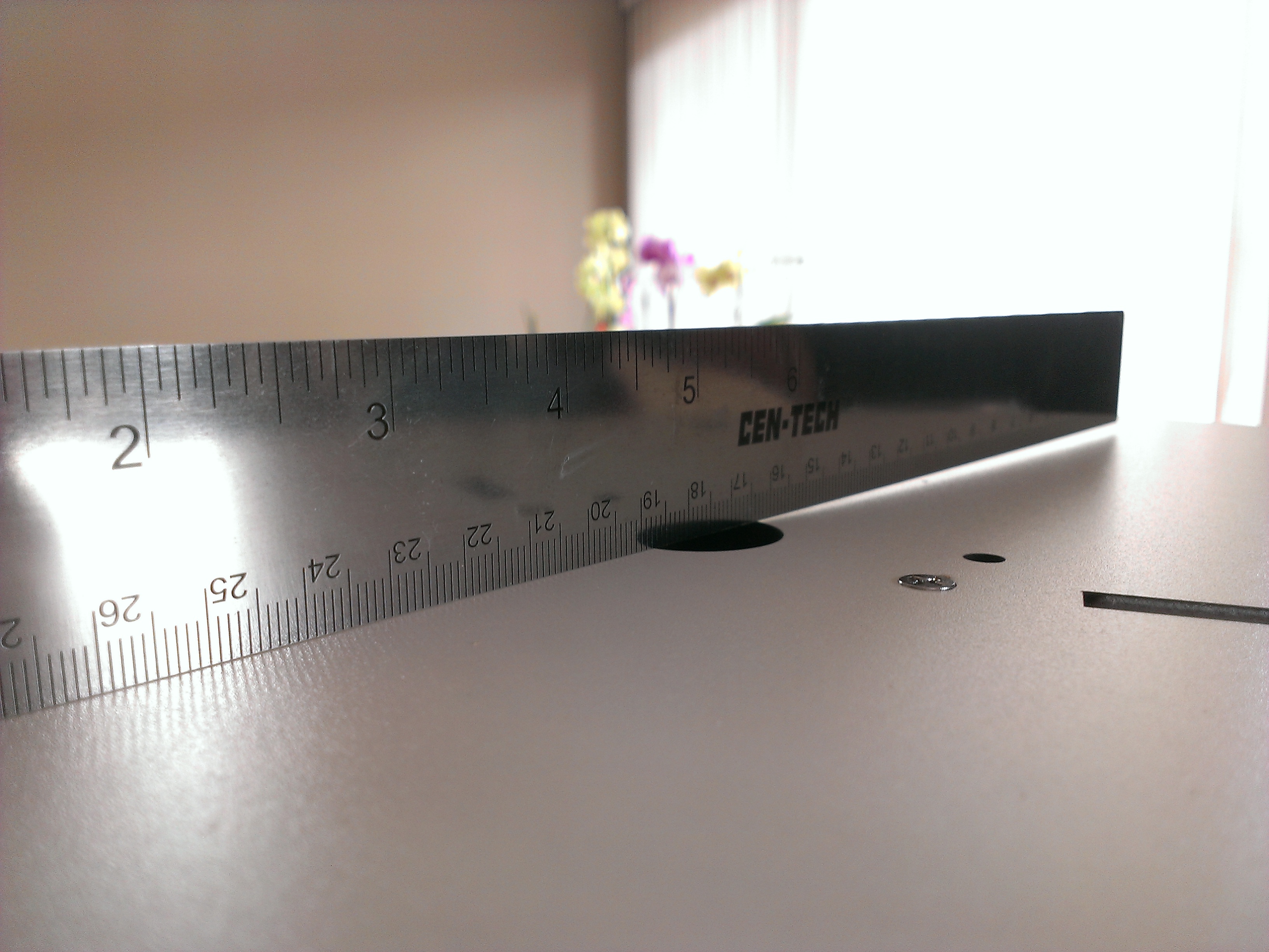

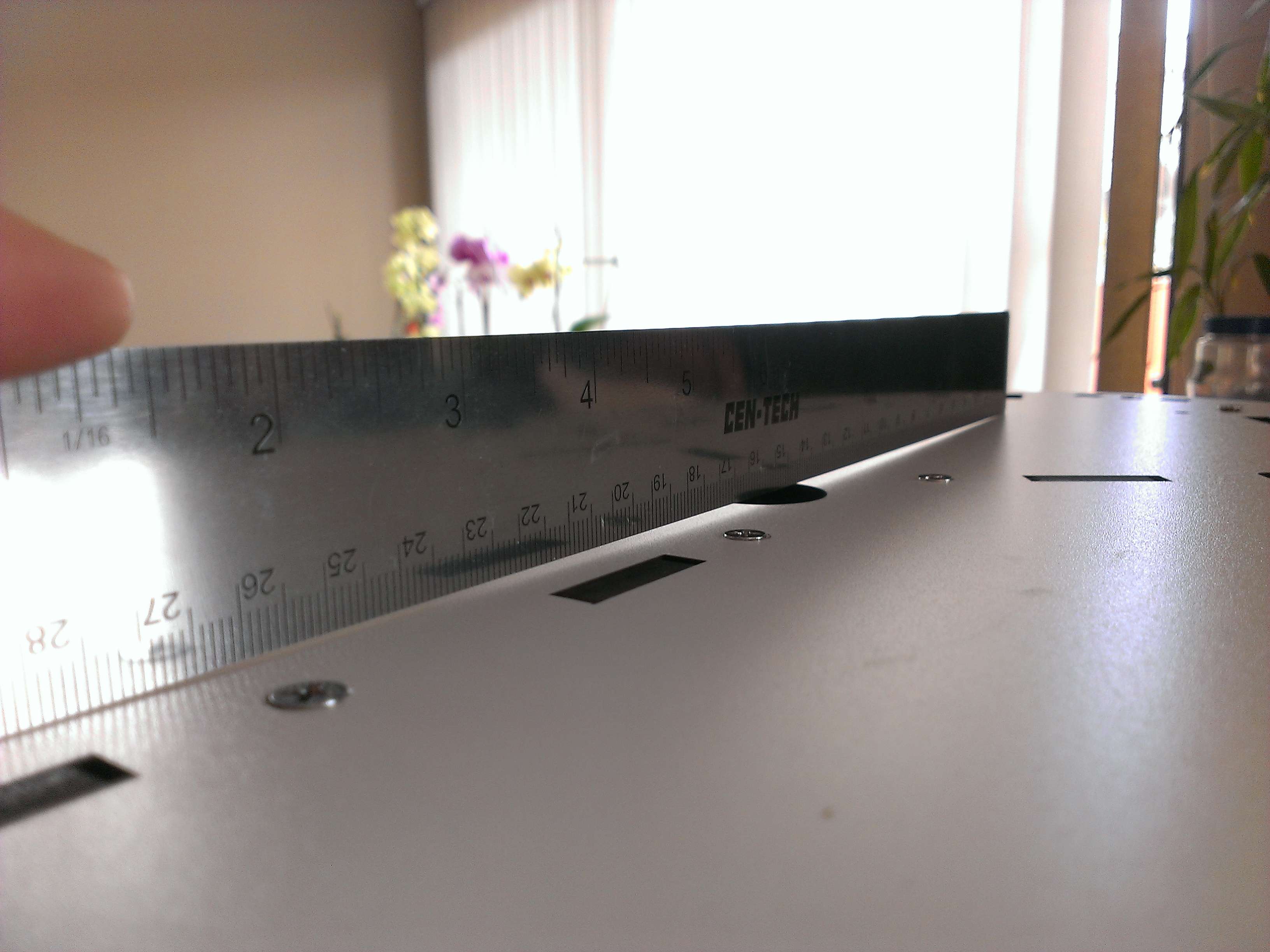

Straight Edge on top
This is the top plate with a straight edge. You can see the dip in the middle. It looks to be over 2mm of a depression.
Straight Edge on Bottom
This is the bottom plate with a straight edge. You can see the high spot in the middle.
I'm not exactly sure what's going on, but I think I'm gonna disassemble everything (heart breaking) and get some measurements of the tri support pieces I think there's a serious discrepancy, whether or not it's a dimensional error, or a squareness issue.

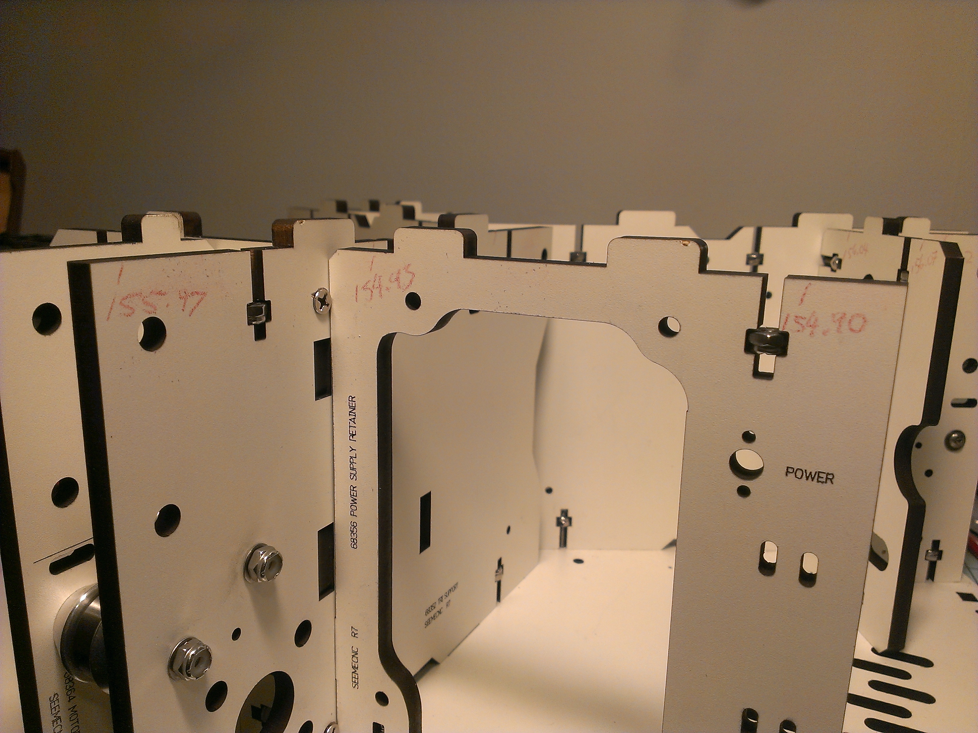

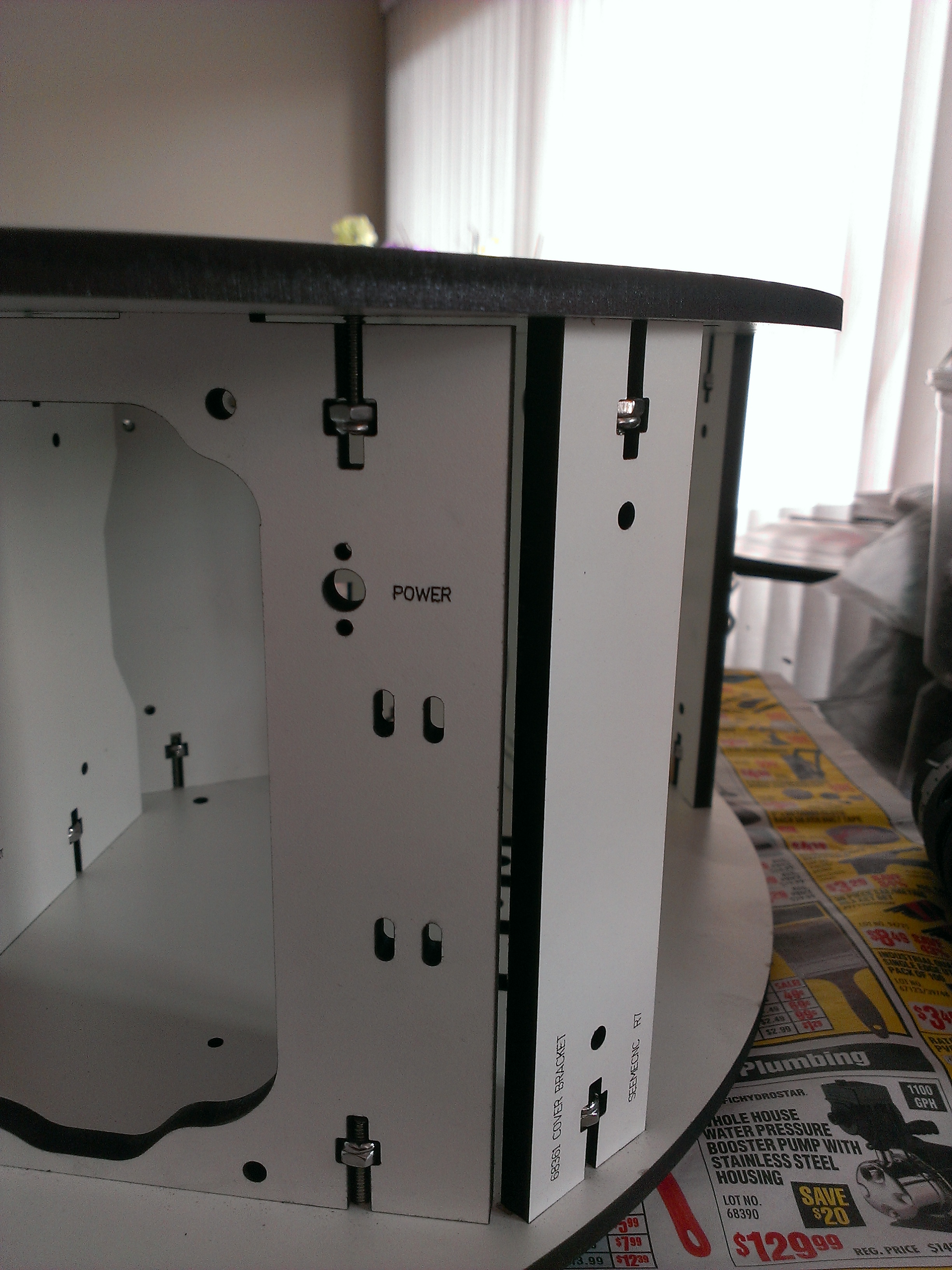

Power supply mount
Power supply mount
Take a look at the Power supply mounting plate. Both the Power Supply plate and the adjacent Cover Bracket are sitting tight to the bottom. But notice how far the top of the Power Supply plate is from the top plate. There's like a 2mm discrepancy.

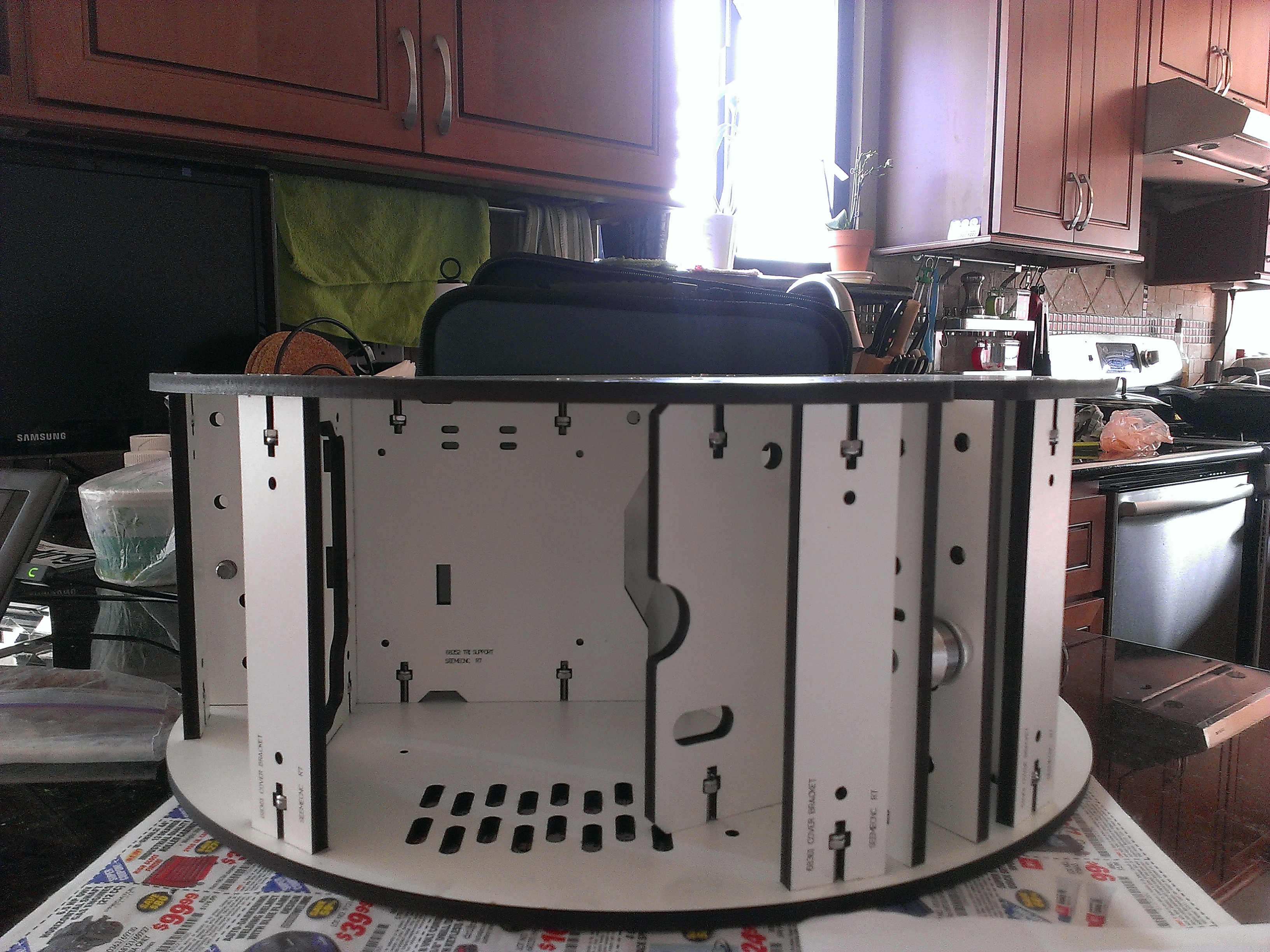

Visually warped
Visually warped
Finally, the whole assembly is visually warped. It may be hard to tell in the picture, but there's a visible waviness to the top if viewed at eye level. Placed on my granite countertops, with my missing feet, the bottom does not sit flat against the surface. Unsurprisingly with the measured bulge, it wobbles quite a bit.
I used a power screwdriver with adjustable clutch for assembly. All the screws are snugged up with the same torque, snug but not overly so.
I'll update this thread with more pictures when I get a chance to disassemble and measure the pieces. So far I'm a little disappointed.. :cry:

Since all of the vertical pieces are exactly the same, I would probably look at the tightness of your nilocks (hex nuts). Of course, melamine is never going to be perfect. Once you get it from rocking, then there are two things that you're going to have to be concerned about: getting the heated bed level. The rest is adjustable.

glad i wasn't the only one noticing it. yours is worse than mine. That's gonna be a night mare to get a level build platform. I'm still tweaking mine to get it level.
you have the same problem on mine too the power supply area. i have warping here also.

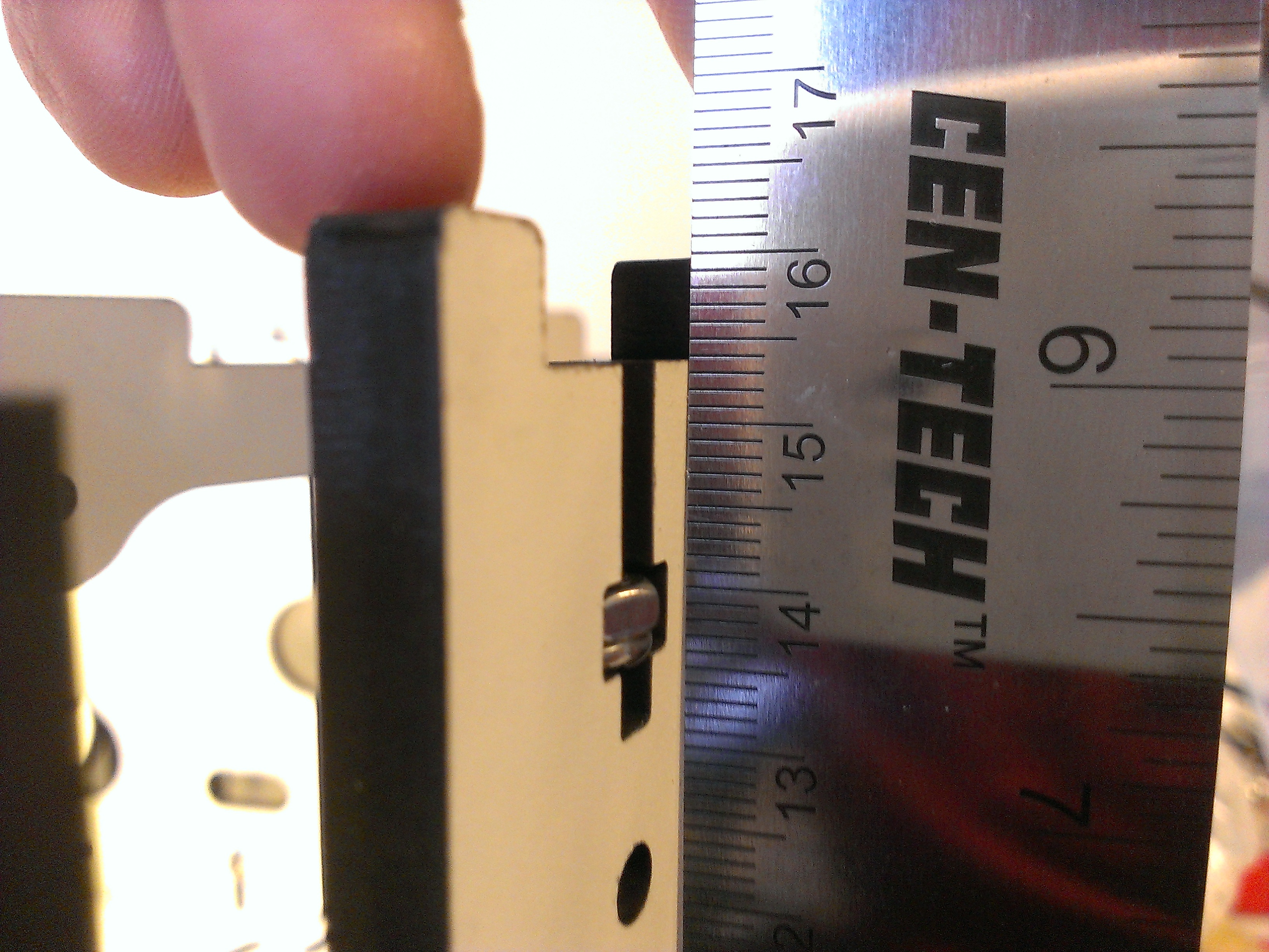

JohnStack wrote:Since all of the vertical pieces are exactly the same
Have you looked at the 3rd picture?
It looks really bad, I would even send it back..

Maybe try to loosen all the bolts holding it together on both sides, just loosen. Maybe about a 1/4~1/2 a turn. Then put it on a nice level surface. While lightly pushing down on the top, wiggle the top back and forth to get all the joints to settle together. And check it again with the ruler, before tightening everything again.
If it's still real bad. It's up to you if you want to go further or contact CNC to possibly getting a replacement.
If you decide to go forward. Tighten the center group of screws on one side, then gently flip it over and do the same on the other side. Then slowly work your way outward, picking a group a screws to tighten (in a circle around the base). And flipping and doing the same on the other side, till you get to the edge.
I don't know if this will work, just taking a guess this might help. I tightened the screw on mine like this. But am ashamed to say I didn't check it, with a straight edge like I should have. This makes me want to check mine.

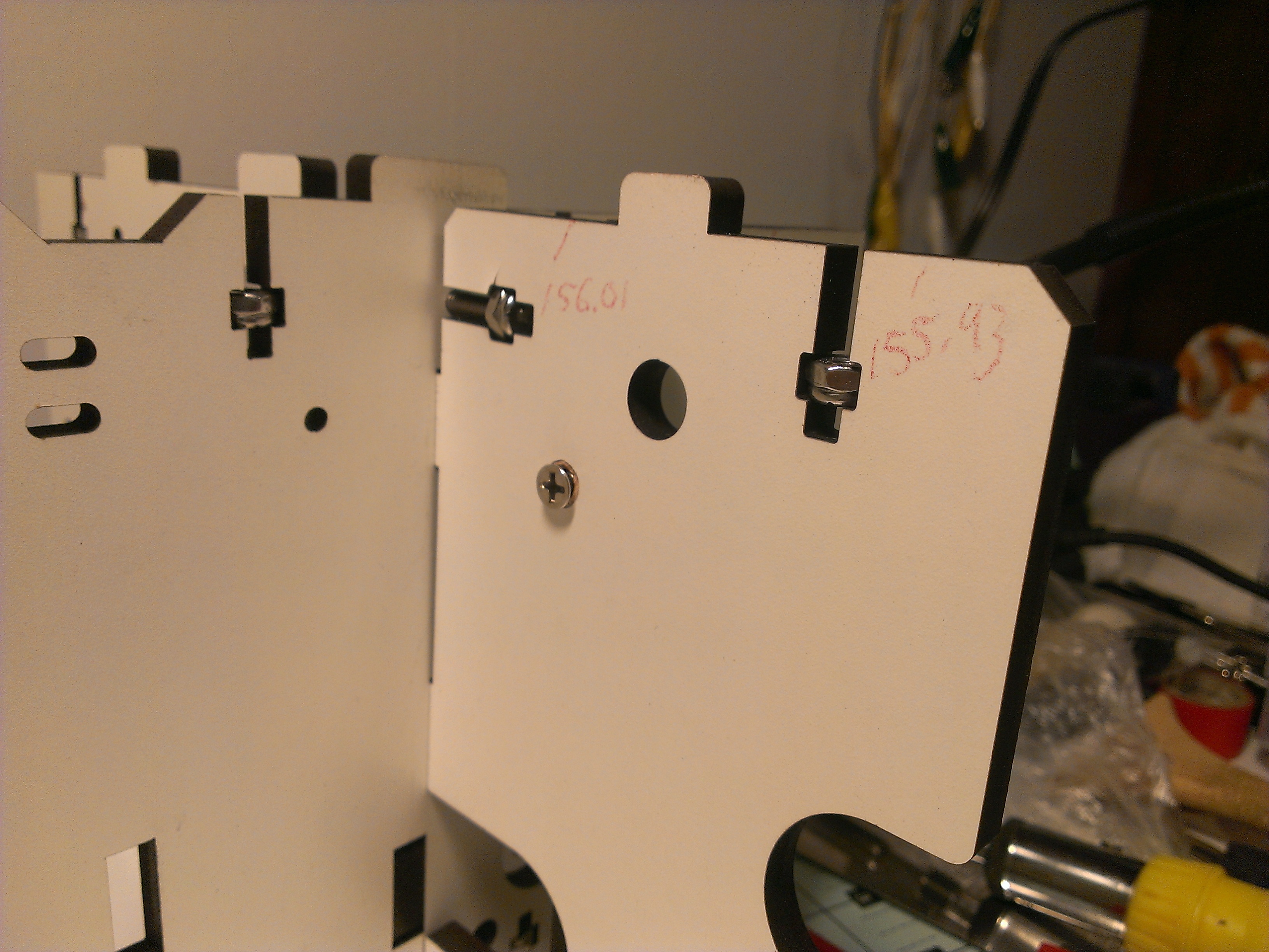

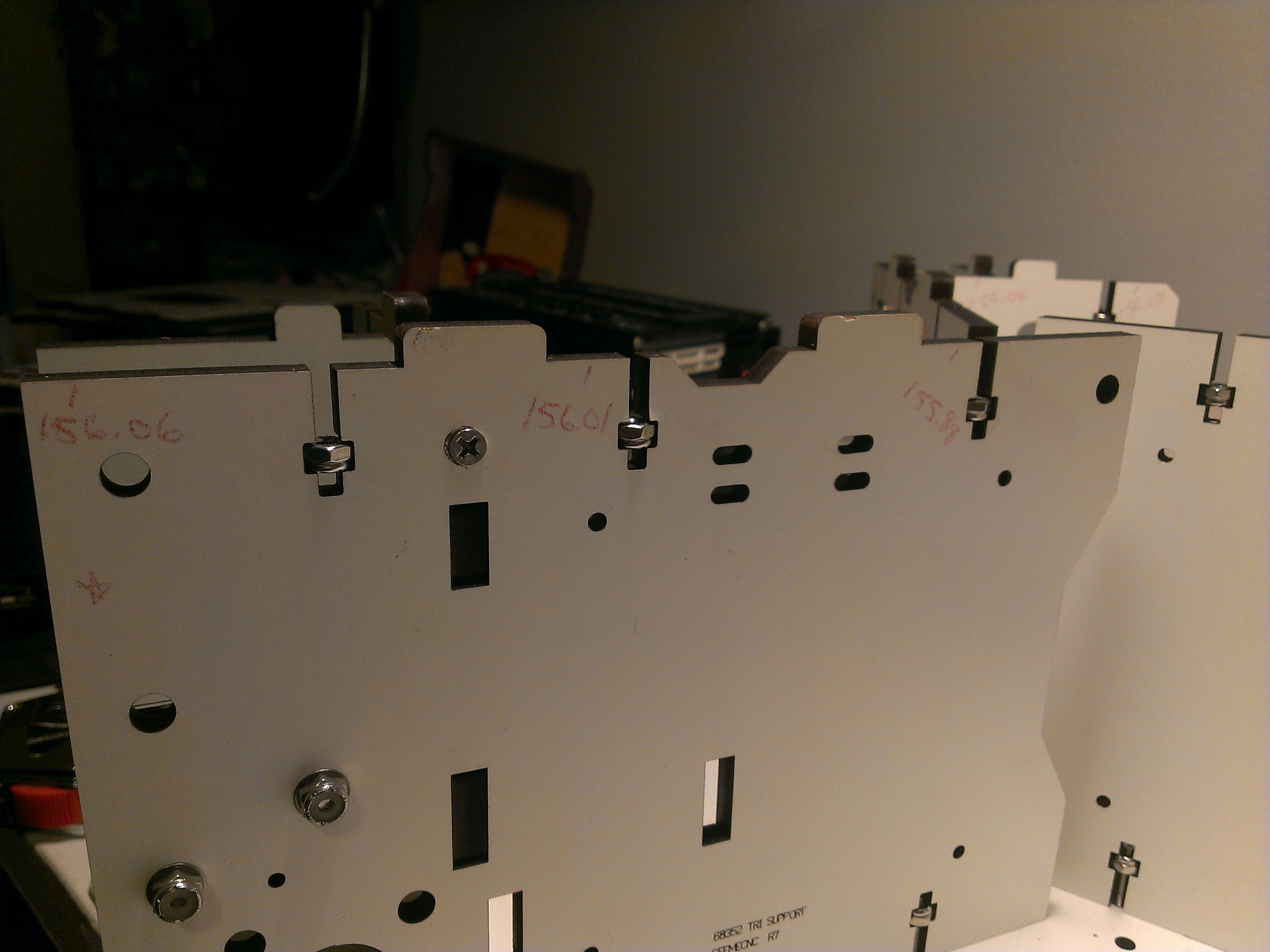

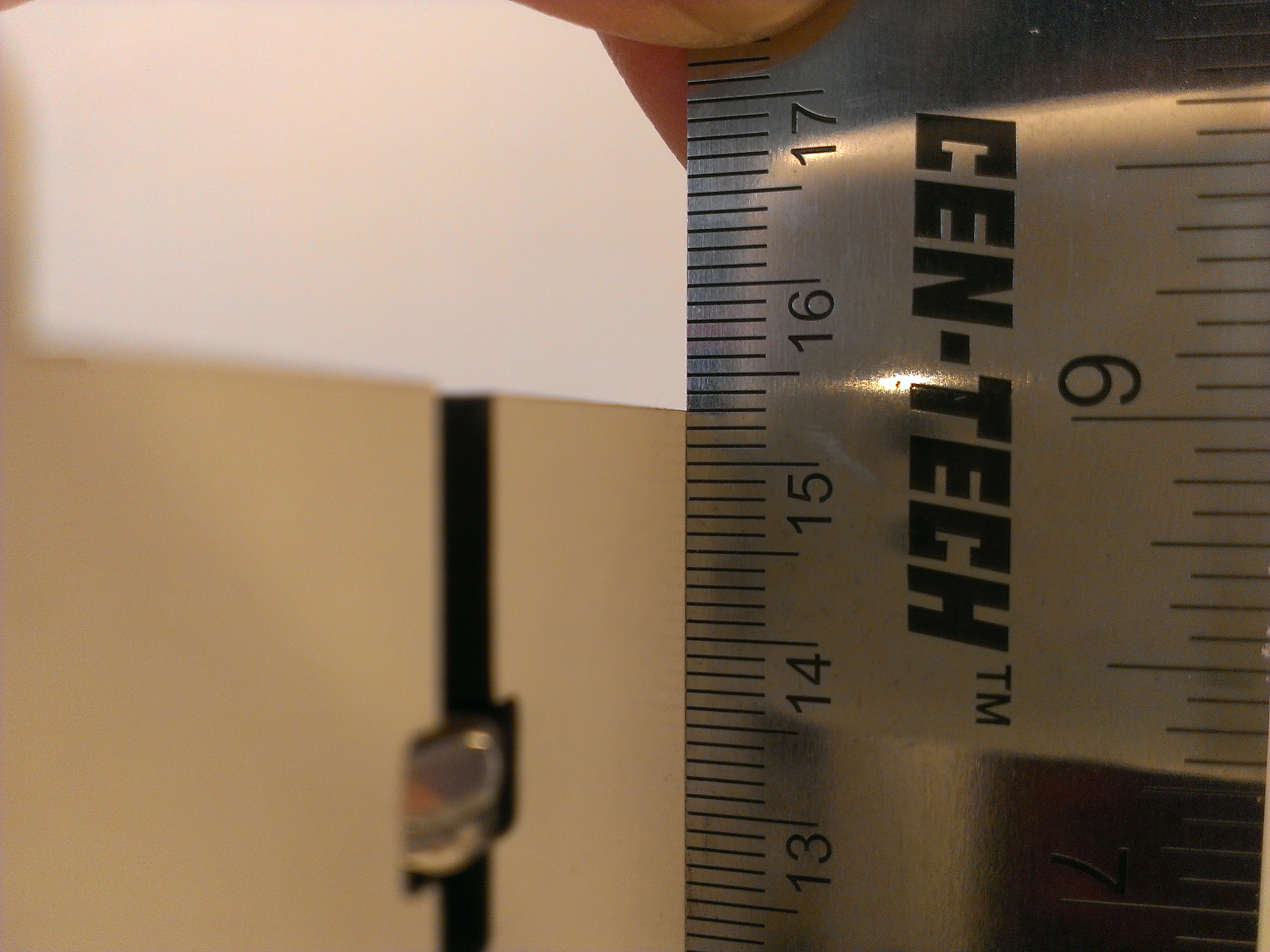

I took the top plate off and measured the vertical supports. I rechecked all of the bottom screws to ensure that they're snug and the vertical plates are tight to the bottom plate:
Tri support measurement
This is my steel rule measuring one of the tri supports near the center of the round. (Keep in mind that the end of the rule is resting on the bottom plate and the measurement is actually a few mm shorter.)

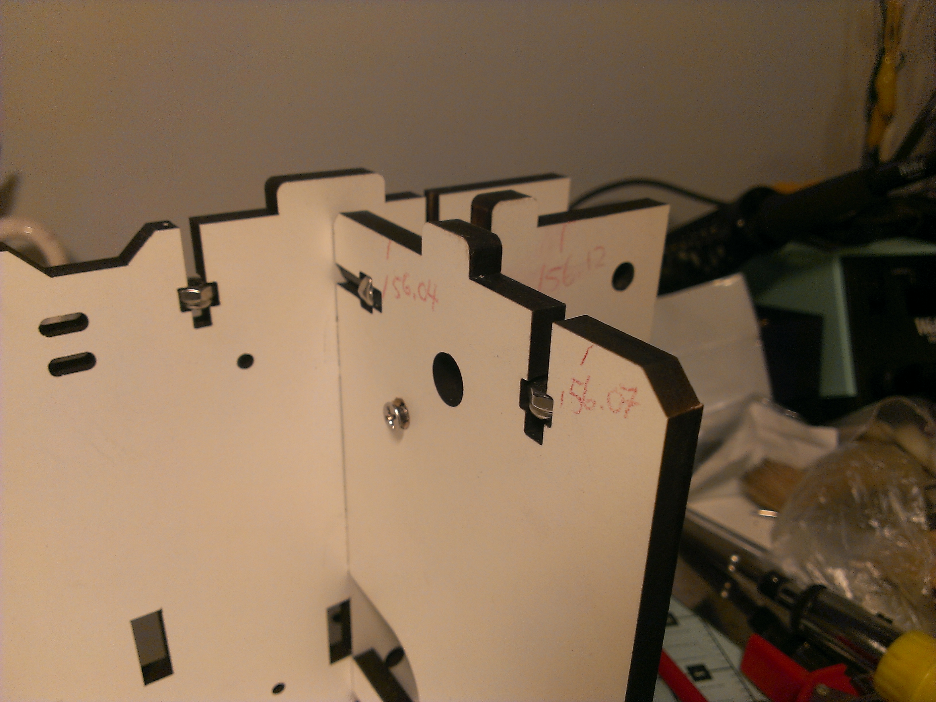

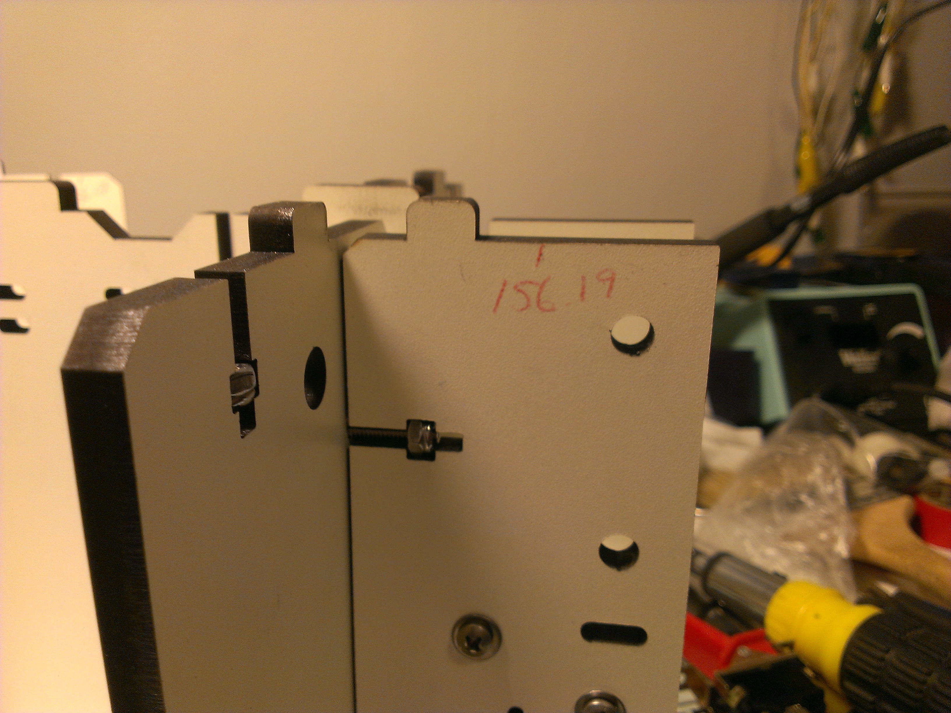

Cover bracket measurement
And this is measuring one of the cover brackets that are near the edge of the round. You can see that there is about a 1mm difference in height.
I'm in the process of measuring every vertical support and will post more pictures and info later. Thus far, nearly every one of the cover brackets are taller than the middle tri supports. That would account for the depressed top.
I think a possible fix would be to maintain flatness of the bottom plate, and then sand down all the vertical supports to a fixed height.

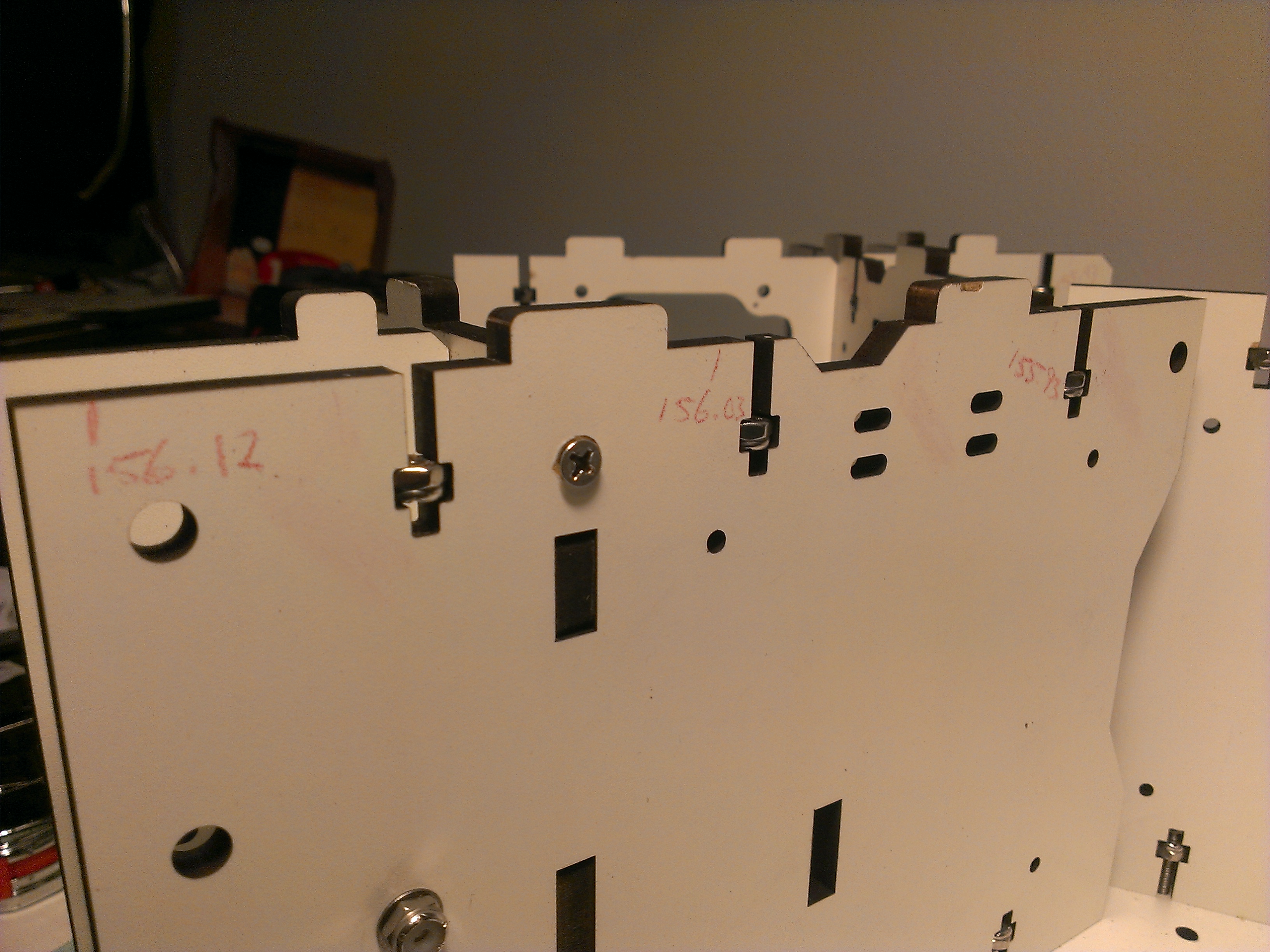

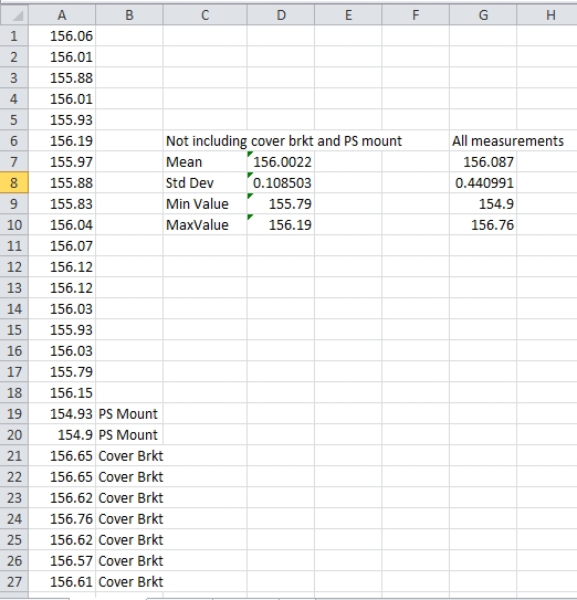

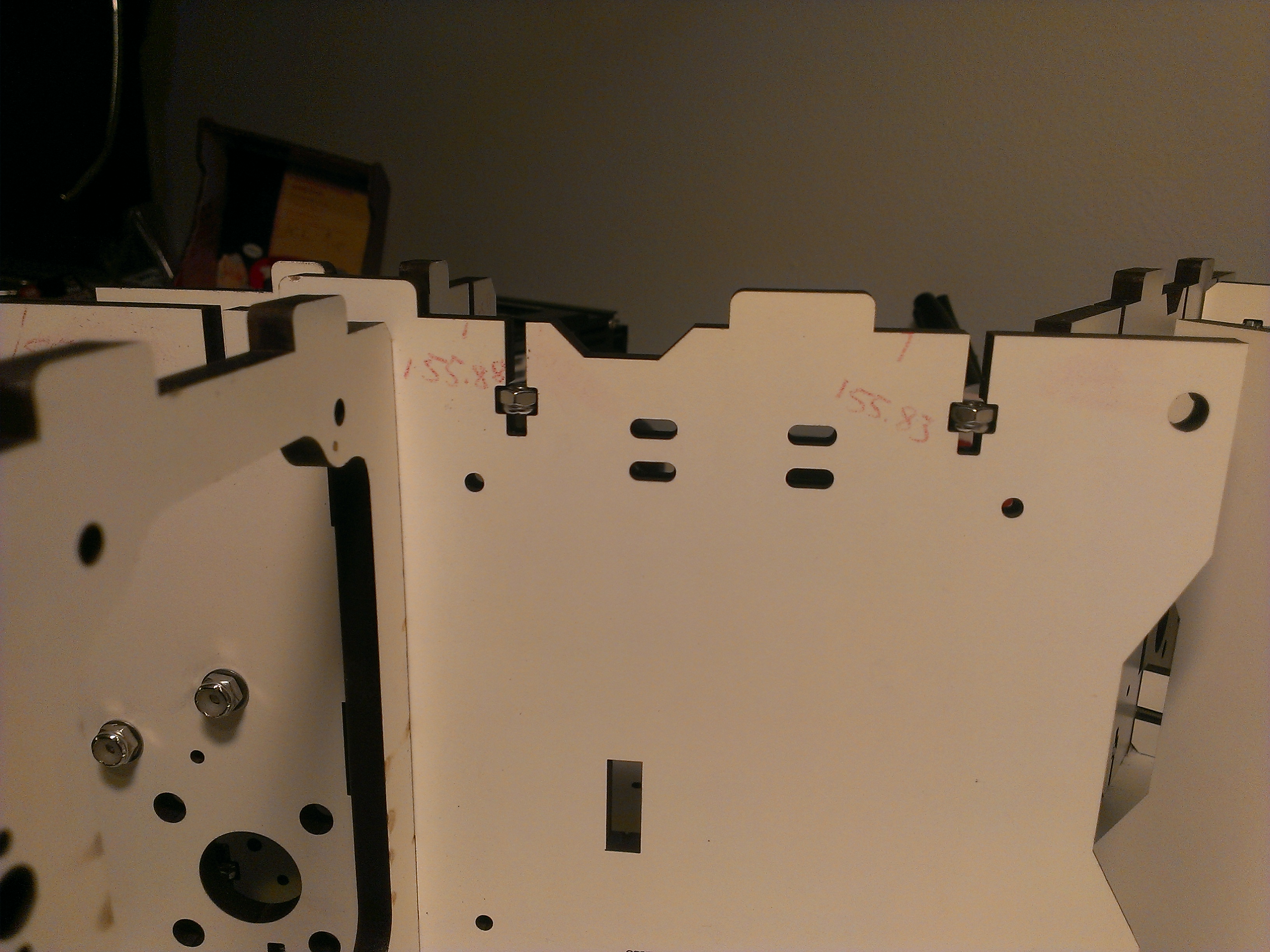

I took some time to do some measuring:
Measurement spreadsheet
The unlabeled measurements in the spreadsheet are tri supports and motor/idler mounts.
You can see that the measurements aren't too bad on the tri supports and the motor mount. The power supply mount and the cover brackets are the real culprit. Including those measurements more than quadruples the standard deviation! And the difference between max and min is 1.86mm! Not good at all.
Since I'm not going to use the cover anyway, and I'm using a non-atx power supply, I'm just going to skip using those pieces in my base. That should mean only minimal sanding to get the other pieces withing a tenth or so of each other.
But I'm beginning to wonder if that will be even worth it, given another problem I've discovered....

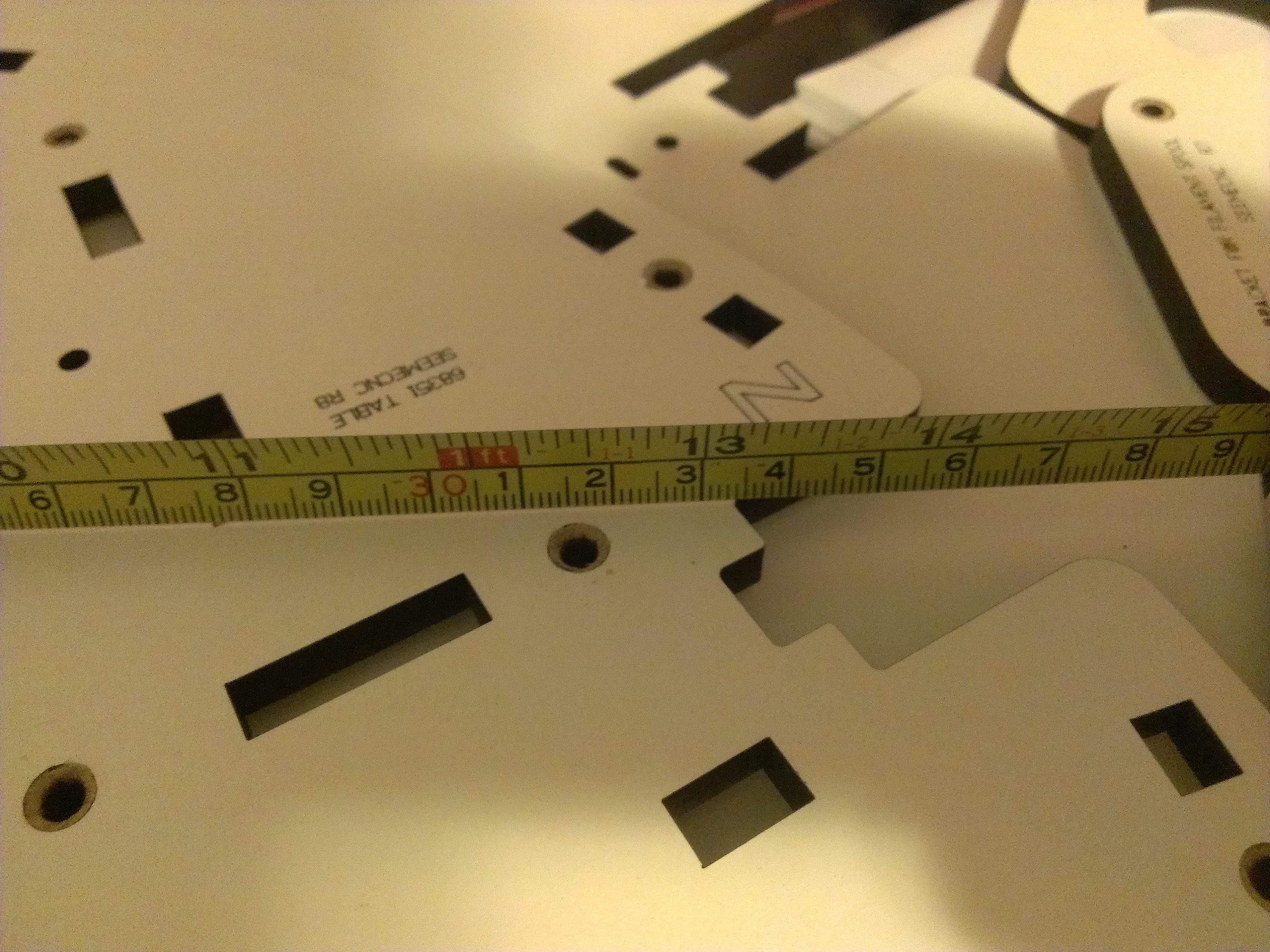

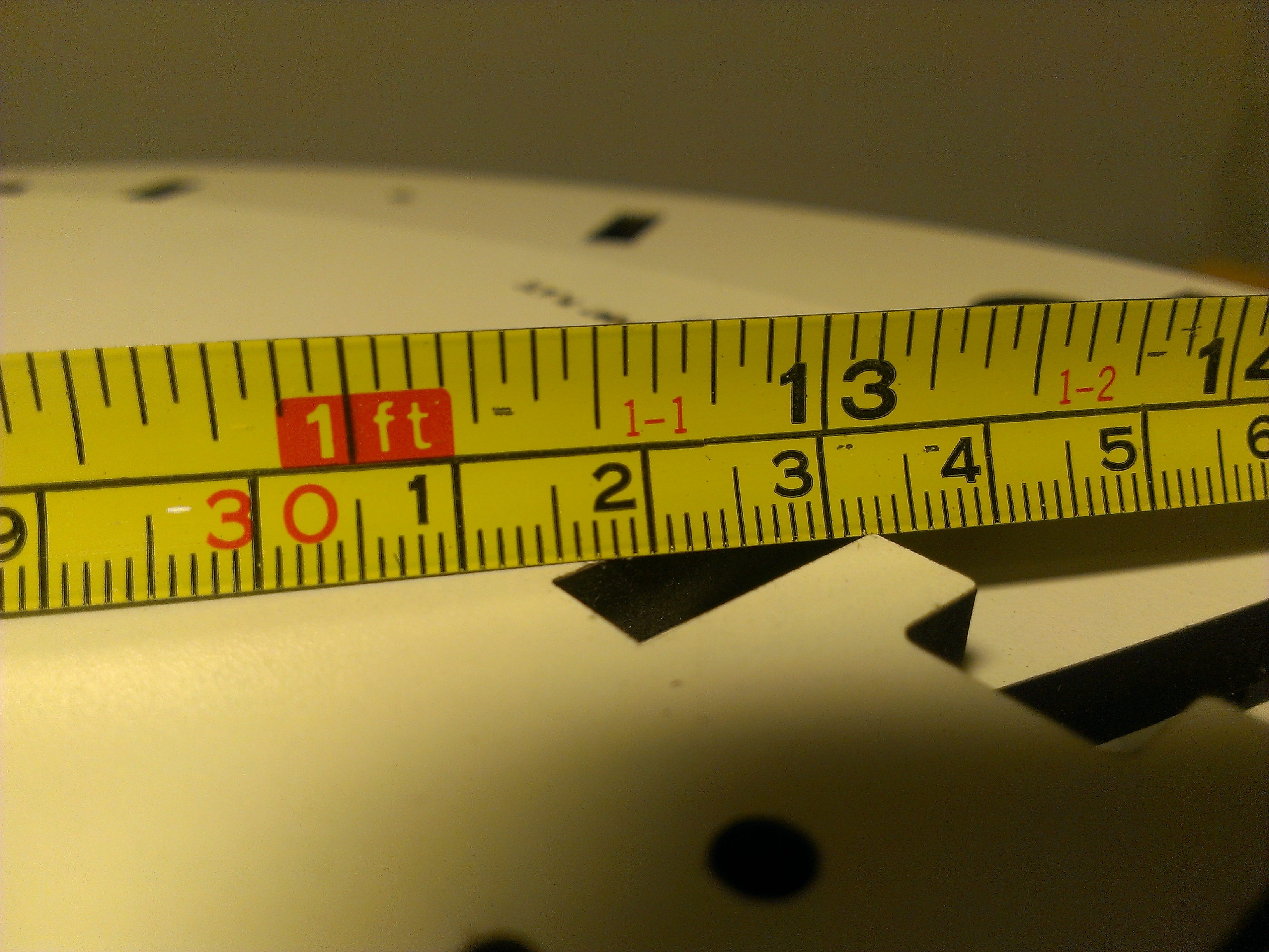

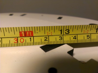

So in other threads I've been wondering about the necessary precision of tower placement/plumbness/perpendicularness.
I remember seeing in another thread somewhere about measuring the distances between towers. So I decided to measure the extrusion slots in the base plate and top plate.
Base plate z-y
Base plate z-y
Base Plate y-x
Base Plate y-x
Base Plate x-z
Base Plate x-z
NOTE: I'm measuring with a tape measure starting at the 2cm mark. So deduct 2cm from the measurements. I'm measuring to/from the inside corners where the t-slot extrusion will sit.
My eyeballs are telling me that on the bottom plate the z-y measurements are shorter than the other two by about 2mm.

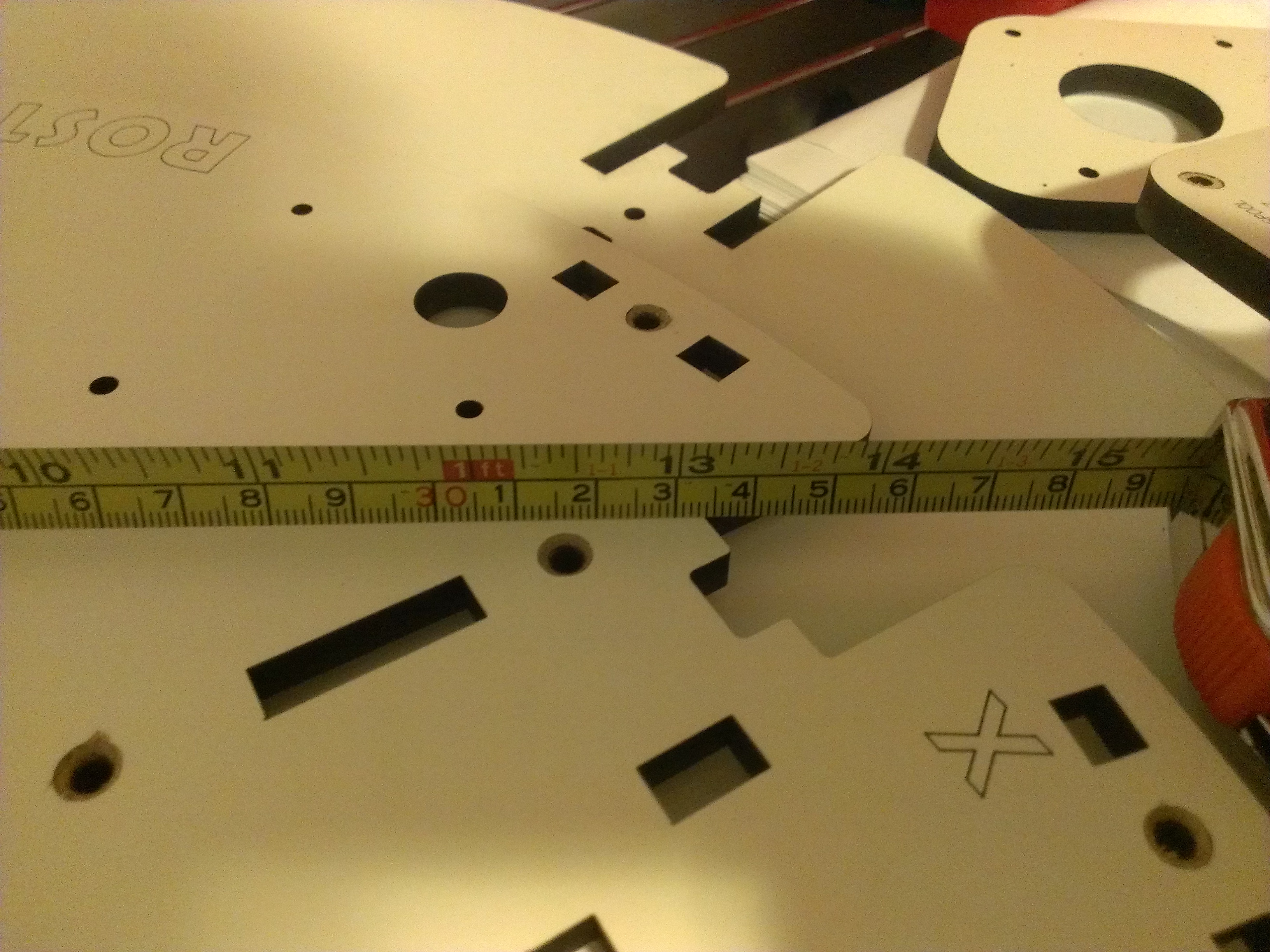

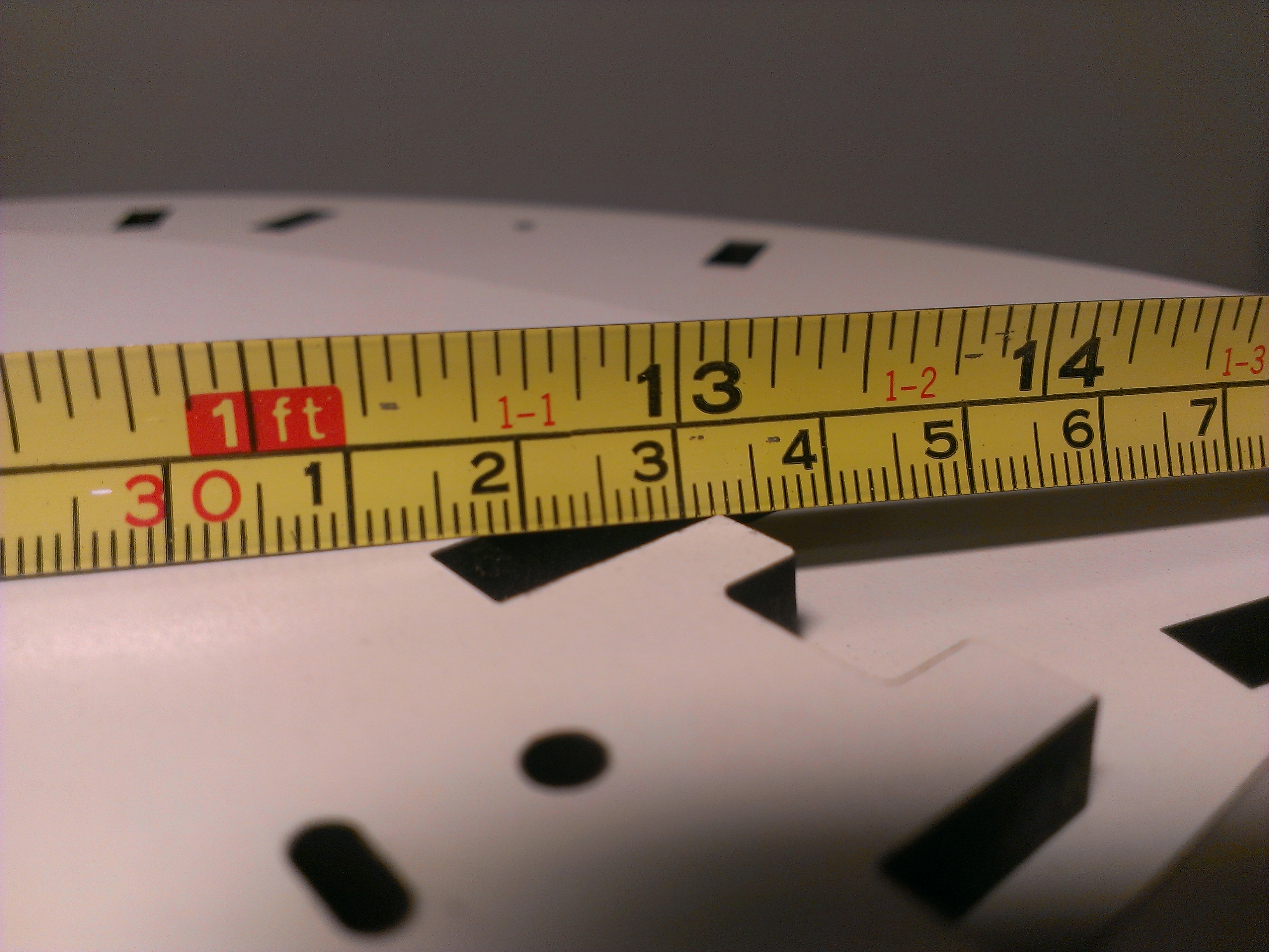

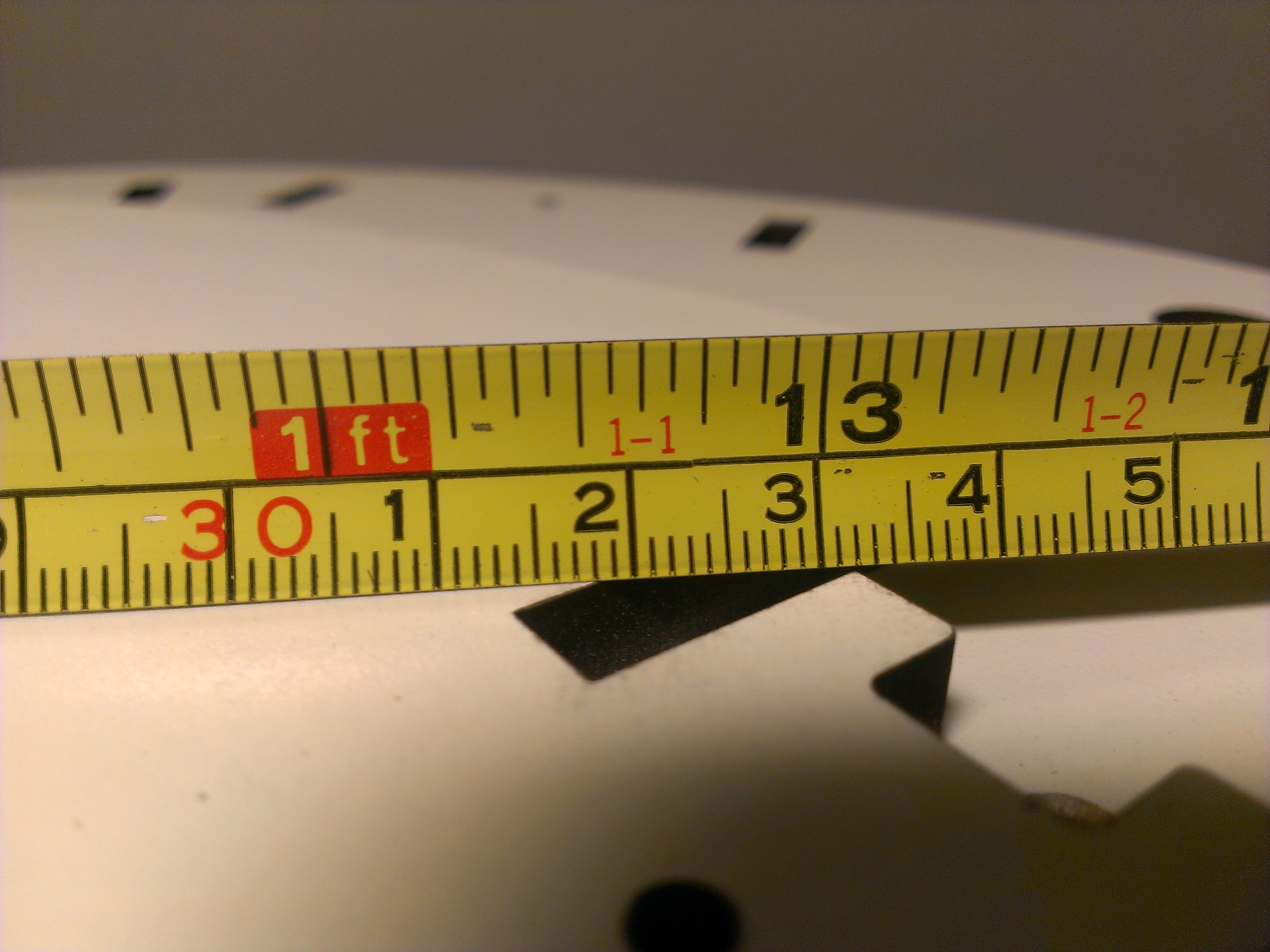

Top plate1
Top plate1
Top Plate2
Top Plate2
Top Plate3
Top Plate3
The top plate is better. With maybe a .8mm difference between the short and long measurement.

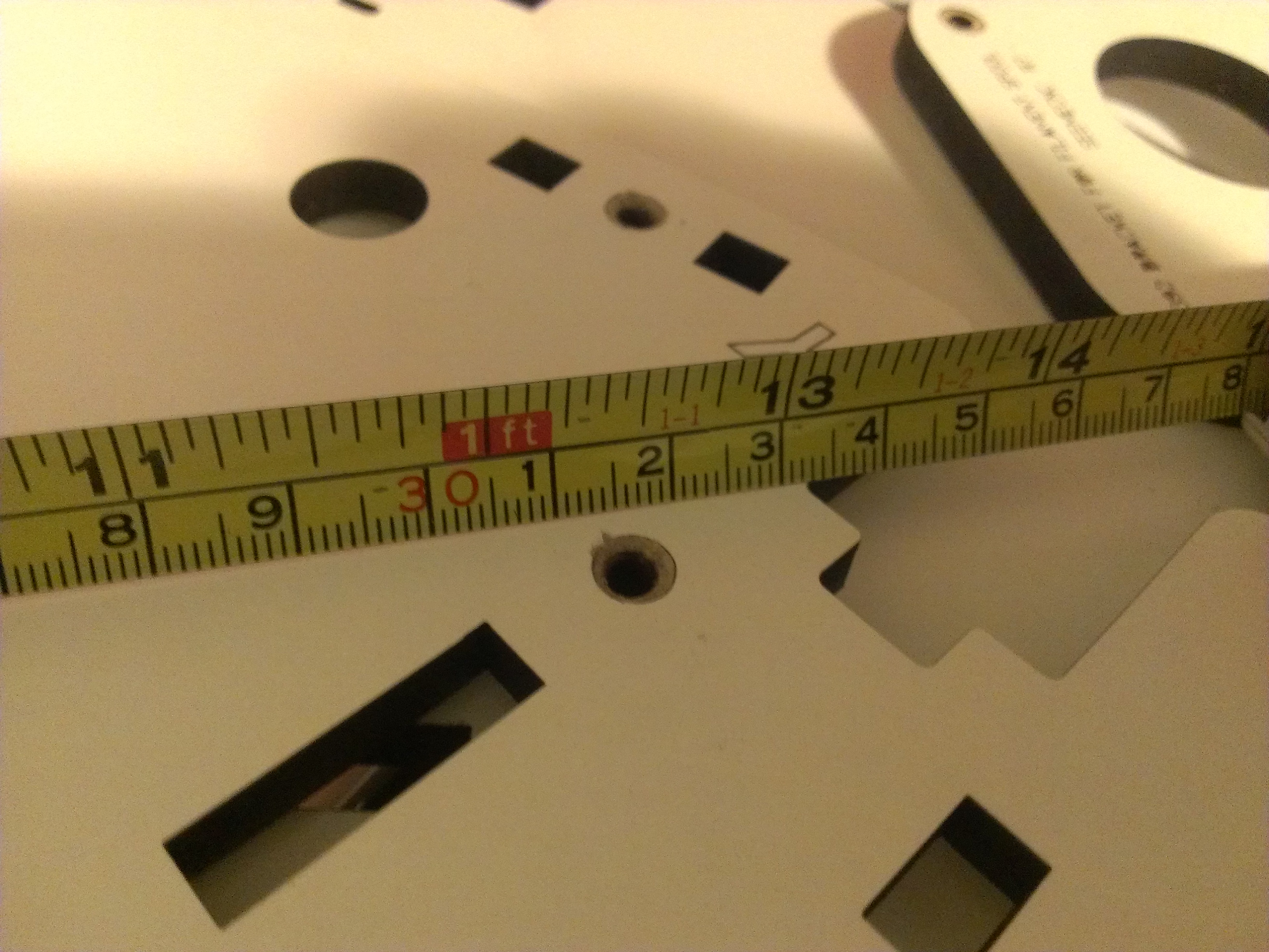

The problem is more apparent when you put the two plates on top of each other:
Top and base plate stacked.
The two slots on the right match pretty close, maybe .5mm off, but the one on the left is WAY out there...
My thought is, if I tried to assemble the kit as is, the towers will never be perpendicular to the build surface, and never be equidistant and parallel from each other. I'm not entirely sure, but I think this would be a big deal.
I'm not sure where to begin to try fix this as I'm not sure how much wiggle room/adjustment there will be once everything is assembled. I could sand the crap out of both plates to enlarge the slots in both, but I don't want it to be loosey goosey.
Any suggestions?
I'm going to email Support a link to this thread to see what they think.

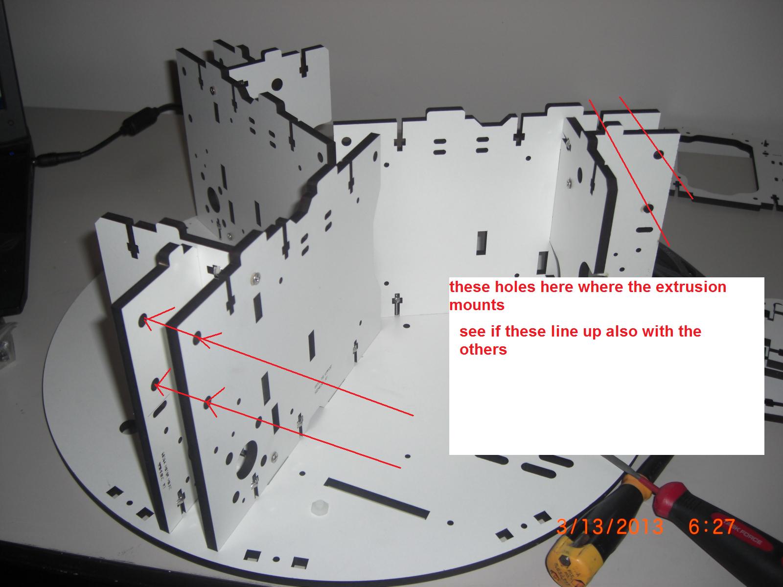

the holes where the extrusion mounts to the melamine make a difference too, even if you sand those slots out for the extrusion, your limited how much you can move it because of those holes.
I would check the 1/4 mounting holes for the extrusion to see if they are in the same spot also.

cambo3d wrote:the holes where the extrusion mounts to the melamine make a difference too, even if you sand those slots out for the extrusion, your limited how much you can move it because of those holes.
Are you referring to the holes on the top plate where the "clamps" mount? I'll measure those when I get home from work. I have a feeling they'll be off too.
I was thinking that even if the extrusion slots weren't exactly the same distance apart, I could make it work by maybe adjusting at the parallel arms attachment point or somehow adjust the cheapskate carriages. The idea isnt so much keeping the extrusions equidistant, but the point at which the parallel arms attach.
But that idea is thrown out if the top and bottom plates dont at least match each other. If they were both off consistently, i think i would be in a better position.

Sorry cambo3d, Im not clear on which holes on the bottom you're referring to. Do you have a picture?
cambo3d
Posts: 1057
Location: Florida
Re: ApacheXMD's Build
Post by cambo3d »
ApacheXMD wrote:
cambo3d wrote:check the bottom then check the top.
