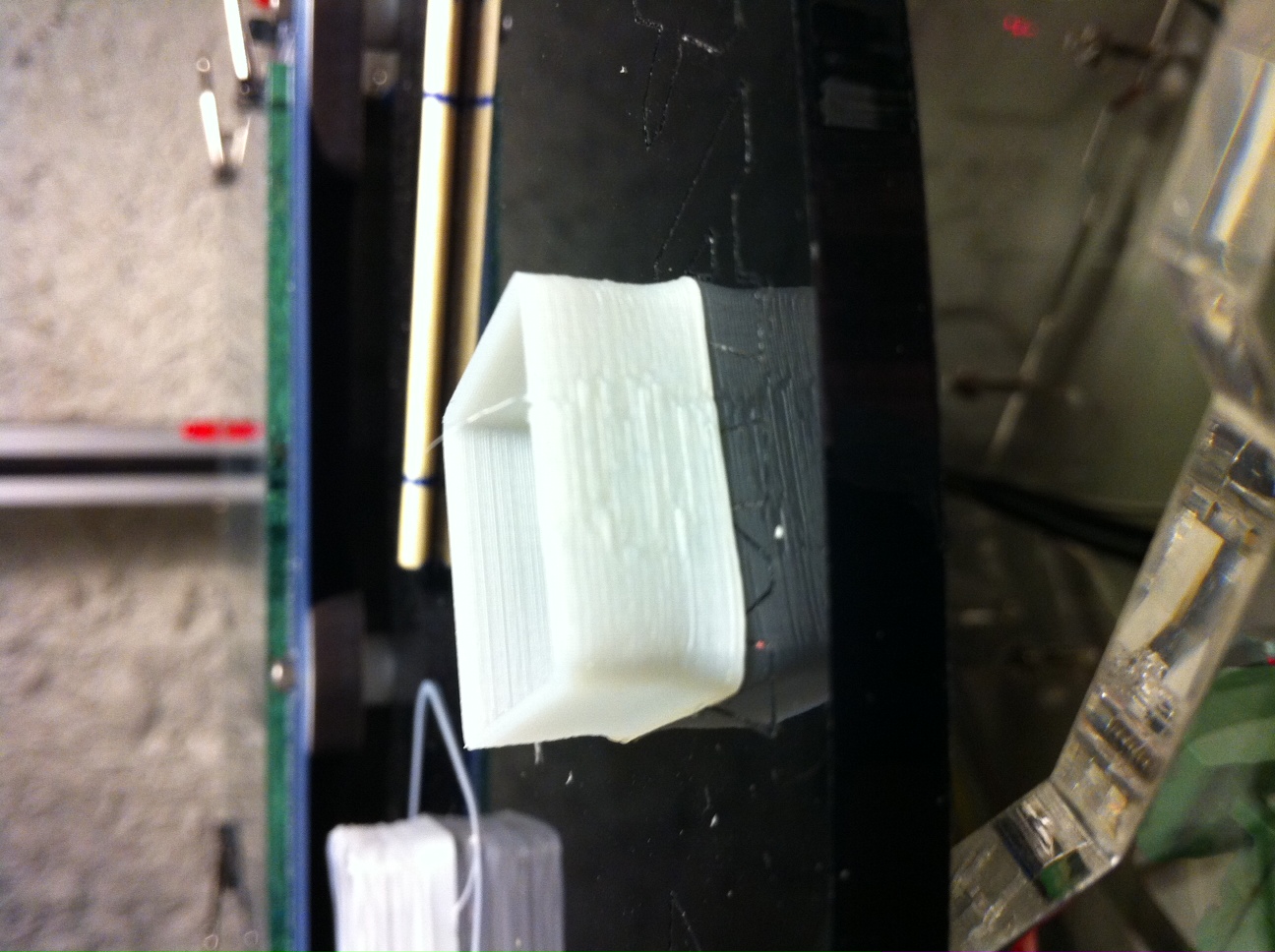

The single wall test (no retraction) seems to start out well then goes off. More substantial prints like the minimug end up with polyps (9mm retraction @ 100mm/s, 0 lift ).
Some directed pointers would be very welcome.. I'm getting frustrated.

Lets start with the single wall test print with no retraction, until you can print that you're wasting your time printing anything else.
What layer height are you using and what extrusion width?
It looks to me that that layer height is too large for the extrusion rate.

The first 8 or so layers are clean and tight, though they seem to get smaller / constrict. as they rise.
Re: 3 months in and still bad prints
First slow way down start at 10mm/s and even with that you will probably need active cooling.

Very fine, tight lines. There is a little back and forth movement at the layer change that's visible. There is bowing in from the first layers to the high ones. Is that just the contraction of the plastic when it's not attached to the platform?
I'd say your probably still printing too hot, I'd start dropping the temperature in 5 degree steps until you start to see either delamination or the extruder starts skipping.

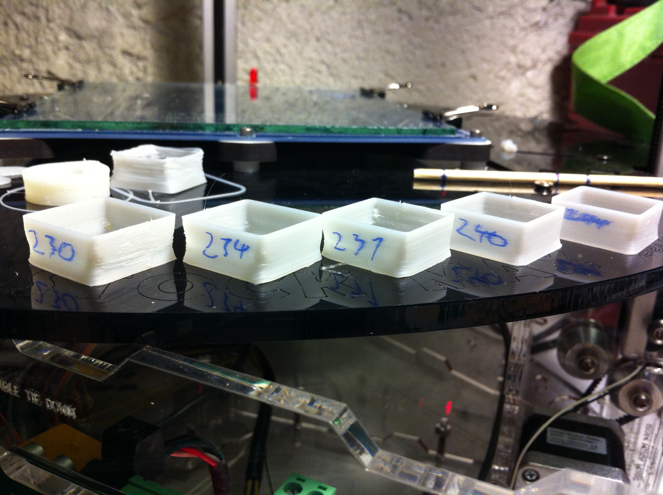

So I tested the one wall prints at a variety of temperatures. 244, 240, 237, 234, 230, and 227. Things didn't really break down until I got to 223. The other prints were substantially the same, with slight variations in the puckering at the corners. If I did a few more runs of each maybe I could discern a pattern, but for now I think 240 looked the best with 227 coming in 2nd.
What would the affect of a fan on the print surface be for ABS? Would the faster cooling prevent or exaggerate the puckering (where it constricts in at the corners)?
the cooling fan stops the plastic being flexible faster, this is particularly important for tall thin objects, or objects with thin parts, or objects with severe overhangs where if you can't cool it fast enough you end up with the printhead pushing the plastic around leading to a mess.
The problem with a fan for cooling on ABS, is that it can lead to cracking and delamination if you aren't printing hot enough to fuse the new material to the old material.
With PLA I will print with as much cooling as I can get on a part all of the time, because it's always never a detriment, with ABS I'll look at the part and decide, for example I fing the belly of the treefrog to be almost impossible to print without cooling, but I wouldn't bother for most structural printer parts.
Forgot to ask, how hot is your bed?
The 240 one looks OK to me, and I'd start with that.
You should follow the rest of my calibration post at this point, measure, adjust flow rate and print a 100% filled cube to verify.
