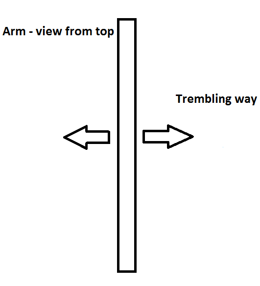

In some travels my arms don't move regularly, with trembling and vibrating by small steps
U aluminium joints are sticked,
With the steel axes, and with the plastic supports, near the end ans near culumns.
Iit's necessary, I think, to put off all the arms,
and verify all connections - as detailled in the delta arms blues post.

That trembling is caused by either mechanical friction or under powered steppers, resulting in the steppers not having enough power to overcome the force required to move smoothly.
If you are running a RAMBo you can set stepper current in firmware. I run at 185 (not amps, just the digital setting). You might tweak that. Tell us if you are using the kit electronics or what you used.
If mechanical, you need to adjust the cheapskate carriages to get smooth, slop free motion - preferably test without the belts attached. Misaligned or over tight belts are also part of the mechanics and can cause problems too.

only arms tremble in horizontal way and a little the head also sometimes,
