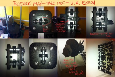

So I've assembled the cheapskates - but once fitted onto the rails I can't tighten the axle supports enough to fit the rails - It's like the bearing covers are too fat, or the rail is too thick - I need to be able to tighten the axle support bolts by about 4mm more..
See attached jpg.. Click on it to see a higher-res image...
AnalogBanana Rostock Max

You tighten these axle supports last just to to tighten everything up. They don't tighten all the way

Ok - the reason I'm worried is in geneB's pdf manual the whole assemble seems to fit together tightly - the axle support is flush, whereas I cannot close that gap..
geneB's example below...

I suffered from the same confusion initially. It is difficult to see in the picture but there is a gap. Please forgive my handwriting that is horrible even when drawing with a mousepad.
[img]http://farm9.staticflickr.com/8123/8630799577_973223bfc4_n.jpg[/img]
gap by foshon, on Flickr

Good news then, thanks for the advice Foshon! I'm going to keep building..
On closer examination, I found that all my axle supports have (I don't know what to call it) "laser skew"
i.e. the cut sides are not true square, as if the laser cutter took the cut at a slight angle.
It's definitely not helping with precision, but I will attempt to compensate..

Seems to be working now - quite a nice action - no slop and tension is adjustable via the axle support scres.
All this confirmed by the vendor, and he says he'll look into the laser cutter skewing.
