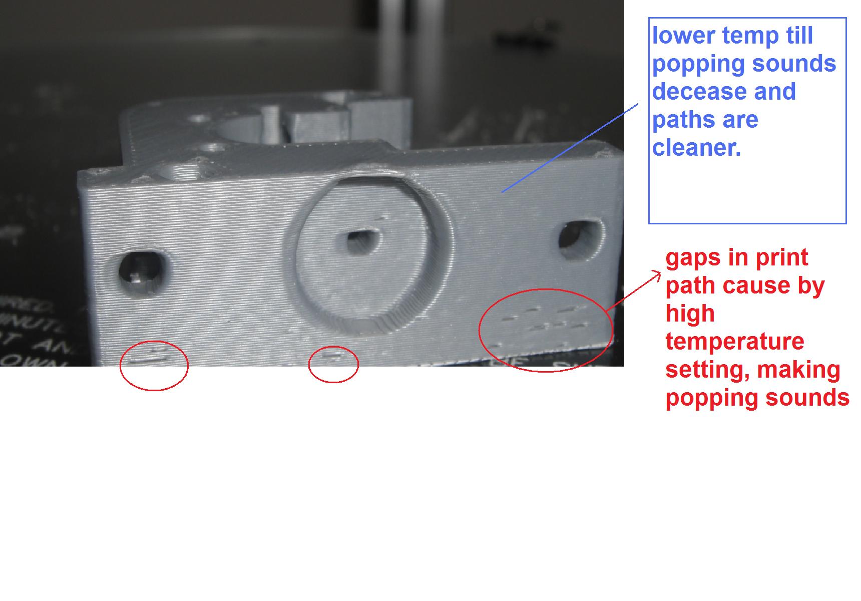

I also notice when this popping occurs that it leave gaps in the print path..

I was getting the same popping printing ABS at about 240 degrees. I turned down the heat (to 235) and "no more popping." I believe it's a hot end temperature thing.

Thanks guys popping filament solved, it wasn't the lube, it was the temperature. I found that my popping filament was caused my too high of a temperature setting as noted by you guys, I started off at 230 and kept lowering the temp by 5 degree increments till i found the sweet spot, no more popping filament and my print paths are coming out better

example
made a big difference in the print after making adjustment to temps. every time i hear a pop in the filament it would leave these gaps.

for the gray abs filament i was using, it was 215 degrees
( warning though, your temps will vary depending on how you have yours calibrated) just keep lowering your temps till that popping goes away. just dont lower it too much.

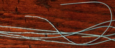

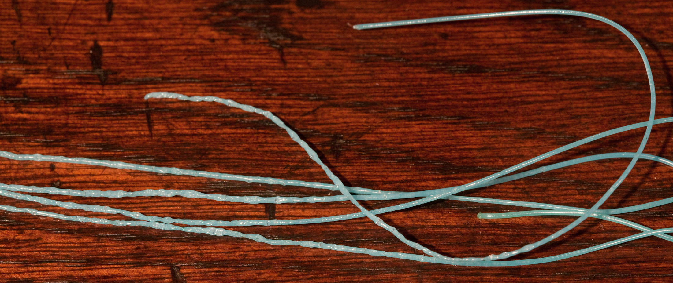

I just opened a new package of the blue florescent ABS filament from Rainbot. I don't heat popping, but it's very bumpy, not smooth like the other filaments I've tried.
After sitting in the nozzle for a moment, when it first comes out, it is smooth for a couple inches and then everything else has these bumps. I imagine maybe it's moisture drying out in the nozzle? In the photo you can see smooth on the left and bumpy on the right. Click for hi res.
I'm baking now at 185F. Any other suggestions?

What temperature did you try at? The fact that if it sits in the nozzle for a while it extrudes fine implies to me that it needs a higher temperature.barnett wrote:I just opened a new package of the blue florescent ABS filament from Rainbot. I don't heat popping, but it's very bumpy, not smooth like the other filaments I've tried.
thanks!
Re: popping sounds coming from filament?
After the first week experimenting with the printer, I decided 232C was working fine and I've used that for everything. With this blue problem, I tried 230, 240, 220 and 210 with basically no changes. Should I try 245C? The limit would be what, 255C?

have you checked your filament diameter, seems like theres another problem here.barnett wrote:After the first week experimenting with the printer, I decided 232C was working fine and I've used that for everything. With this blue problem, I tried 230, 240, 220 and 210 with basically no changes. Should I try 245C? The limit would be what, 255C?
Thanks guys. I have the 25mm fan mhackney recommended, but I haven't wired it up yet.

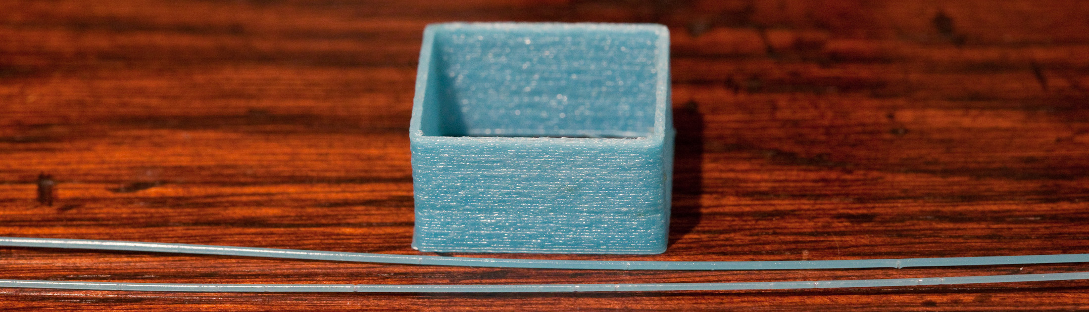

Diameter is 1.70mm. The one thing I printed was the single wall calibration cube and it's kind of mealy... I suppose due to the bumpy filament. Walls came out wide even though I sliced w/filament diam at 1.75 and extrusion multiplier at 1. It's been in the oven about 2 hrs now. So I'll test again before bed.

ok why would you use a different diameter if the actual diameter is 1.70?
A reasonable question. I knew the print was going to be lame anyway because of the bumpy filament and I thought maybe the bumps would make the walls seem wider, so I tried to force them to be more narrow. It's dumb I know, but I wanted to print something before putting it in the oven.
Anyway good news is that the filament is coming out much smoother now. Not perfect, but much better. I have a new single wall box printing now (filament at 1.7mm and extrusion multiplier at 1) and it's practically glossy compared to the first one. Here's the new filament and the first (mealy) single wall box. The new one's almost done. I'll post in a few min.
