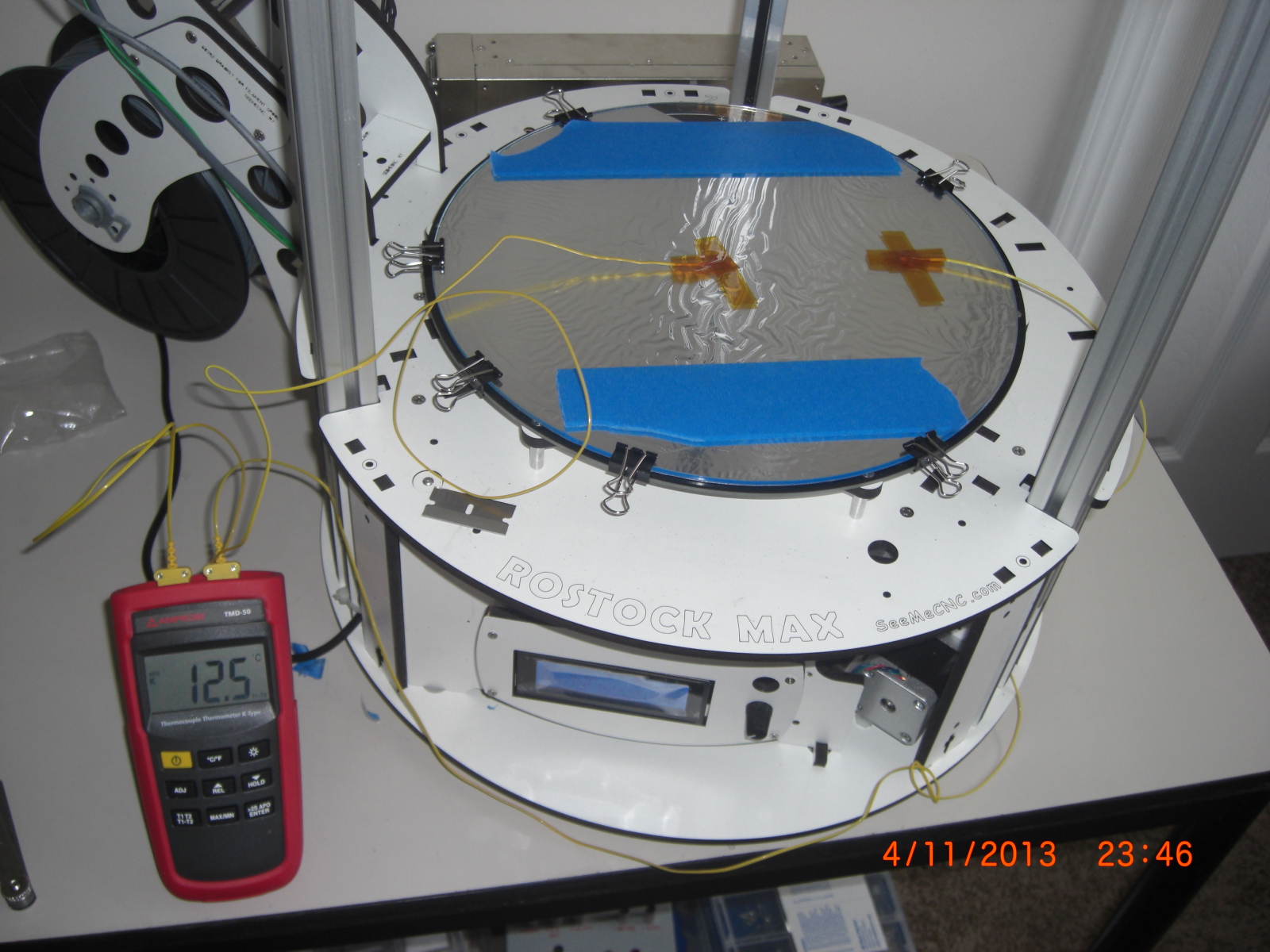

Posted: Thu Apr 11, 2013 12:25 pm
by cambo3d
may try this myself, did you actually measure the temperature differences?
edit: after reading this i did a test of my own i wasn't to impressed. photo shown below with my thermocouple temperature meter . measuring the difference between inside and outside of the top boroglass.
i'm still getting a 10 -12 degree difference. at a bed temp of 85 degrees.

Re: Couple of n00b questions
Posted: Thu Apr 11, 2013 5:47 pm
by mhackney
I did similar tests last year (on my H-1) with:
  • heavy aluminum foil: no measurable difference in heat dissipation
  • .032" aluminum: marginal difference but still had significant high and low temp regions
  • .0625" aluminum: dissipates the heat nicely but tends to cup when heated and is too stiff to hold in place with glass - I broke two 1/8" glass plates testing this.
As for dull vs shiny side of foil: the shiny side reflects heat significantly better. We make reflector ovens to bake on campfires (Boy Scouts) and there is a significant difference in temperature in the oven depending on whether the shiny side is out or not.
