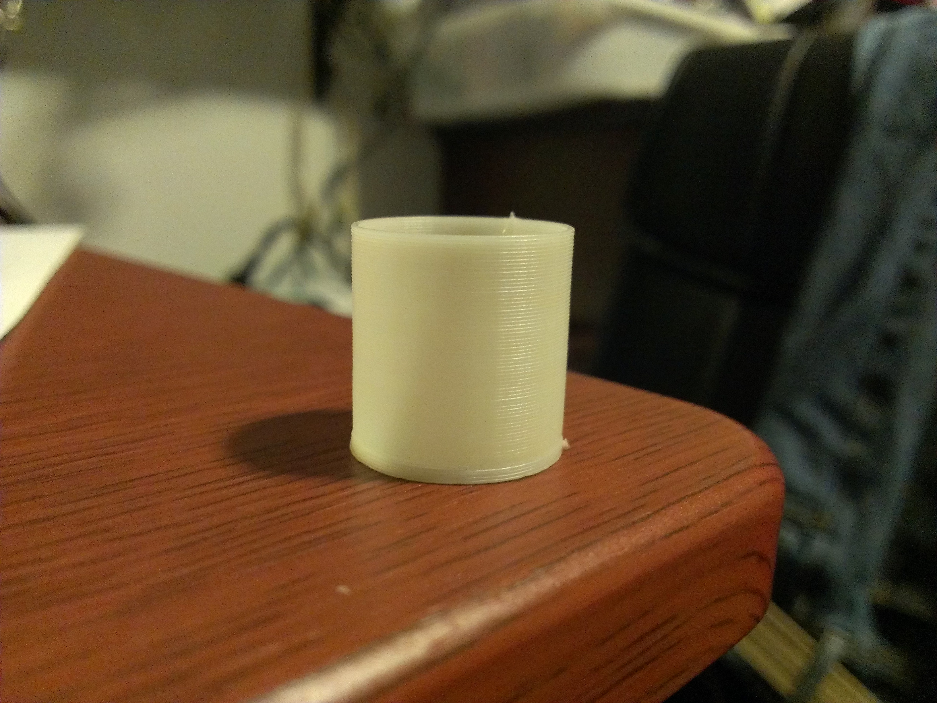

Curiously, I've been successful at printing hollow cylindrical test objects with no shifting at all.
hollow cylinder
hollow cylinder
This was printed at 10mm/s, single wall 0.2 layer height

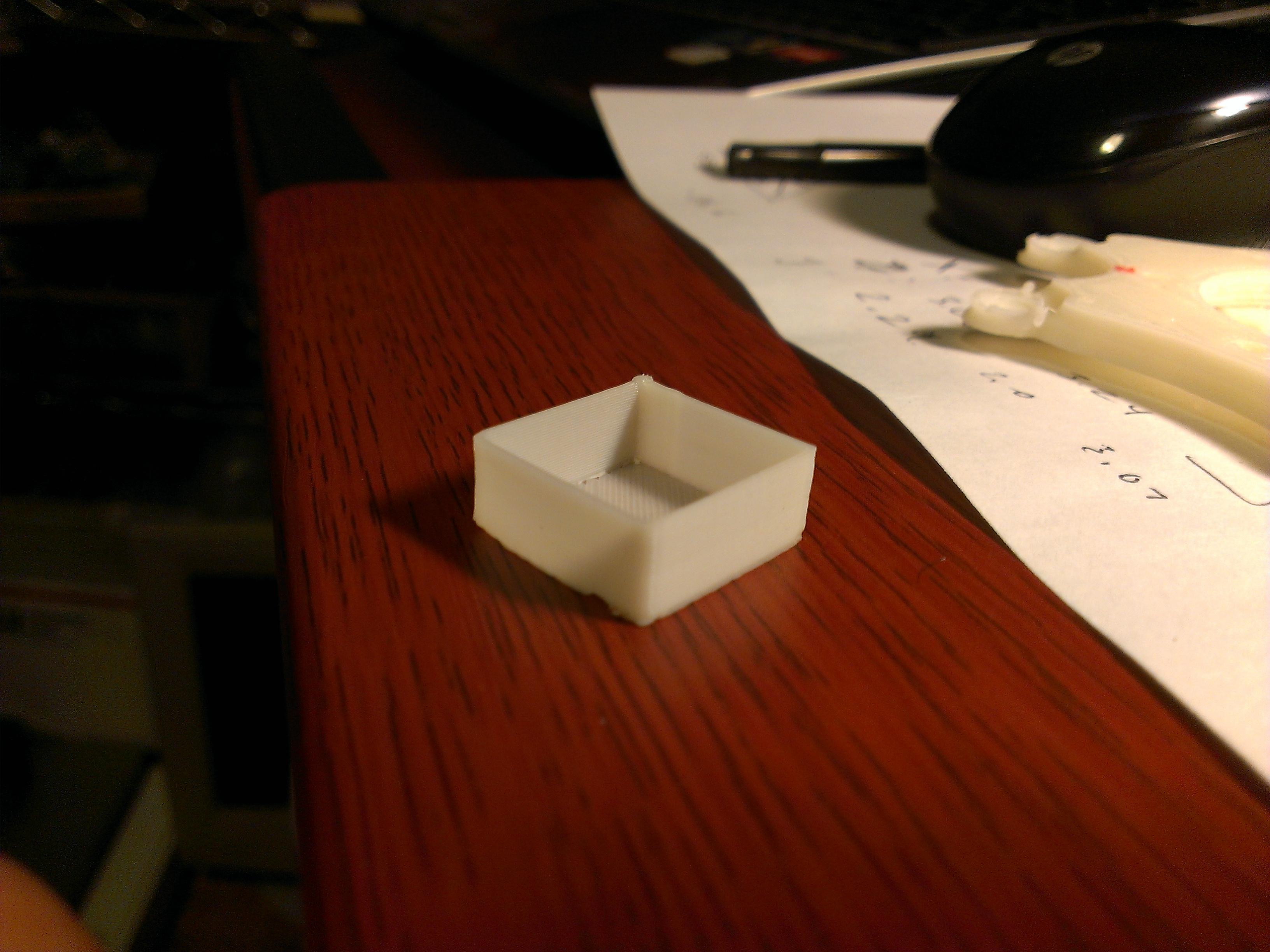

I mentioned earlier that hollow cubes printed ok for me too:
20mm cube
20mm cube

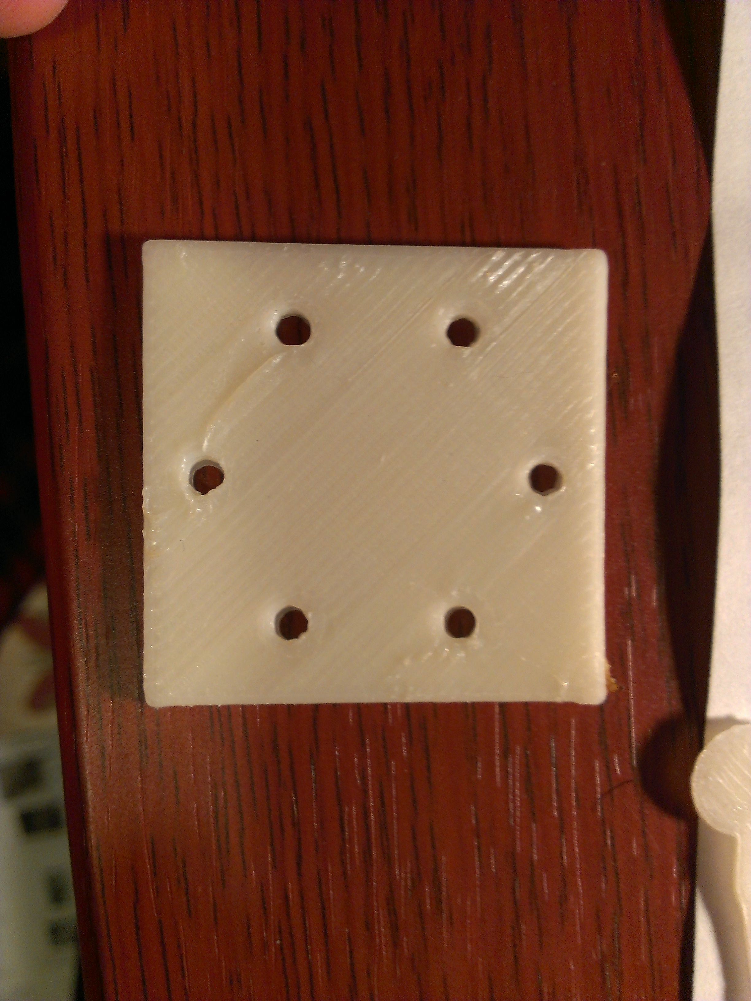

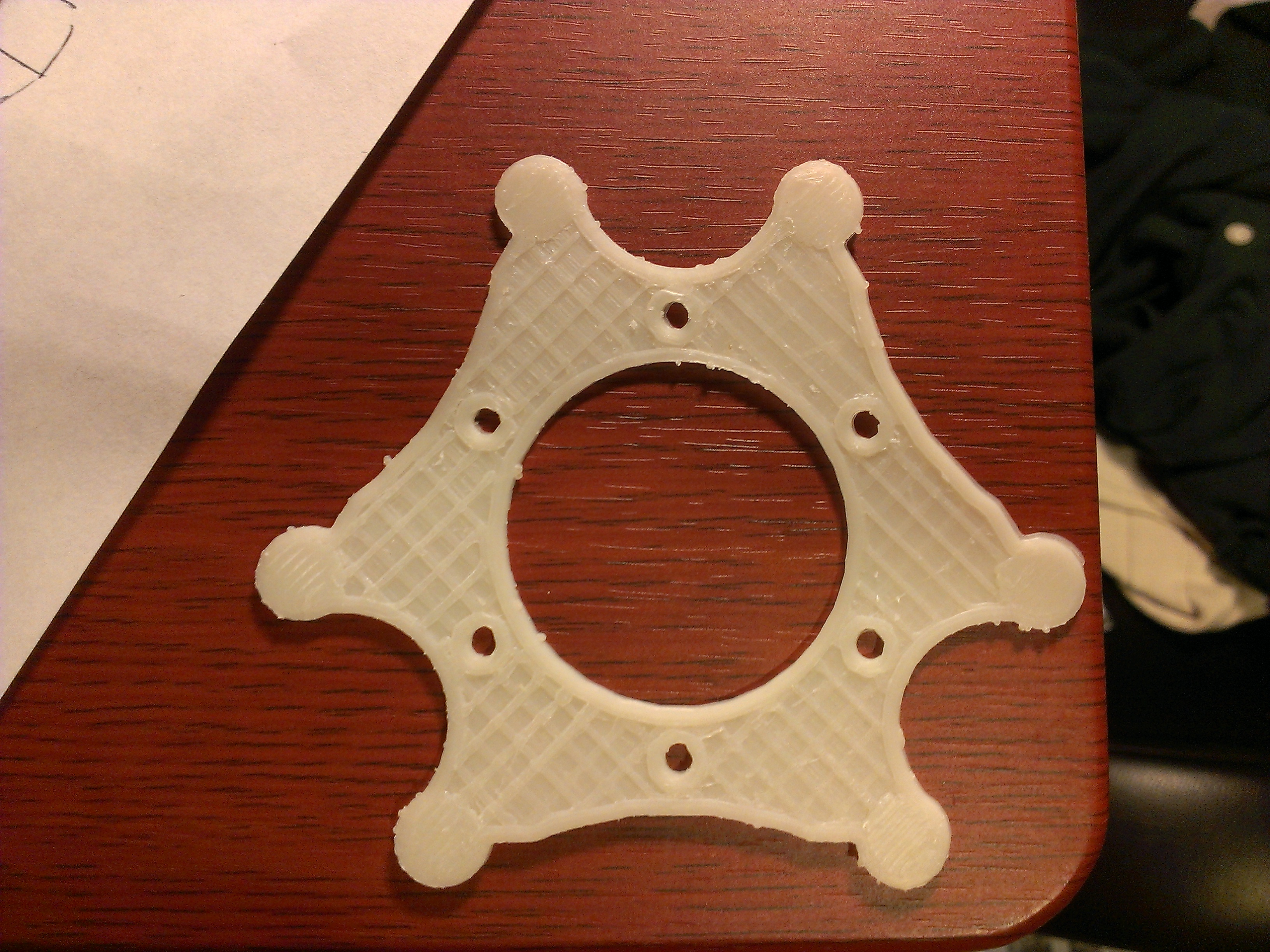

I made a test object that's a 40mm square, with an array of holes to test dimensional accuracy on the printer, but it prints out skewed.
test square
test square
test square2
test square2
You can see the holes between layers don't exactly line up

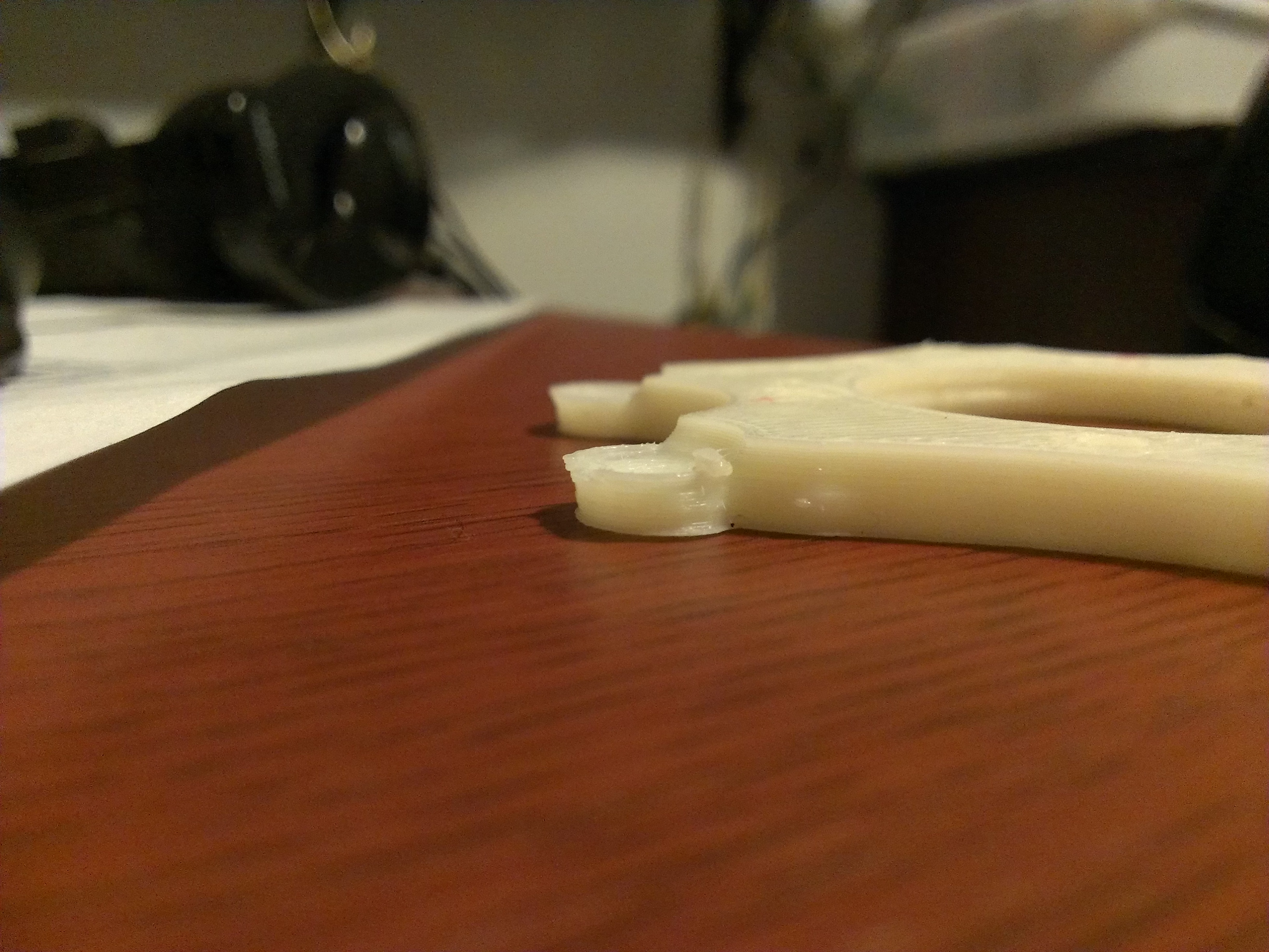

I've designed a hot end platform with divots for steel balls for use with my experimental magnetic joints. Printing that has yet to be successful.
Platform_killed
Platform_killed
This print I killed part way through when I saw the layers shifting. The holes don't line up.
platform side
platform side
This is another attempt. Looking at it from the side you can see the layers don't line up.
I tried adjusting axis accelerations with little affect, I went all the way down to 400mm/s^2 with no improvement with layer alignment. I'm not sure what else to check...
It's weird how the only things I'm able to print decently well are hollow single walled objects. Does anyone see a correlation or a pattern? I think I might contact SeemeCNC for help also.. So far I haven't had a single useable print that wasn't a hollow calibration object, and am at my wits end.

Is the other side of that platform side print skewed inward? If so the orientation of the skewing will tell you which axis has the issue. Maybe try a three pointed star and orient it to match the tower pattern.

If the simple prints don't skew the odds are you're losing steps on rapid movement, because there is none for a single wall print you don't see it there.
Turn down your travel speeds and see if it goes away.

The platform that I printed out is triangular in geometry, and as I stated in the first post, the skew looks like it's pulling toward the X tower. The X tower cheapskates and belts are as near as I can tell the same as the other two. And yeah, where it skews outward, the opposite side skews inward.
