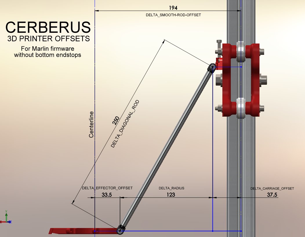

Delta values, clearly show in diagram.
Posted: Mon Apr 15, 2013 8:16 am
by Flateric
I figured that since this diagram helped me out so much it deserved it's own thread. It is from another Delta printer, so do not use these exact values for your own settings.
But this diagram more than anything else made me understand what values related to what on my printer and how to measure them. So I thought I would post a thread about it here.

by Godspeed
Thank you Flateric. I have been wondering if there was such a diagram somewhere. That could be really useful.
