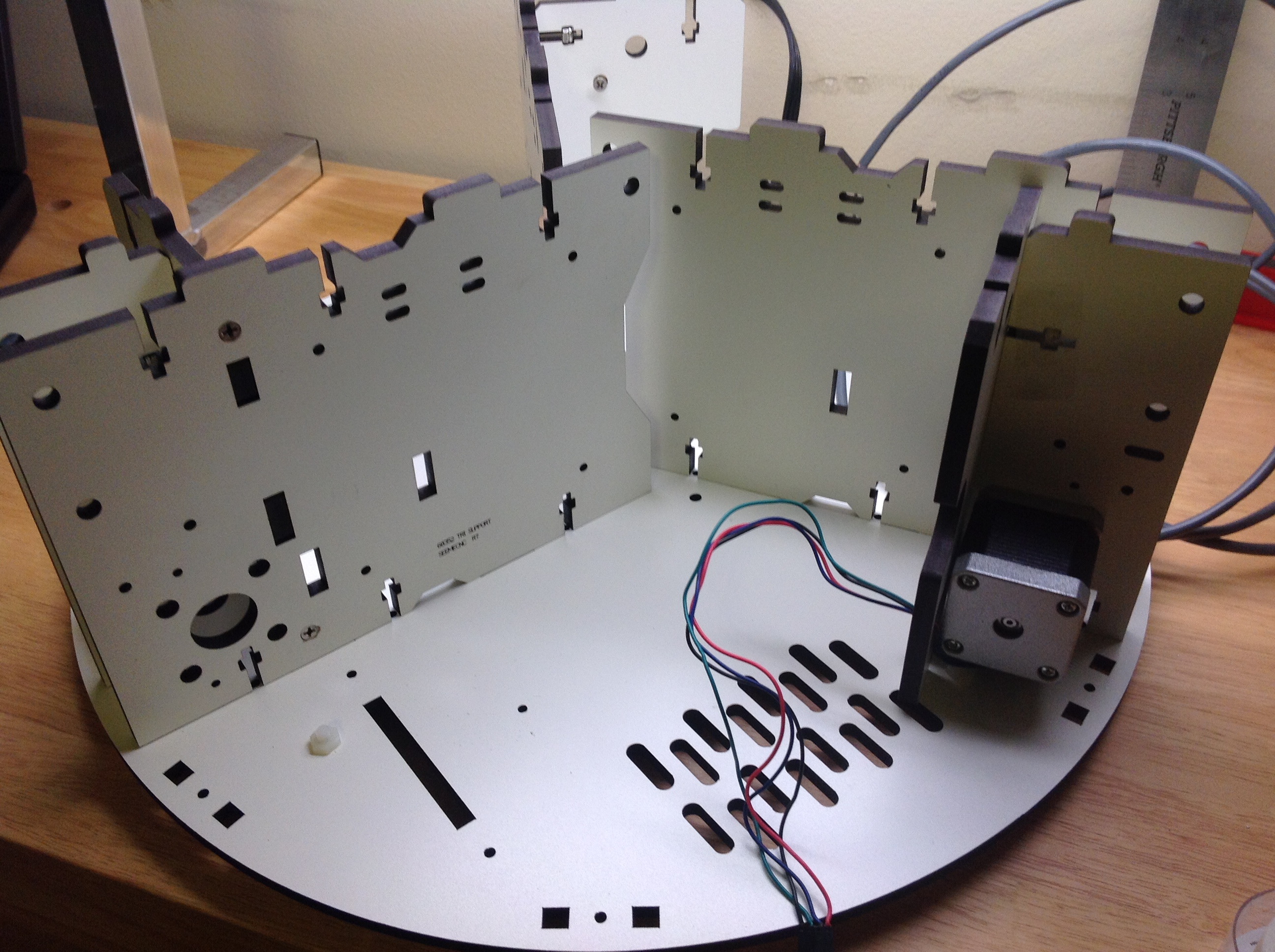

I'm having some trouble getting the power leads to the Onyx bed attached, but I'm going to try again tonight, then i should be able to mount the power supply and Rambo board.

Re: A n00b builds a Rostock Max
Posted: Mon Apr 15, 2013 3:57 pm
by Eaglezsoar
Thanks for the great pictures. I am confused, in your first pictures your top piece for the base says "Rostock Max"
printed on it then in your later pictures with the base built I no longer see the printing. What's up with that?
Posted: Mon Apr 15, 2013 5:02 pm
by cpunches
Eaglezsoar wrote:Thanks for the great pictures. I am confused, in your first pictures your top piece for the base says "Rostock Max"
If you click for the full image you can see it along what is the left edge. Thanks for making me panic and worry that I'd somehow put it on upside down or something! :lol:
Posted: Mon Apr 15, 2013 5:35 pm
by Eaglezsoar
Yea, it's the picture that shows the doors open where I don't see it. Glad to see it's okay, just trying to be sure there was
no problems before you got too far along. Sorry for the panic attack but you need your heart too pump fast now and then.
Looking forward to the rest of your build.

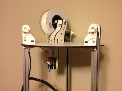

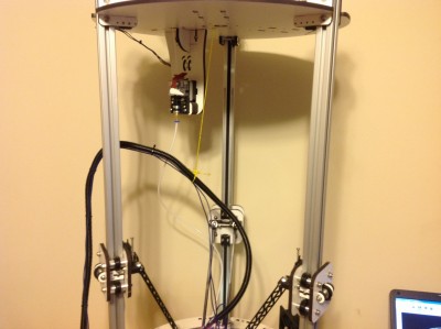

Posted: Wed Jun 12, 2013 9:52 pm
by cpunches
I added the EZ-Struder and the top mount. I really need to find a better way to route these wires.
Posted: Thu Jun 13, 2013 5:05 am
by Eaglezsoar
Man, those leds would blind you if you stared into them.
Great job in getting this far and thanks for the pictures, this
is the first time that I've seen the Seemecnc top mounted spool holder.
I wonder why they didn't put the spool between the uprights instead of
hanging it off the side. Hey, it works and looks good who am I too judge.
Thanks for all the pictures, I have been following along and enjoy reading
your posts. Neat use of the mason's line to hold the wires.
Posted: Thu Jun 13, 2013 6:05 am
by cpunches
Thanks guys.
Yes, those LEDs are really bright! ;)
I'm sure it's around somewhere but I couldn't find an assembly guide for the top mount anywhere so all I had to go by was the photo on the page where you order the mount. For all I know I put it together wrong, lol. But it works just fine. I'm still considering shortening the bowden tube a bit. I really want to run all the wires from the hoted up through the center hole on the top plate and then down over the side - but I'd need to extend all the wires and I really don't like the thought of doing that at this point.
