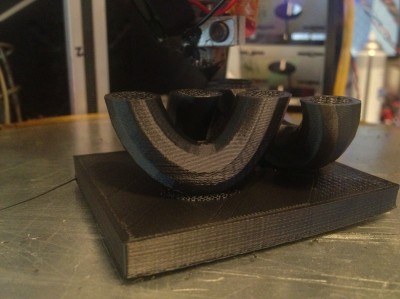

Not a whole lot new, some higher res layer testing, come combining of prints just for giggle and well, here ya go!
twisty_red_1i
twisty_red_1i
Re: Flateric's Prints and Tests collection
Posted: Sun May 26, 2013 12:40 pm
by Flateric
Fresh off the printer as is, no cleaning of any kind.
[youtube]http://www.youtube.com/watch?v=v70zxRliqMg[/youtube][youtube]http://www.youtube.com/watch?v=dbUsH-l79X8[/youtube]
The point it was at when I found it running this morning.
Printed in ABS with no support at a layer height of 0.18mm. Partially inspired by E3D hotend homebrew all metal hotend. Stock extruder. Nozzle size is 0.35mm.
Skin thickness .3, 5 loops, layers .18, extrusion width .35, infill width .35
Approx print speed for infill is 300% of 80mm sec. Perimeters printed at 300% of 45mm sec. Infill was 33.3% rounded.
Prime 5 suck 5 wipe 10, Speed 18, min jump 6, triggger 30.
Total print time was just a hair over 5 hours.
Original object scaled to 1.75 times original scale.
Black seemecnc ABS was at 225 for the duration of the print. Printed onto bed @95c bareglass with hairspray. Added duct tape "redneck" safty hold down just moments before this video shows. Just in case. Proved to be completely un-needed as part was difficult to remove from the bed at print completion. But you can never be too safe and I have had it save me ass in previous prints.
