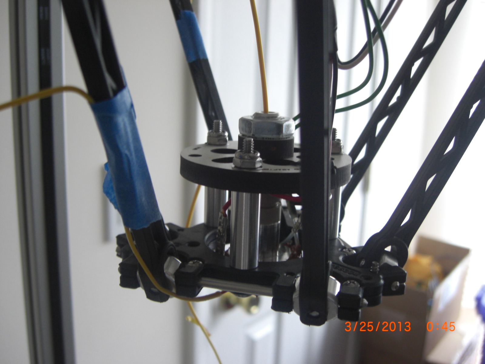

I tested mine inside the nozzle before I feed any filament through it. I found that testing it from the outside gave me inaccurate nozzle readings and was nowhere near the set temperature.
measuring outside of nozzle http://forum.seemecnc.com/viewtopic.php ... =140#p7612 not so accurate
measuring inside of the nozzle http://forum.seemecnc.com/viewtopic.php ... =150#p7740 more accurate
those yellow wires you see at top and the bottom are my two thermocouple sensors.

You'll have to pull the ptfe tube out to fit that in the hole.
