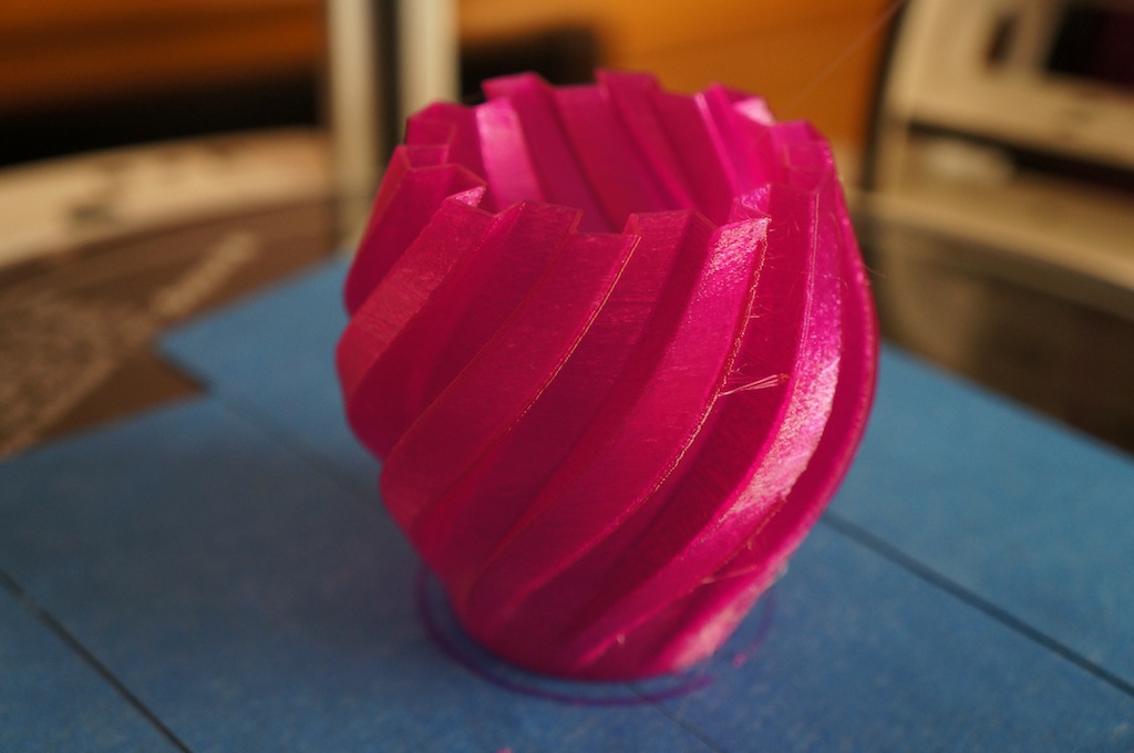

Finally got mine, set it up this weekend
Juries still out on it, this was my first successful print
More detail in my blog for anyone that cares.

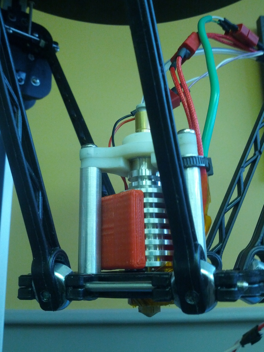

My E3d hot end arrived and I hooked it up today. I made some taller standoffs and mounted it on top. The nozzle currently sits 2.5mm higher than the Max nozzle, but the standoffs can probably shortened a couple of mm and it will still fit above the stage. I ended up using http://www.thingiverse.com/thing:57889 to mount it.
I'm using ABS and it seems to be printing fine. I don't know if its less pressure to push the filament through the hot end or the smaller nozzle size (.4mm), but the extrusion starts coming out of the nozzle quite a bit quicker at the beginning of a print.

Eaglezsoar wrote:Can you tell me the length of the standoffs you made?Broose wrote: My E3d hot end arrived and I hooked it up today. I made some taller standoffs and mounted it on top. The nozzle currently sits 2.5mm higher than the Max nozzle, but the standoffs can probably shortened a couple of mm and it will still fit above the stage. I ended up using http://www.thingiverse.com/thing:57889 to mount it.
-B
They are 1.73in/44mm in length. I drilled and tapped both ends so I wouldn't have to find really long 6-32 bolts.
Edit: I checked with a feeler gauge this morning and i could shorten the standoffs by 1.5mm and the fan would still fit correctly above the platform. The length can therefore be 1.67in/42.5mm. Then the nozzle would only be protruding 1mm less than the Max nozzle from the bottom of the platform (at least on my machine).

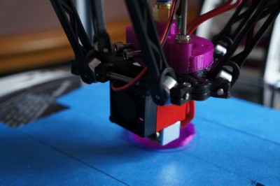

I received mine last week and I am really happy with it. I have noticed that I'm getting cleaner prints even though I've reduced the retraction from 6mm to 4mm. With the stock hotend I was seeing occasional variances in the extrusion width, especially at higher speeds when doing infill or just after retractions. I am not having that problem so far with the E3D hotend. So far I have only used it with ABS, but I'm planning to order some PLA and nylon to see how well it works with other materials.
If anyone is interested, I've designed a mount specific for this hotend and the Rostock MAX:
E3D Hot End Mount for Rostock on Thingiverse
[img]http://i.imgur.com/uisT7pgl.jpg[/img]
I was using this one previously, but the height of the grooves on the E3D did not match up so it was slightly loose:
With the new one that I designed the fit is tight and there is no play at all, plus it has a hole through which you can route the wiring.
