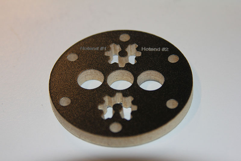

Igot my rostock max with dual extruders but found that I can not mount both. With both mounted the extruder tips will not go through the opening in the platform. If I assemble the extuders around the platform then the 1" supports won't fit! I was thinking I could go to a 1/2" support but will I slam the extrder tip into the hot plate because the tip is lower?

can you post a pic of this, you have to use to shorter spacer due to hotend design. then readjust your z height once you have it installed.Tanks-A-Lot wrote:Igot my rostock max with dual extruders but found that I can not mount both. With both mounted the extruder tips will not go through the opening in the platform. If I assemble the extuders around the platform then the 1" supports won't fit! I was thinking I could go to a 1/2" support but will I slam the extrder tip into the hot plate because the tip is lower?
http://www.tricklaser.com/Dual-hotend-a ... RM-DHA.htm

Is it possible to get the dxf for that mount?
There should be enough scrap left from the leftovers to mill it myself

I found the files on github and have made the files for the mill. Will post a picture when milled

Finally got the time to mill
If anyone wants one or wants the files, let me know.

Nice job! what are the gear shaped cutouts for?
Re: Dual Extruder
The gear outlines are the Open Hardware logo.
Essentially means, "this design is open source, enjoy it, hack on it, improve it!"

Cool! Can you share the link for the file? Any tips on working/setting up the duals? as I plan on working on it this weekend.
Re: Dual Extruder
not to sound like a salesman here. but i could make these in aluminum so it acts as a heat sink to the hot ends also.
mine gets fairly warm at printing temperature, using a fan with heat sink mount will help dissipate the heat off better.
if you want to make one yourself here is a dxf file for mine.
