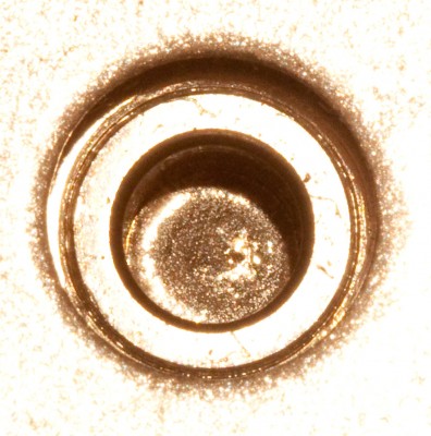

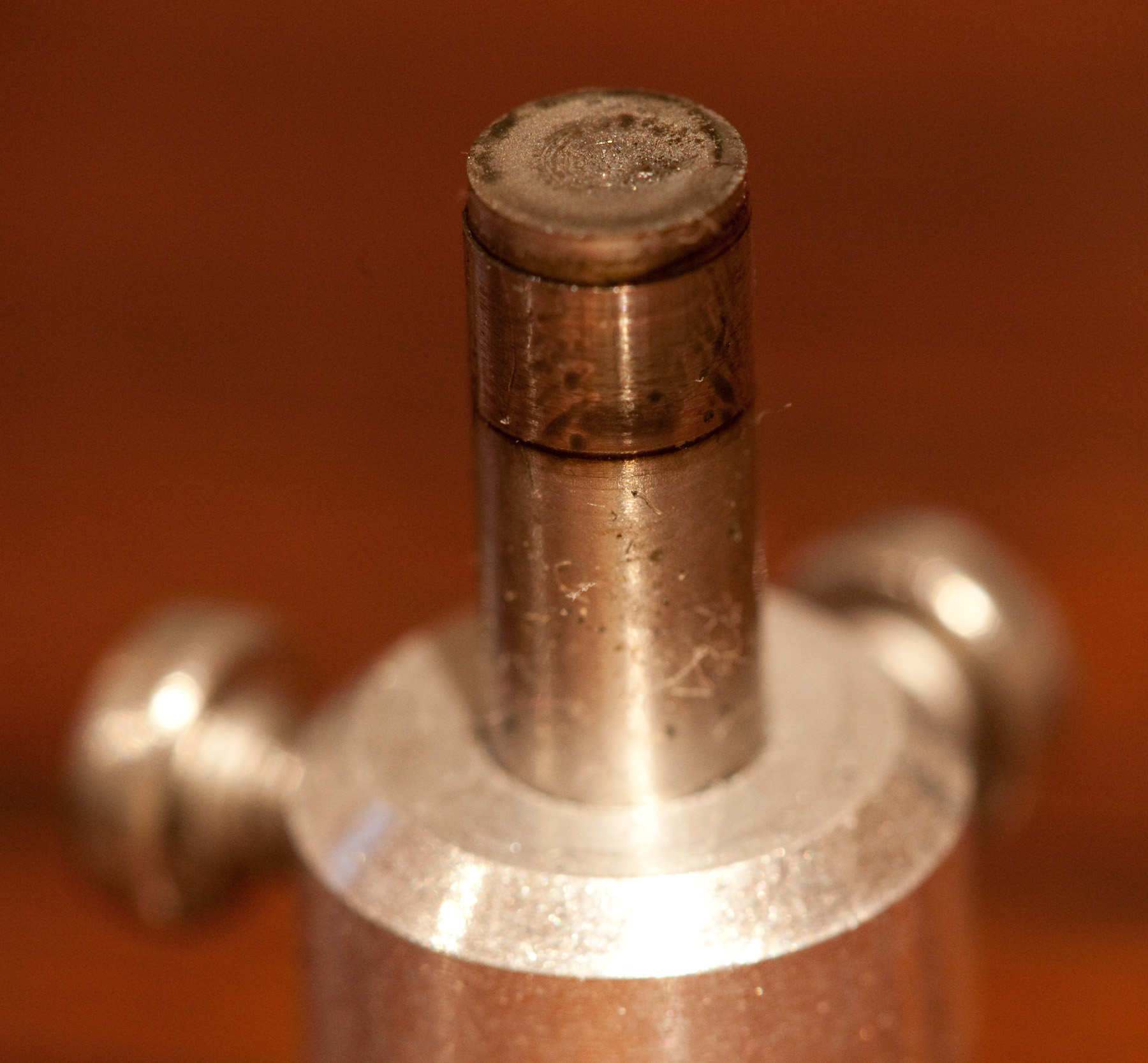

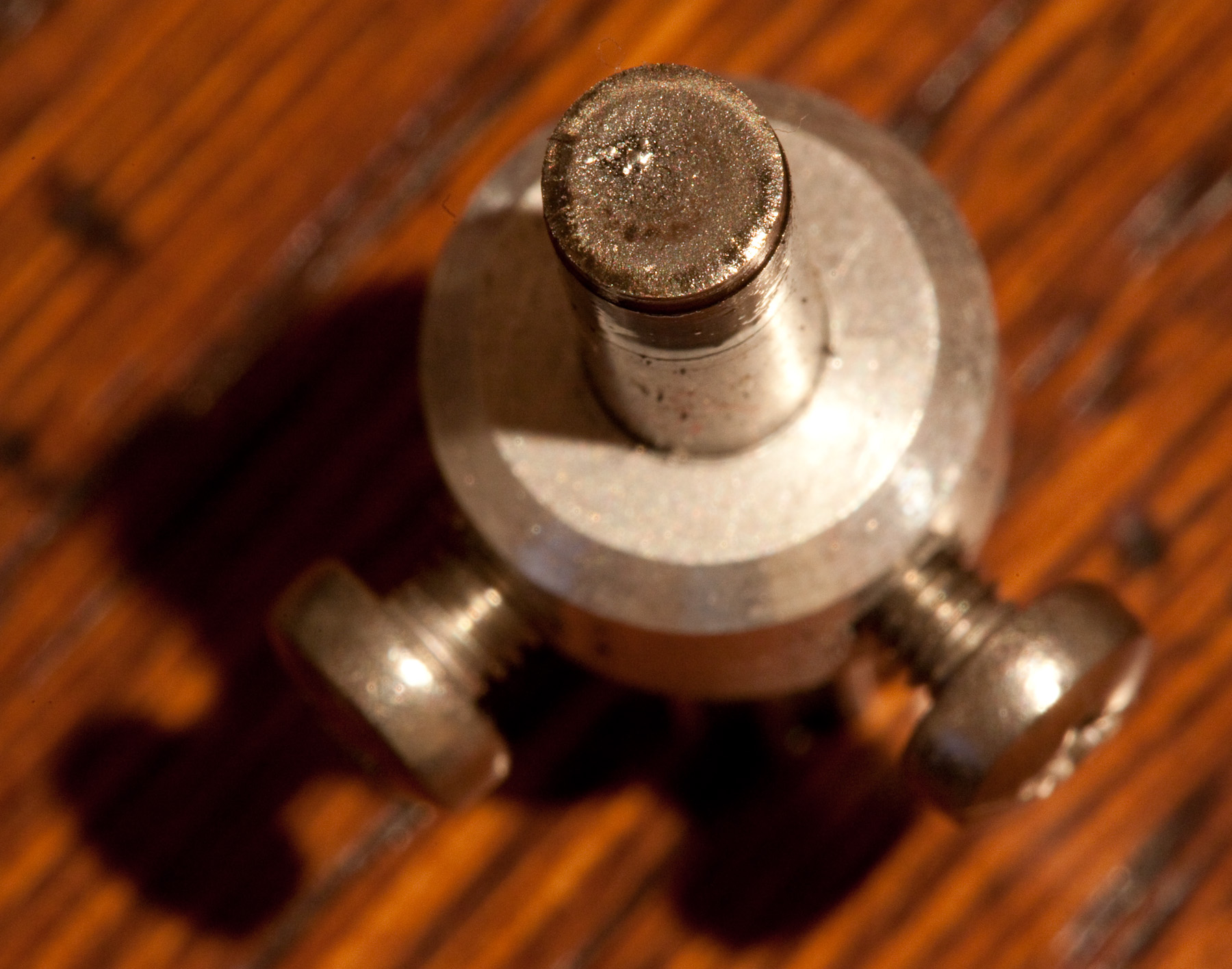

So I'm printing along fine and on my third print of the day. I come back in to the room to check on it and the z carriage isn't moving. I abort the job, try a G28 and z does not move.
Tried testing the board and wires and the problem seems to be the motor. I was hoping maybe the pulley was slipping. Went to investigate the pulley and the shaft came out.
Any ideas why this would this happen? It did not appear to have crashed anywhere, but I wasn't watching.
I'm guessing the fix here is to buy a new stepper motor. Any suggestions for a good source?
Here's a shot looking in where the shaft goes.

I have never seen a stepper fail in the manner yours has, but you never stop learning. You could try to epoxy the shaft back in there but I would not trust it. Buy the new one.

that's definitely a manufacture defect, there's no way that a rostock/3d printer could do that..
Re: broken stepper shaft
Cambo3D is correct and you should attempt to get a new one from Seemecnc if the purchase was within the last year or so.

I'm quite sure they'll replace it. It's obviously a metallurgical defect in the shaft.

I've only seen this one other time and that was on a nema34 stepper that was brand new. It was also a manufacture defect.
There is no possible way epoxy would ever work in that spot.
Glad the see me guys are on top of things and always doing the right thing though.
The nema34 failure I witnessed was not pretty and not safe. It was mounted up on a very largish knee mill and caused a head crash, broken expensive bit and burned out a driver board on two other axis. The motor maker only covered the motor of course.

FYI Barnett.....I was watching that print. It did NOT crash into the bed. Definitely defective stepper...
