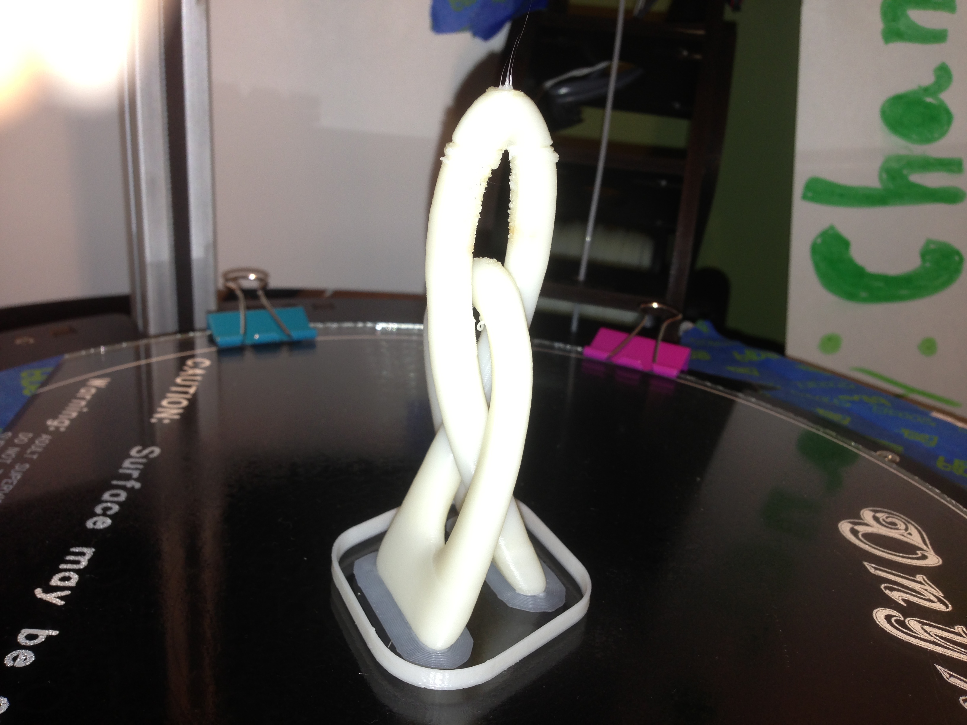

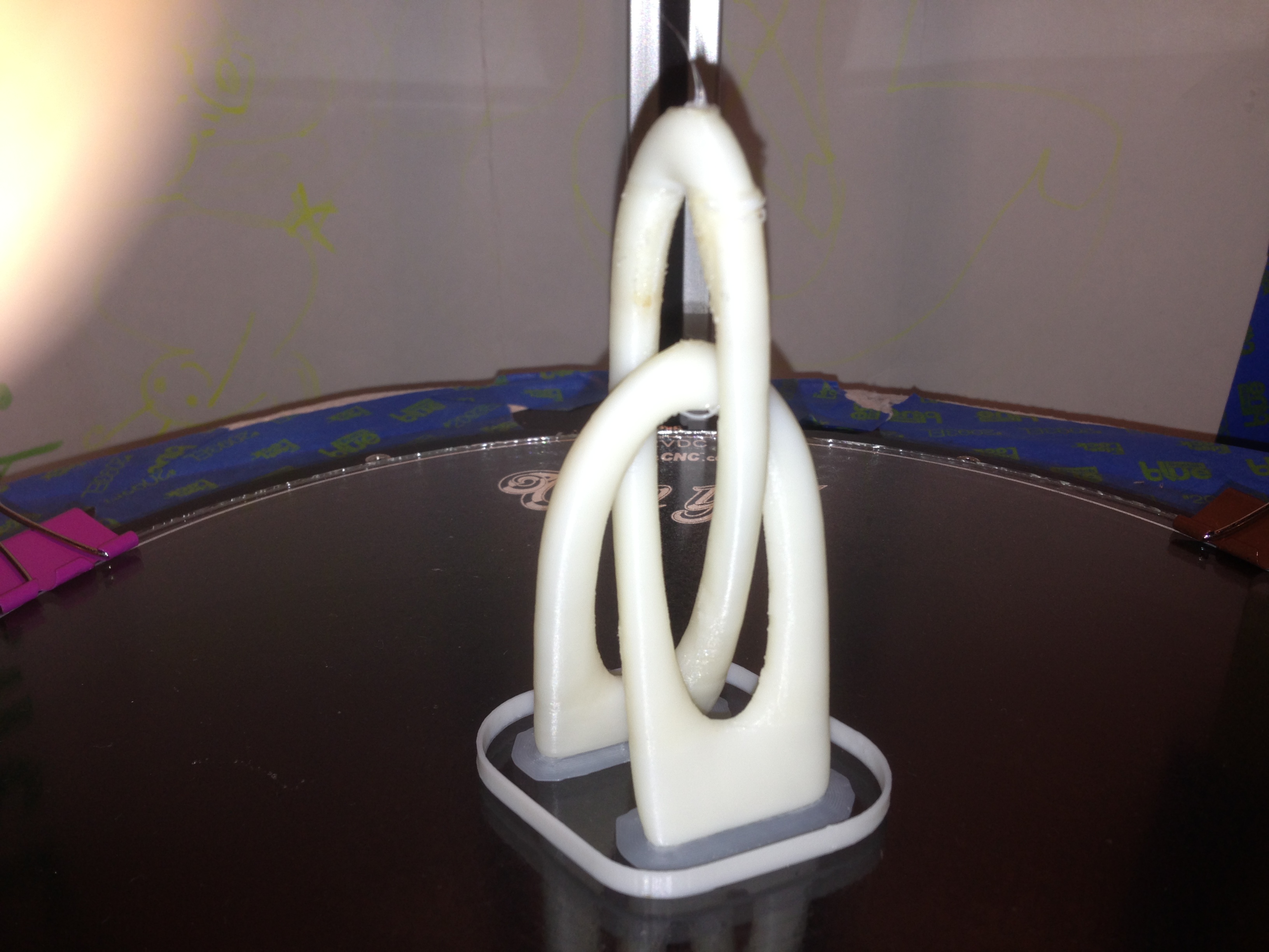

This sculpture can be found on Thingiverse under Vica Sculpture. It's such a nice print I had to post it here. Sliced with Slic3r at .20 Layer height, .25 first layer, .10 % infill, 45% speed, Skirt 2 loops 8mm from object 20mm skirt height, 5mm brim, no support, 2 raft layers for adhesion, Filament at 1.80mm diameter, 230 C Bed at 110 C, .40 nozzle diameter, Retraction at 5mm, lift z 1.5, retract speed 35%, min travel 2.5. ABS plastic filament.
elqisqeyano
Posts: 256
Re: Thingiverse Vica Sculture. So nice I had to Post!
Post by elqisqeyano »

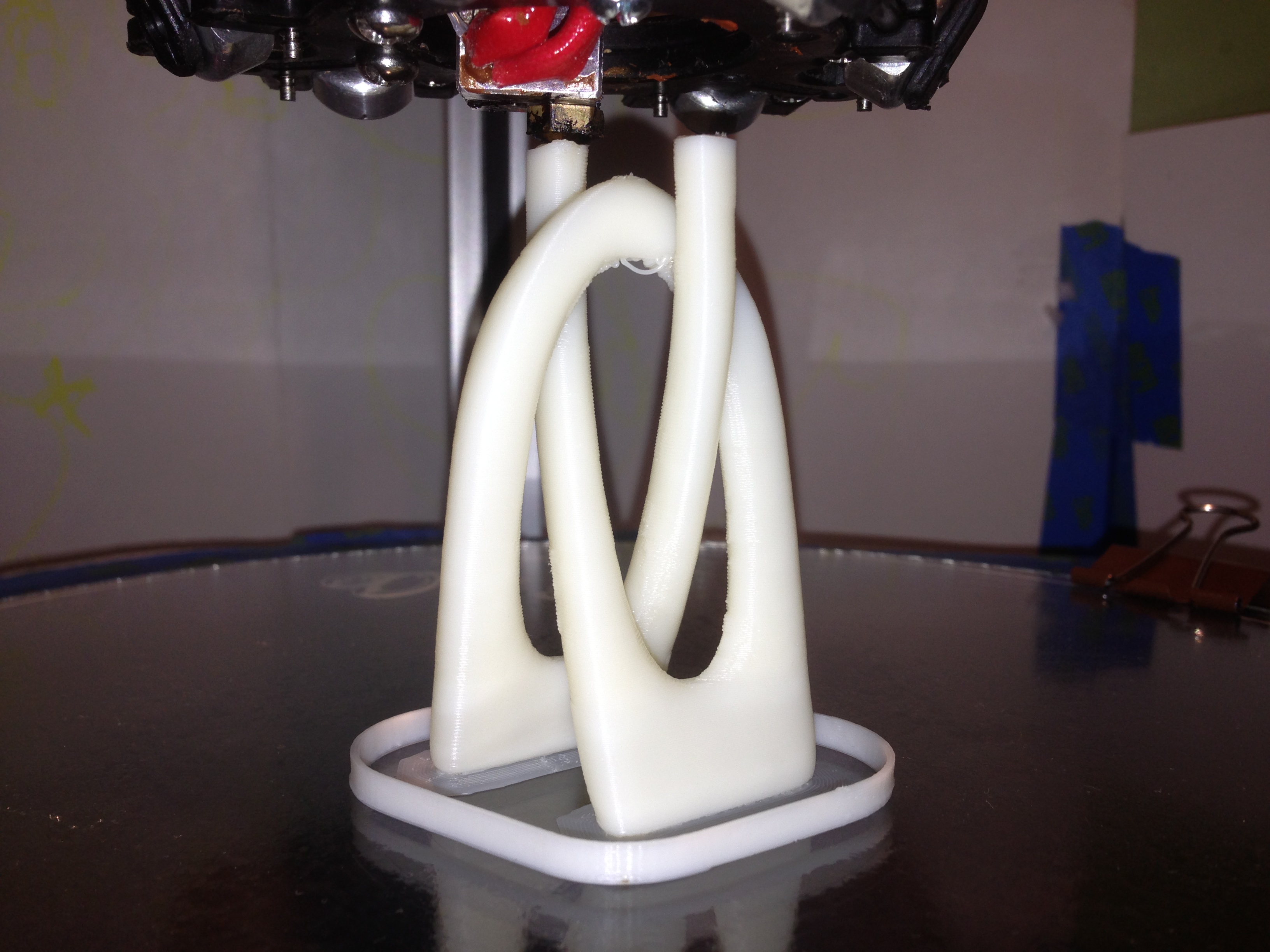

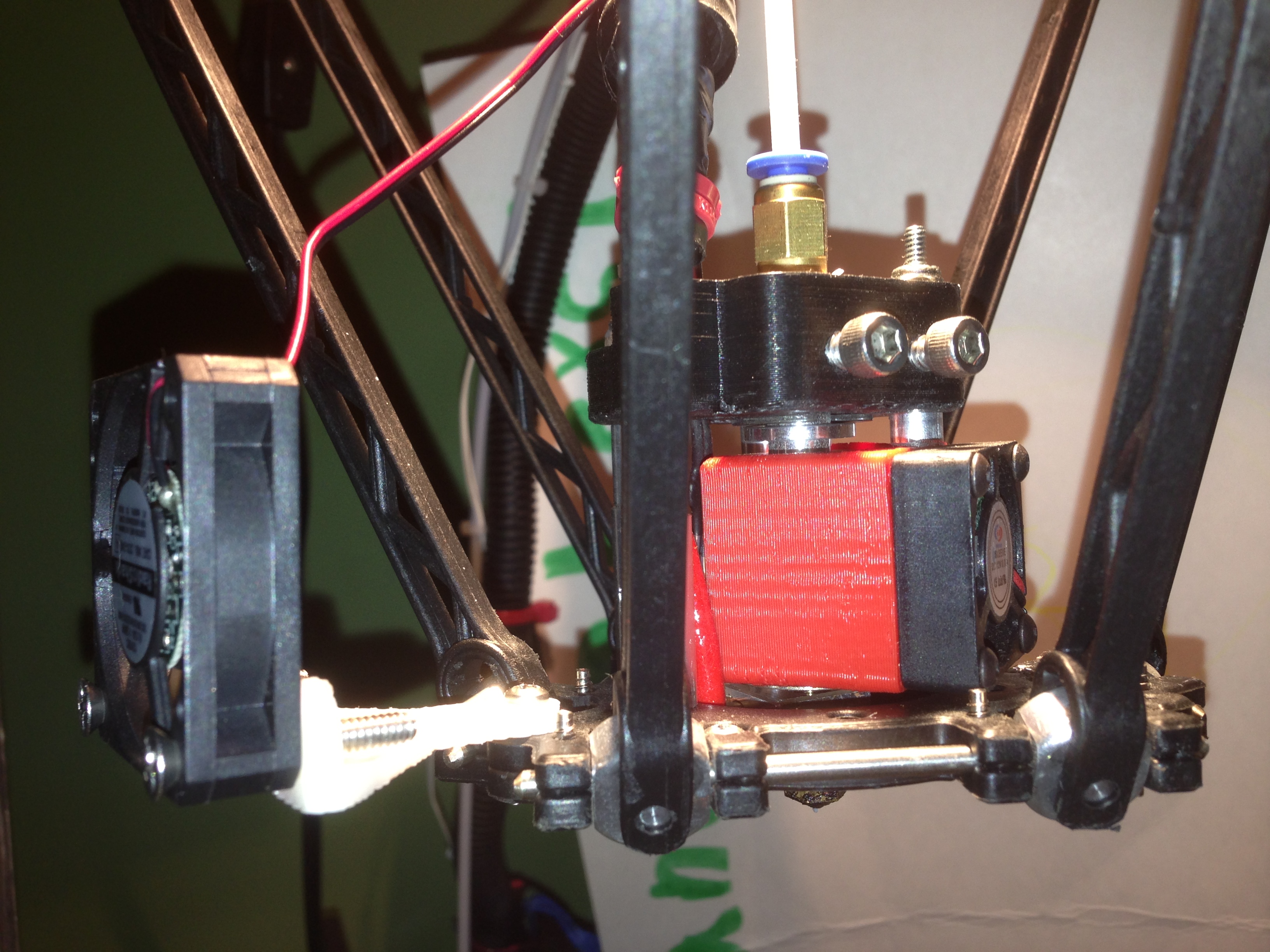

I will post final pick when done. My hot end is the E3D All Metal Hot End with cooling fan on 100% all the time. I have been trying these kinds of print in the past but could not get the Rostock to do it till I found I had forgot to tighten up my Cams to the Rail, I was surprised I got prints at all. When I tightened these Cams finally, I started getting really good prints, this being one of my best.

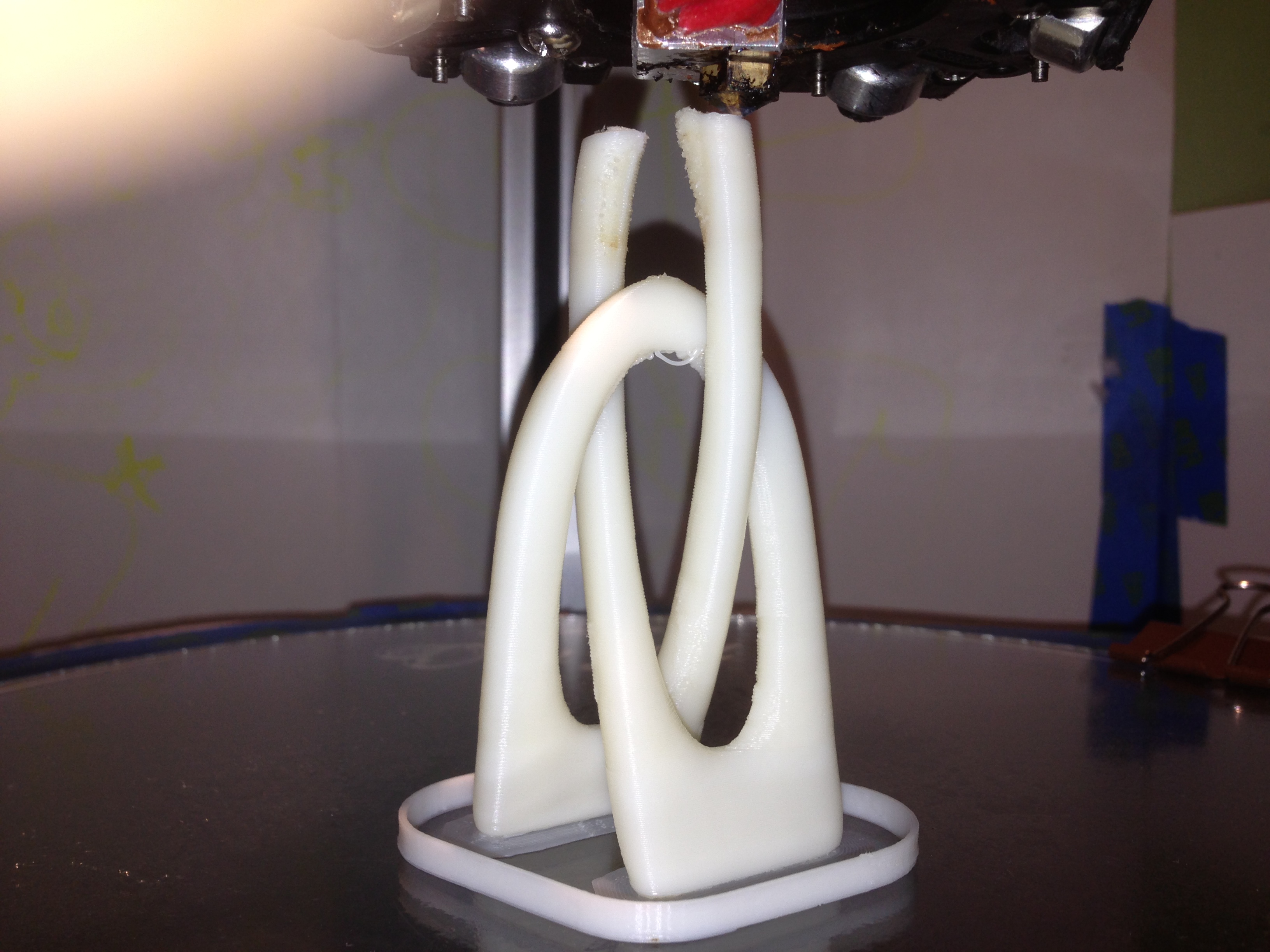

Here are more progress pics...

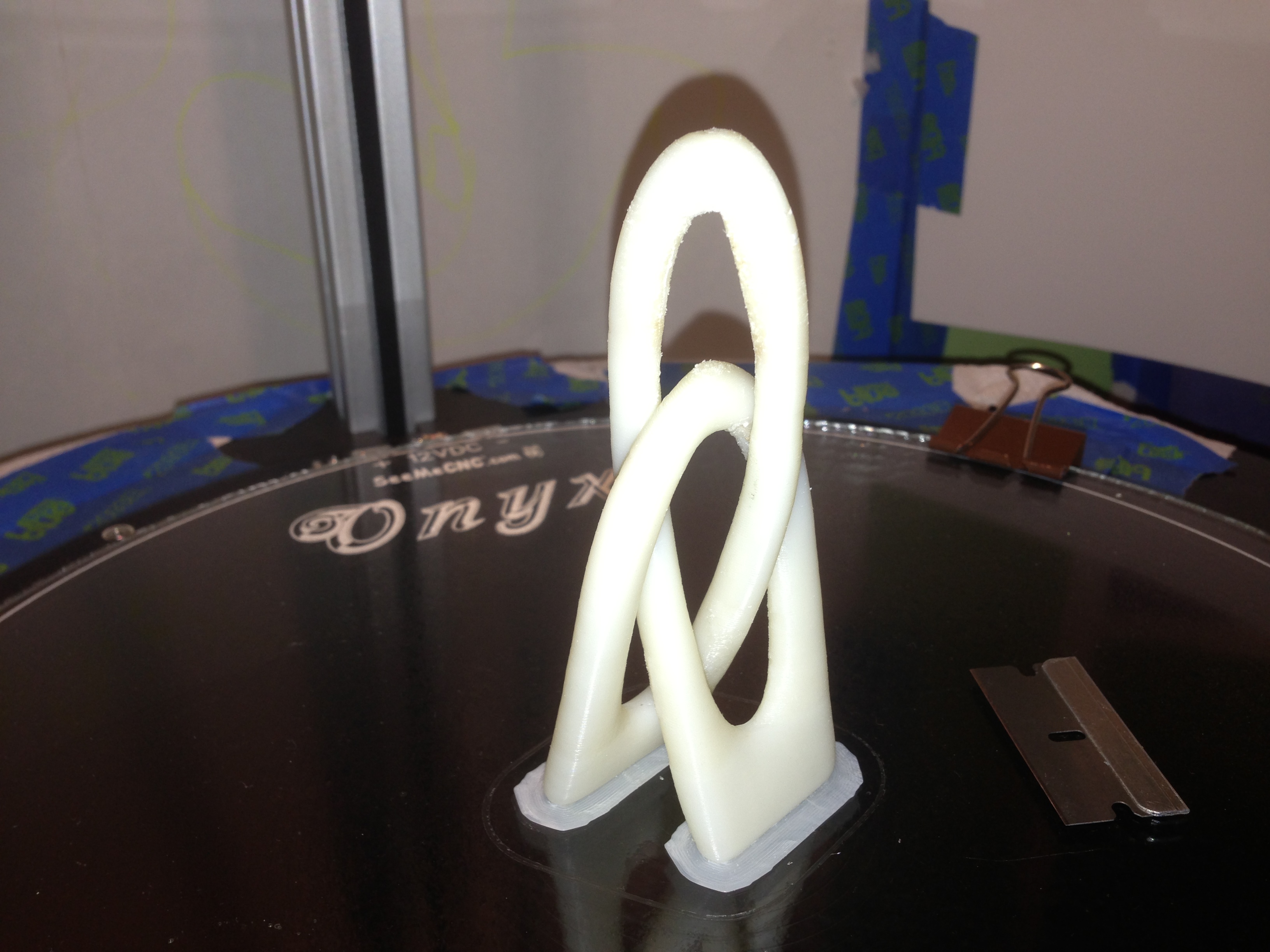

Here it is finished after some minor sanding...
Very nice! And some say it can't be done without a direct drive extruder. I think you prove that it can be done.
I you don't mind answering a couple of questions....Which Thingiverse item did you use for the mount of the E3D and
what length of spacers did you use? Thanks, great job. Remember to tighten those cams! :)

Here is the file, made by Richrap... The only reason it got a bit smoochie towards the top is because I think I had too much smooch and the slim tower arms move as it was printing, I had to hold on to them until they finally bridged at the top.
I used 1 1" aluminum spacer and 1 1/2 " aluminum spacer from home depot for a total of 1 1/2 " spacing. You need 3" screws with that adapter, use lock washers with nylon lock nuts too. From the tip of my nozzle and the bottom of the head platform it's 14mm, giving me a total Z height of 376.3175. The E3D all metal hot end, if installed properly, will extend your Z height significantly. Plus the prints from this all metal hot end are stunning. Must keep fan on all time, otherwise filament gets clogged.

I downloaded the file and I have one more question. If it appears stupid don't laugh too hard.
Those two bolts sticking out the back, I assume that these are what holds the hotend? Do those
holes have to be tapped? See, I told you it was stupid but my momma always taught me to ask if
you're not sure about something.

Not a stupid question at all. They don't need to be tapped. I just printed the part, cleaned it out and inserted those screws in they tap themselves straight in. The hole will be printed out just fine. If you want to tap you can, those 2 holes on the side are what holds the J-Style hot ends in place. If you tap, do not tap all the way through, just enough so screws don't push so much plastic onto the hot end.
