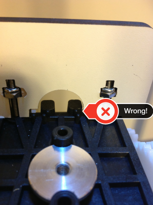

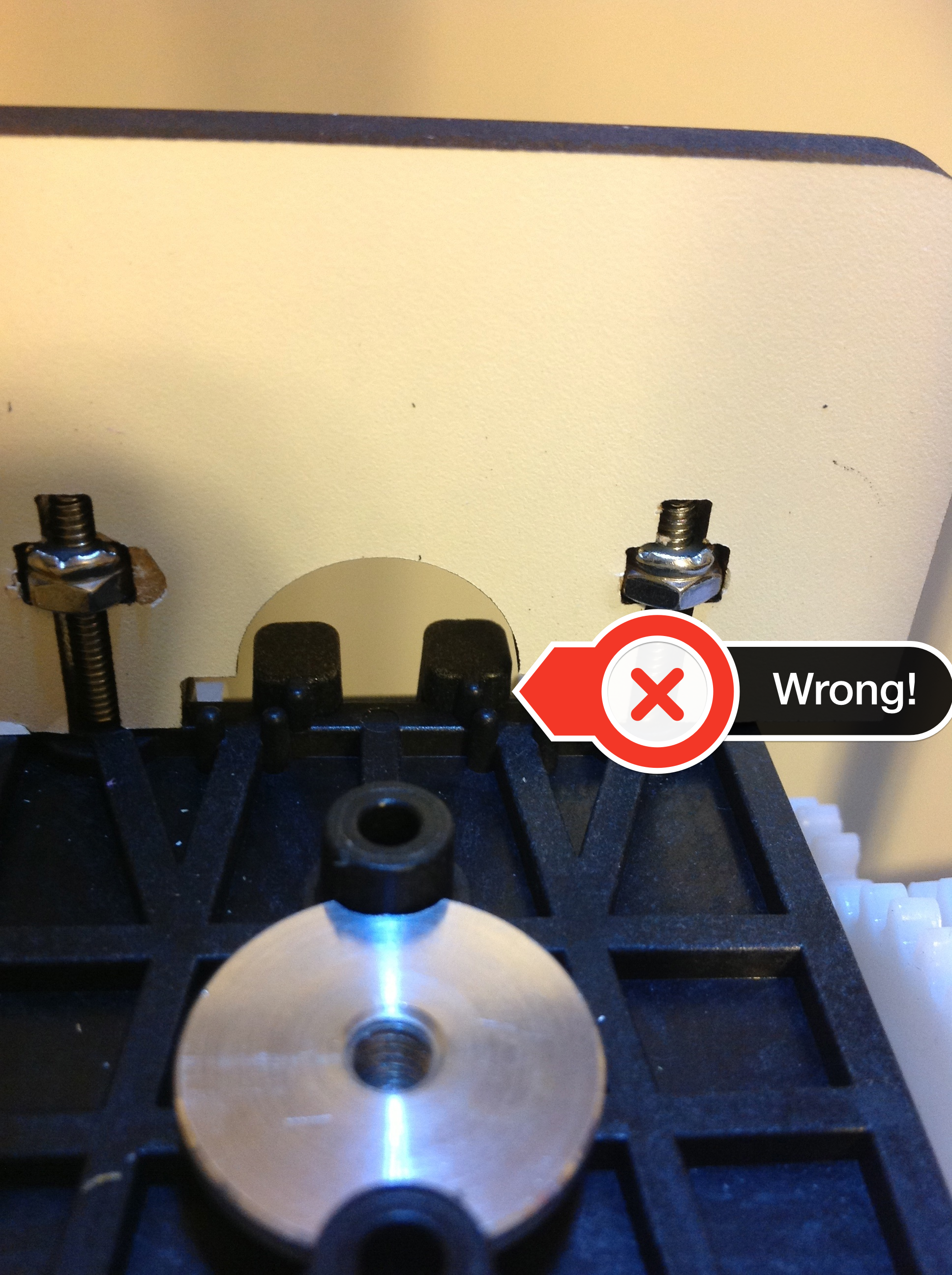

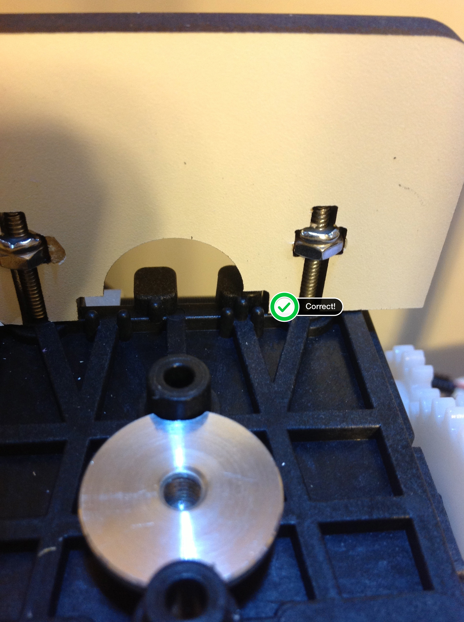

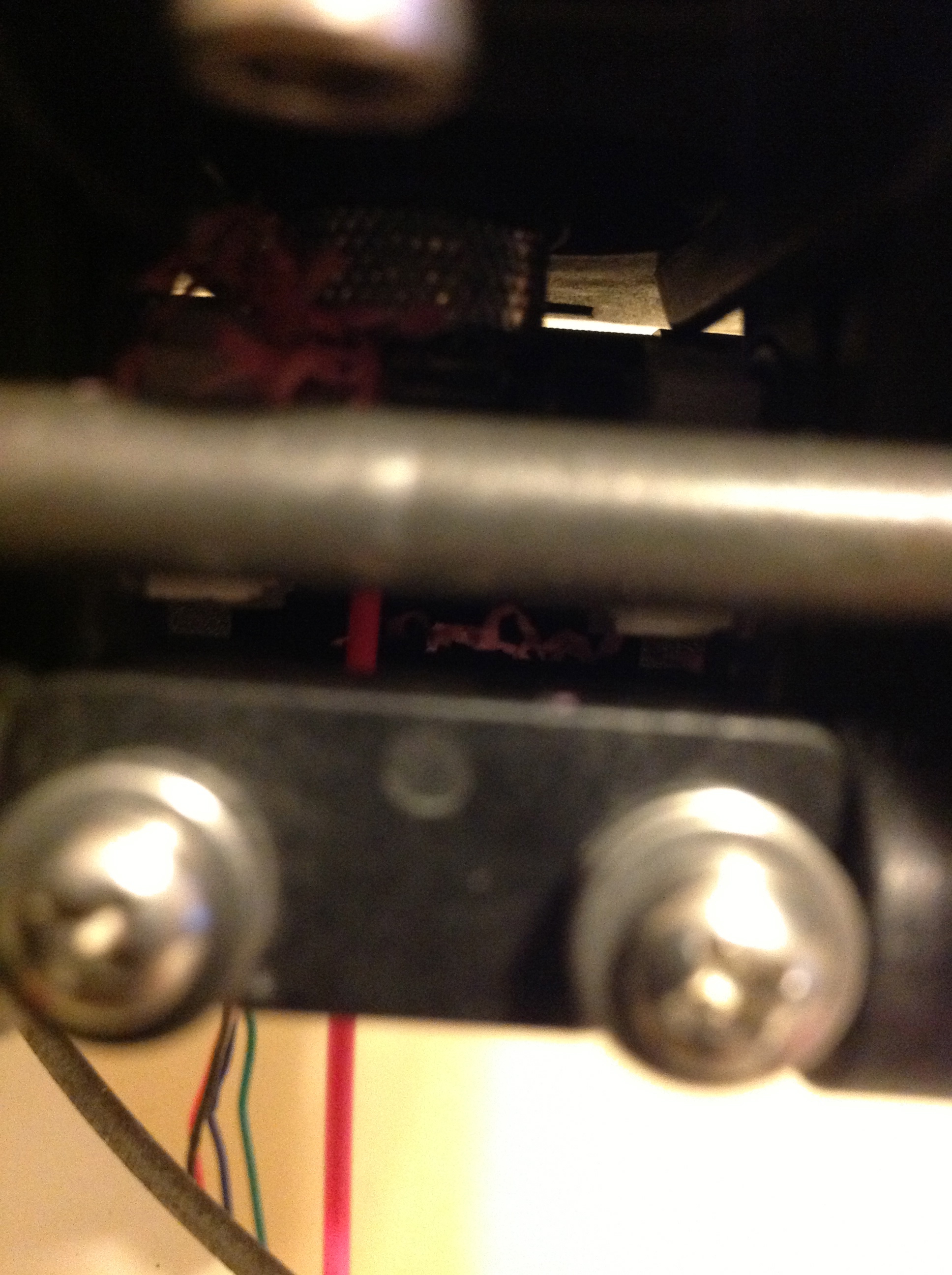

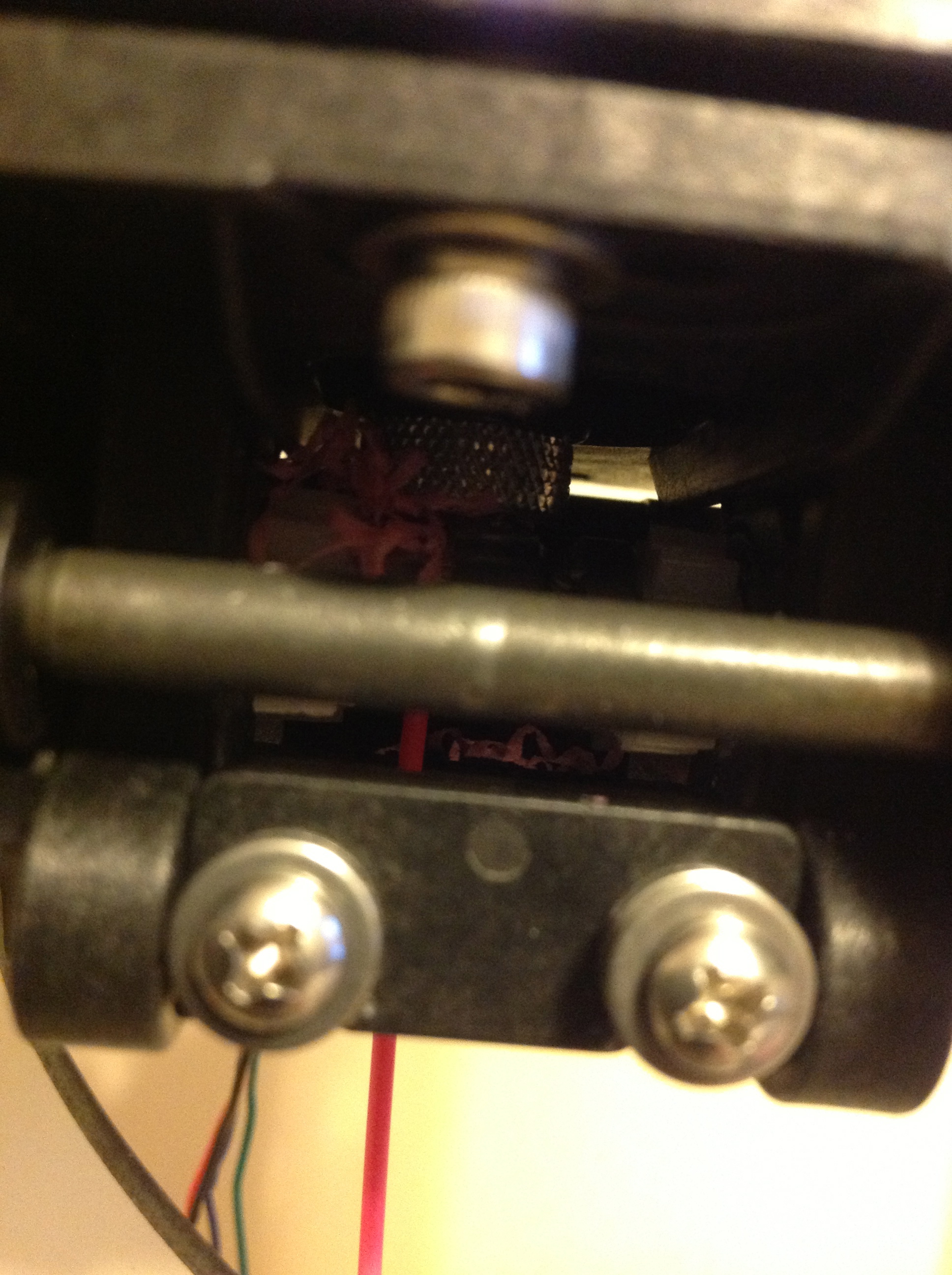

I was starting to print something and started noticing that the filament coming out of the nozzle had deformations, like it was sausage links. I checked the bowden drive and found that there were a lot of "shavings" inside like the filament was getting chewed up by the roller. I figured that the "bites" in the filament were what was causing the sausage links. I decided to change filament just to see if it had anything to do with the plastic. I loaded some different filament and it seemed to be fine while i was loading it and manually extruded quite a bit that seemed to be ok.
Once I started running a job the same thing started happening with the new filament and I found a bunch of shavings. I've tried loosening the tension bolts all the way to where it doesn't feed at, but it still keeps chewing it up as soon as I get enough tension. I've taken the bottom piece out several times and put it back in thinking that perhaps the filament isn't in the groove. I finally noticed that the groove isn't directly below where the tube is and it makes a little bend as it enters the tube to the extruder. I assume it has to be that way as the tube entrance is between the two grooves. Anyone else ever see this? How did you fix it?

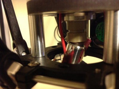

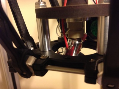

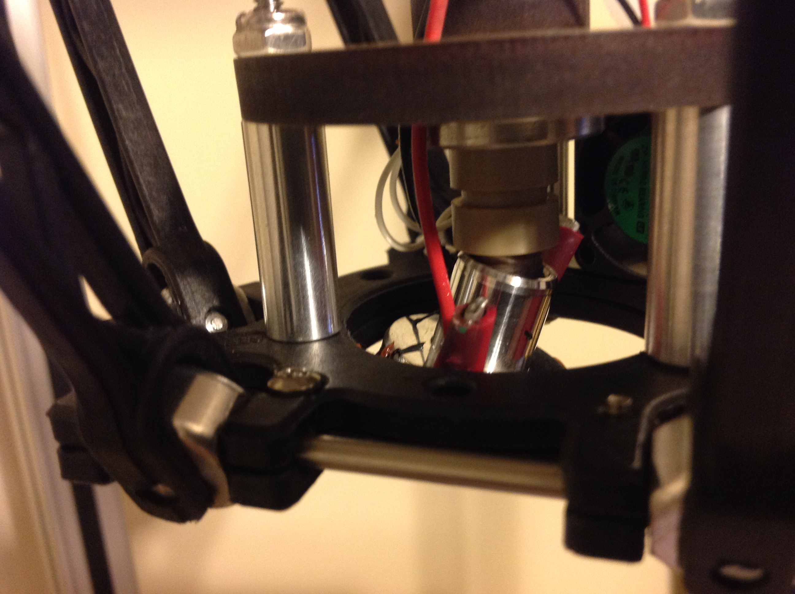

The second issue I ran into was when I started printing a job when the filament seemed to be feeding "ok". I was watching it print and wondering why it started looking like crap all of the sudden when I noticed that the nozzle had moved to the side. Looks like I melted the hot end? I was running the hot end at 240 (printing ABS). Any chance I can fix this without needing a new one? It's still to hot to touch, but I'm wondering if I should even waste my time.
