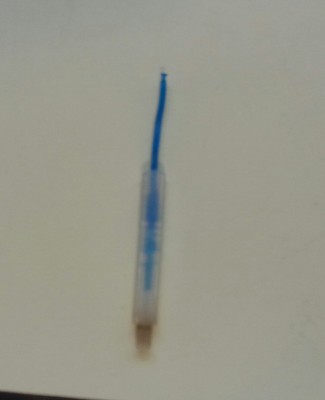

JohnStack
Posts: 839
Location: Carlsbad, CA
Re: Bowden tube connector fail?
Post by JohnStack »
Y'all jinxed me today. I was reading this thread this AM.....
My problem happened recombinantly.
First, I had changed spools but put back on the 3/4 inch cable shield I was using that prevents the cable getting caught on the Z-stop adjusters.
So, the tube gets caught and I have to do a powerdown. I tried doing another print; however, I noticed it was jamming. I pull the hot end tube out and this is what I end up with. Sorry but for the photo quality but I think you can see what happened. It simply broke.
After reading the forum for a while and anticipating some possible problems, I'm very glad I bought an entirely new hot end assy when I bought my machine.
I think this is another candidate for a fix @SeeMeCNC.
http://dropc.am/p/KhiI1a
Posts: 5358
Is that PLA? It looks like a classic PLA jam to me.
JohnStack
Posts: 839
Post by JohnStack »
It was PLA! No getting this tube back.
Posts: 5358
Do you have a small fan on the PEEK section of the hot end?
To clear a jam like that, you normally heat the hot end to about 185C and quickly "jerk" the filament out of the hot end. There's a guide online where this is described, but I can't find it for the life of me. I suspect asking on the irc channel #reprap will turn it up in short order.
