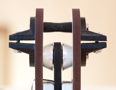

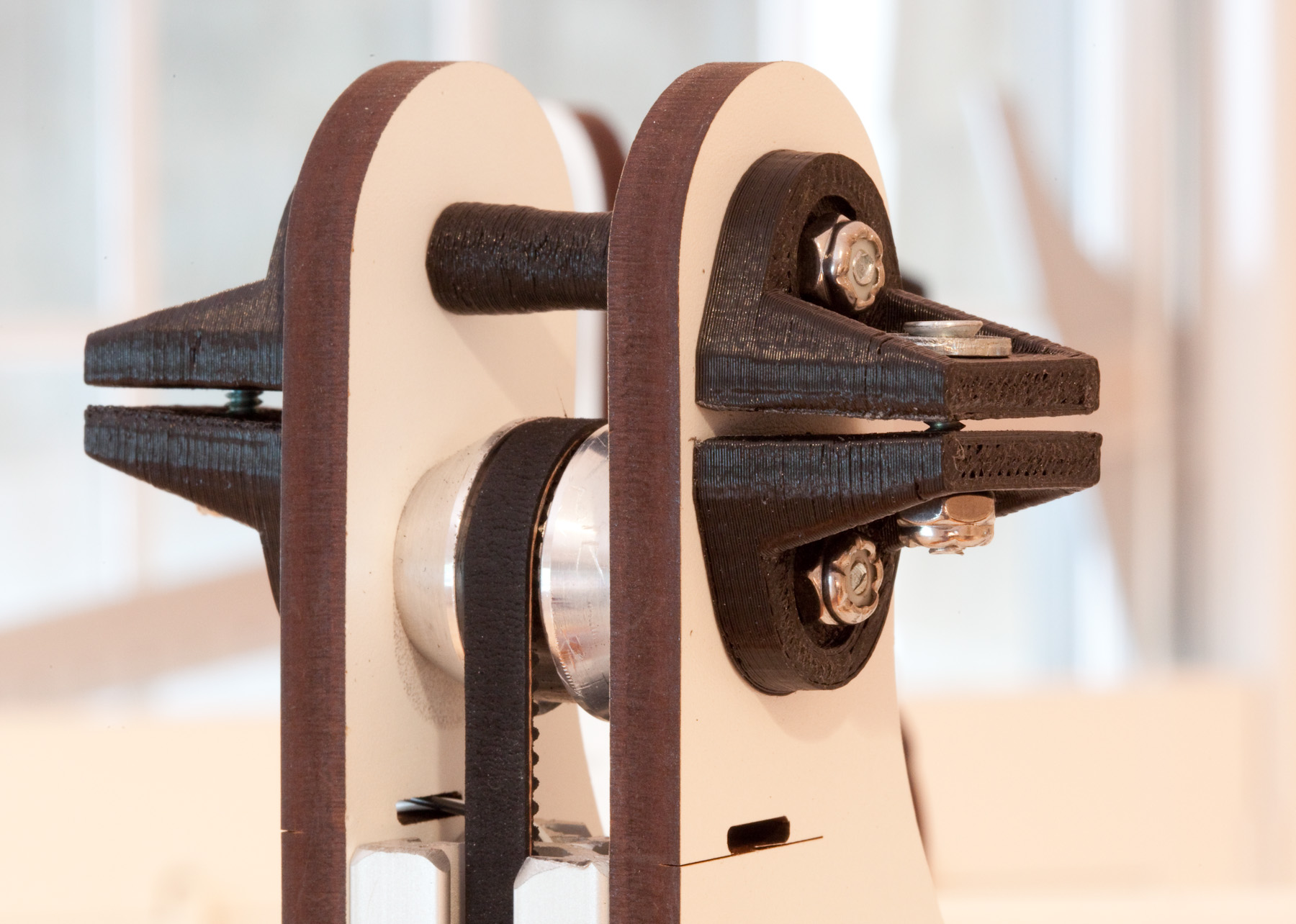

printable belt tensioner / bearing leveler
This thing lets me use a screwdriver to level the idler bearings at the top of the t-slot towers.
http://www.thingiverse.com/thing:87463
I've only been using it for a few days, but so far, it's been working out nicely.

Re: printable belt tensioner / bearing leveler
That's really slick.
BTW, you know you've got your idler brackets flipped, right? The laser engraved alignment lines are supposed to be on the inside surface.
Thanks! I don't think I knew they are flipped... or if I did, then I forgot. Should I worry about it?
btw barnett, one of the things I really like about your design is that it looks like it would be very easy to "balance" the belt to keep it running in the centers of the bearings. If you tweak it a bit to add a nut capture pocket on the bottom clamp, you wouldn't need to worry about having a wrench to adjust it - you could use socket head screws and adjust using a T handled allen wrench...
Thanks, yeah balancing was more important to me than tensioning.
The nut capture idea makes a lot of sense because then the brackets don't have to be so wide. They're kind of extra wide now so my wrench fits in there. At least this way you can use whatever screws/nuts you have handy.
But if I do a V2, I'll use the nut capture idea for sure.
Hopefully barnett you won't mind me doing you a favor and creating the v2 with nut captures. There are now 4 distinct pieces for each tower, all appropriately include M3 (that is what I had the most of) nut captures if needed so that it can be installed and adjusted with only a single tool. The top pieces on each side also now have a small pad that centers them in the hole present in the melamine bracket.
http://www.thingiverse.com/thing:146815
Hope you like!
Hope you like!
This looks great. Thanks for making these improvements!
You did the hard part
All I had to do was constrain the geometry for a few hexagons and watch my printer spit out its own improvements.
This is a really slick design. It exploits what's already there and makes it better.
