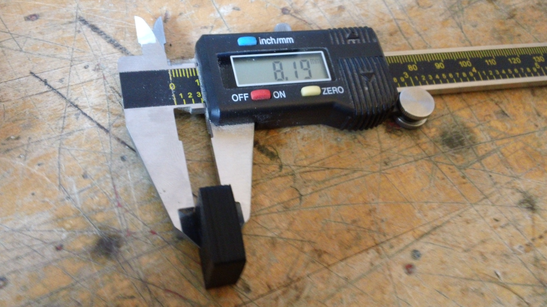

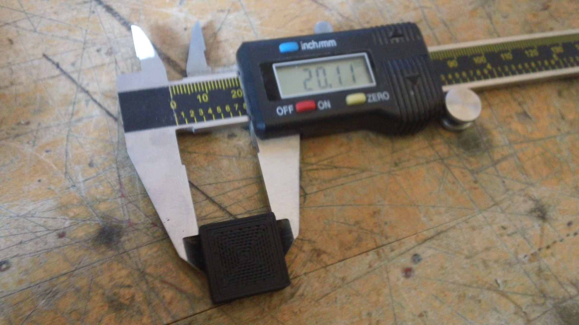

Hello world! I have problem with my H1.1, with no further introduction lets get to it.
My Printer is fantastic with the only problem being that all of my prints turn out about 20% shorter than they should be. I have included photos of what should a 20x20x10 box. Sometimes I can compensate before I print, but guessing how much altering I should do has become a hassle. Perhaps this friendly community has some suggestions. Normally I could just trail and error change my settings to try and find my problem, however my attempts are futile to say at the least. I am running the newest Repetier-Host, it's bundled with the newest Slic3r, and I am using Marlin for my firmware because I have had... issues with Repetier-Firmware. Many thanks for any response and constructive critizism. Cheers!

I do believe your z-axis steps per/mm are 19.1% low. Have you verified that the call for 20mm gets you 20mm in lift?

I don't have the best accuracy, but here are my numbers;foshon wrote:I do believe your z-axis steps per/mm are 19.1% low. Have you verified that the call for 20mm gets you 20mm in lift?
Command|Result
0.1= 0.0127
0.5= 0.3556
1= 0.762
10= 8.001
20= 15.951

The math says you take the steps you expected and divide it by what you got. So if your steps/mm is 700 you would take 700x20=14000/15.951 and your new steps/mm would be 877.687.
