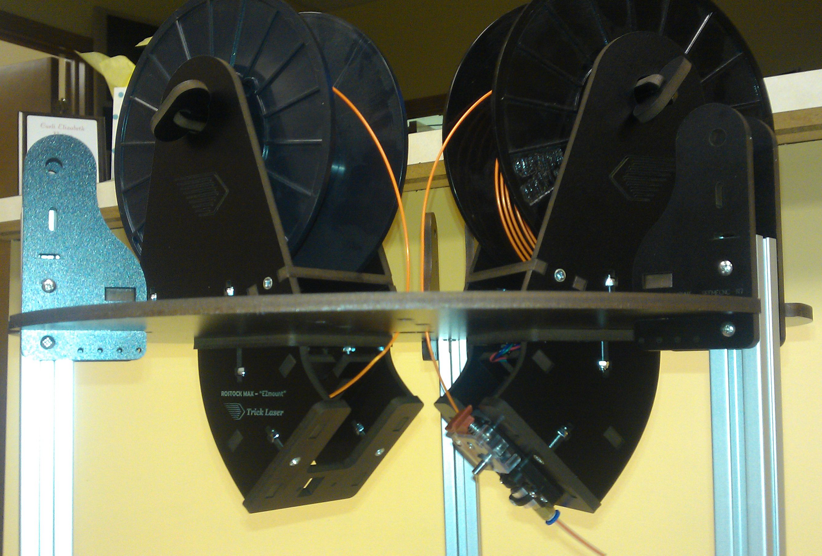

I have just posted up a top mounting bracket and spool holder for the EZStruder. Boy am I glad to clean this up and get rid of the OEM mount hanging off the side.
You can purchase it from Trick Laser
http://www.tricklaser.com/EZmount-KIT-f ... MNTKIT.htm
We are calling it the EZmount.

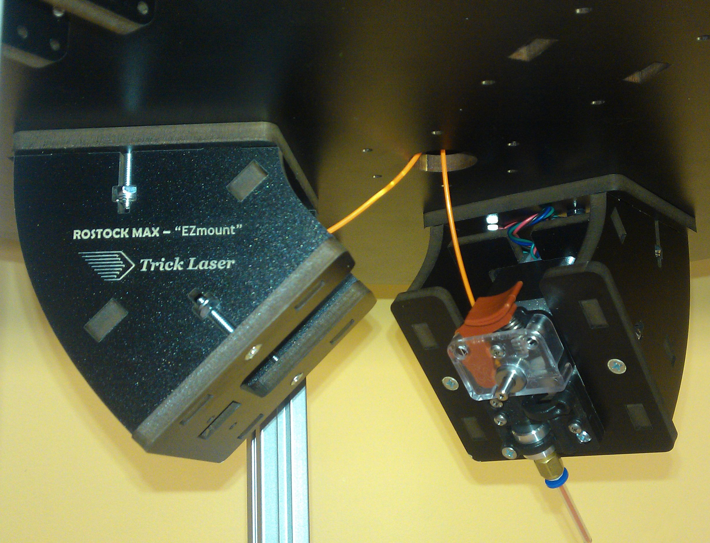

I can't quite tell from the photos. Does this aim the bowden tube outward between two columns?

Where did you route the extruder stepper wiring?

Just temporary right now, motor wires are just hooked over top idler spacer, hanging down outside one of the columns. I plan on running them down extrusion slot covered with some metal trim... http://www.tricklaser.com/T3-Trick-Tslo ... 3-TRIM.htm
Yes, the extruder mounts angling down to make the bowden tube bend in a spiral on it's way to the hot end. I will post better pics later this weekend.

sure the EZStruder top mount will work with our "TL" or "Tron" styles but not the tri-force frame... yet.
I see no reason the added 4" height would be a problem with top mounted EZStruder other than you may need a bit longer bowden tube. Also, the spool on top adds 9" above top plate so make sure you have enough ceiling height.
~*Brian

we designed it to be "EZ" and versatile. Did you know it can now also hold 4" wide spools, like the ones from Rainbot3D.
Did you also know that we offer the spool holder separate from extruder mount, that way you can have 3 spools stored on top with one extruder for quick color changes?
Being tucked up high and at a angle really works well so the bowden tube spirals to hot end.
~*Brian
