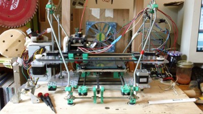

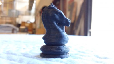

I do have a 50mm fan on the back. It kicks in occasionally, I don't know what settings to put in under that cooling section in slic3r, so I left it default. How do I go about making it so it slows and cools after the first 75% of the print? Here is a picture of my setup and my best print so far. You guys are really helping, thank you!foshon wrote:dsnettleton wrote:I agree that it's too hot. I always thought slowing the print speed down would increase heat buildup, though. Am I wrong?Looks too hot IMHO, I would slow the printer down to 50% when it gets about 3/4 up the head.
In my experience allowing the lower layers to cool a bit before I lay more down seems to cool everything down. A fan would accomplish much the same thing.

Eaglezsoar wrote:I assume from all the talk about fans that all of you are using PLA?
From the way the top of that knight looks, it wouldn't make a difference.

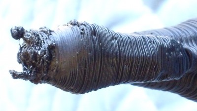

I'm printing ABS. This is what my heat issues look like:
[img]http://i.imgur.com/h0YfBy2.jpg[/img]
[img]http://i.imgur.com/uo2E8Hl.jpg[/img]
- foshon
- Posts: 600
Re: Tops of my prints get ruined
That looks more like speed to me Jim. In the first pic you can see circular layers that were pulled inward from poor/no adhesion.
