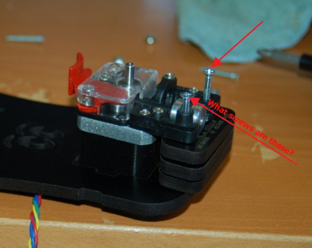

Can someone identify what screws are to be used here? None of the ones remaining in my kit seem to work.
Posts: 5359
Re: EZ Struder instructions?
You should have 1 2" #6-32 and 1 1.75" #6-32 pan head screw. Use those and two #6-32 nylon lock nuts.
