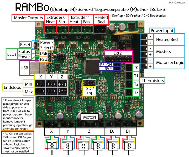

Hello all,
Ok, good news before the bad. I got my Rostock Max all calibrated, with the hot end and Onyx bed heated to operating temp first. I did all of the Repetier setup, even got the hot end primed (did the 300mm extruder priming). Woohoo can't wait to FINALLY print!!
Bad news is, I've discovered that with the Logisys power supply, I can't heat both the hot end and the Onyx bed at the same time for very long. After a few minutes, there's a mechanical click sound, and the Logisys power supply goes out. I know this because the power supply's cooling fan stops running (and of course, the LCD display attached to the RAMBo goes out.) Flipping the power supply off and and back on again brings it back. If I heat ONLY the hot end or ONLY the Onyx, I can stay powered up indefinitely, so I doubt I have a short in either one. Just in case, I have checked for shorts both at the hot end resistors with a mutitmeter and visually at the power supply connectors , and found no shorts.
I have the power supply wires to the RAMBo done correctly; I have the four yellow and four black in parallel for the needed current and the single blacks and yellows as per Gene's assembly manual.
My guess is the Logisys doesn't like the current draw from heating the hot and and the Onyx, and some internal circuit breaker trips.
Anyone else having/had this problem? It sure seems like an inadequate power supply issue. Gah! I just want the setup to be OVER!! X(
I really need to get this up and running for our office, any help is greatly appreciated!

Sounds like you may be correct. It could also be a short that occurs during heating due to expansion.
If you have a volt metere check the leads of the onyx immediately after the trip to see.

Do you have a metal plate on top of the Onyx heat bed? If so that could be the cause of the short as Flateric mentioned.
You must cover the exposed traces on the top of the Onyx with Kapton tape if you use a metal plate on it. See here to

Do you have a model number for the Logisys supply?
Purple = sarcasm
Re: Logisys Power Supply circuit breaker tripping?
Logisys PS480D-BK.foshon wrote:Do you have a model number for the Logisys supply?
It is nominally 480 watts, but only rated for 16A of +12V.

For now, how do I wire a separate Rambo controlled PSUs for the Onyx? I'm sure I could figure it out if there are separate power in pins for the hot end and the Onyx, I don't have the Rostock in front of me at the moment, can't remember
Or, what if I change the number of paralleled power wires? Would dropping from four to three or going up to five help?
Foshon, above the barcode on the Logisys box it reads PS480D-BK.

The image shows that power applied to the 1st connections (orient the board properly) goes to the heated bed.designfactore wrote:Thanks all,
Shutting off in mid abs print? So much for that 14" build height with a Logisys!
If you use 24V here do not exceed 15 amps or the fuse on the Rambo will blow. Another way to do it is to supply
all power inputs with 12 volts and connect the heat bed output to a DC-DC SSR input. The output of the SSR would
be connected to 24 Volts and feed the heated bed. Be sure to use an inline fuse when going this route. Cambo3d has
a good writeup in the build section that you should read to see how he connected 24v to the heat bed.

--Detach the wires from the Rambo that go out to the Onyx (the heat bed outputs)
--connect a SSR to the Rambo where the wires we just removed were
--get another PSU for the Onyx, wire it to the Onyx and essentially use our SSR to connect or cut off the PSU current to the Onyx

Yes, you understand perfectly. Some of us are using a 24V supply for the Onyx via the SSR but try this at your own risk. I have not read of any problemsdesignfactore wrote:Thanks guys!

So John and Julie from SeeMeCNC sent me a replacement power supply, same brand but different model as requested. Been printing for hours with no issues! The bed heats up reasonably fast, about the same amount of time as the hot end takes. A tip here : use a heat gun to boost the warmup time of the Onyx! Just be sure to keep the gun moving and heat evenly to prevent warping. So far the new power supply is maintaining 230 C on the hotend and 80C on the bed just fine. Btw, PSU swapping is a super easy installation, there's enough clearance to get the old out and the new in without having to disassemble the base whatsoever.
Thanks for all the help and suggestions, I may yet do that 24volt bed mod, but first, dual extruders (hopefully, Ihaven't gotten a clear idea on how feasible that is). Anyone have video of that working?

If you do decide to use an SSR be sure to use a heat sink made for that purpose under the SSR. They get too hot
to run without a heat sink. There have been instances where users burned up the SSR because they did not use one.
