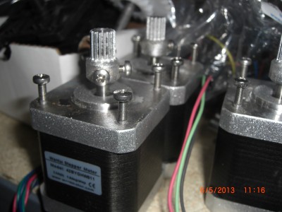

Re: Rostock MAX Assembly: M3 x 10mm pan head screws
screws should look like this, unless they changed it, or got mixed up parts.
as long as there m3, and long enough. they will still work.

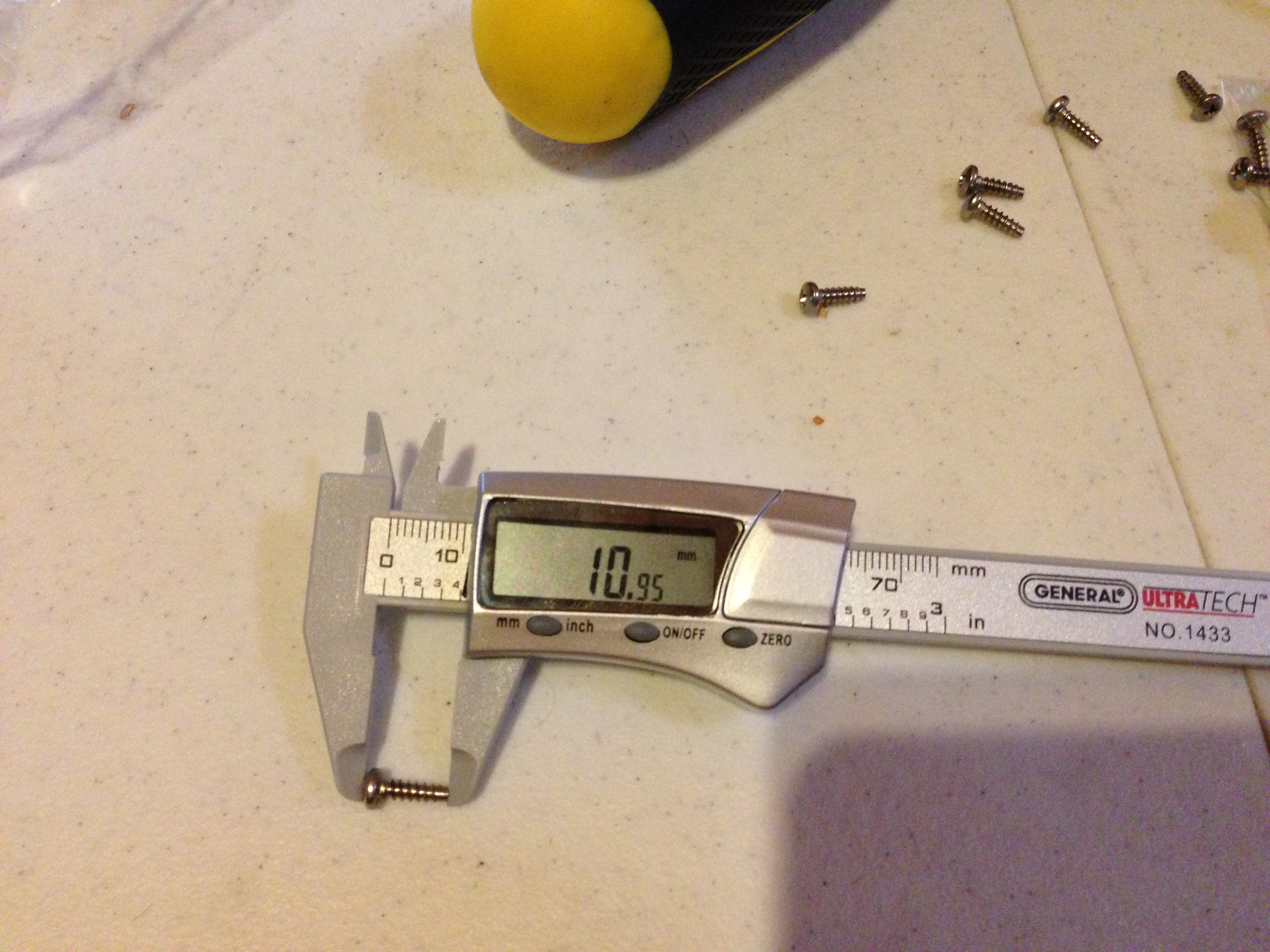

This is what I got:
Chandley wrote:This is what I got:
those aren't m3 screws. look at the threads in my photo above. they have a finer thread. dont put those into your stepper motor. you will damage the threads of the stepper motor. If you get them in at all.
the screws you posted look like the screws used in the rostock platform /effector assembly
Those look like #6 sheet metal screws, and will damage the threads on the stepper if you force them in.
Look in the packet with the extruder, there should be 4 in there and the others are in a separate packet, unless the packaging has changed since I built mine, which is quite possible.

Thanks cambo3d, that certainly would explain why they wont catch. Unfortunately I simply dont have any other screws that even come close to the right size. Off to the hardware store.
