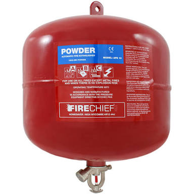

And that's why I have a couple automatic dry powder extinguishers and a smoke alarm suspended above my printer.
For under the top plate
[img]https://encrypted-tbn0.gstatic.com/imag ... JEA4eJIEgZ[/img]
Above the printer if the first one doesn't work
[img]https://encrypted-tbn1.gstatic.com/imag ... 4zMHEMbe9Q[/img]
