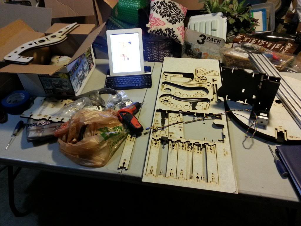

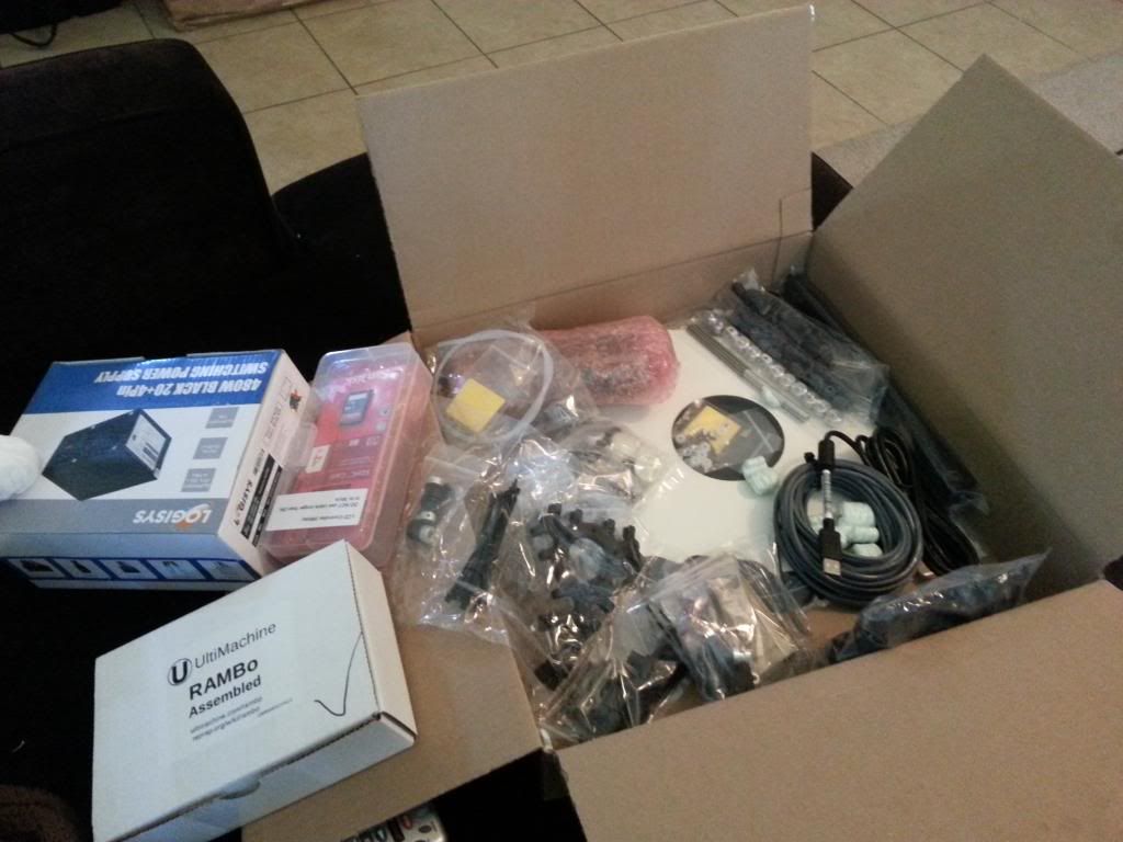

After a break, I figured now is a good time to show some pics!
[img]http://i1326.photobucket.com/albums/u65 ... d5d2b9.jpg[/img]
Packed up Nicely!
[img]http://i1326.photobucket.com/albums/u65 ... ca50d8.jpg[/img]
Out and ready to go.
Packed up Nicely!

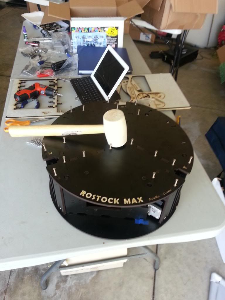

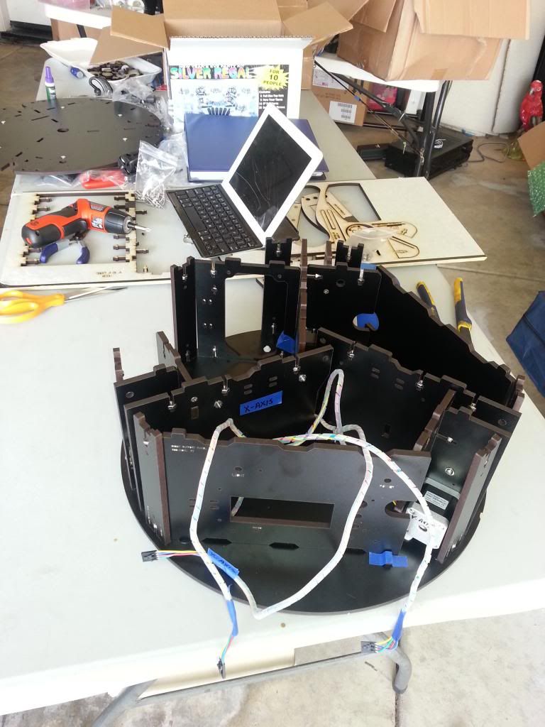

[img]http://i1326.photobucket.com/albums/u65 ... 2747ff.jpg[/img]
It started out slow. But once I got in the flow of the manual, I picked up the pace in this area of the build
[img]http://i1326.photobucket.com/albums/u65 ... 74ebe1.jpg[/img]
THIS area took some Eye coordination, gentle touch, and a LARGE mallet...... just kidding!....... din't need the gentle touch. Ha

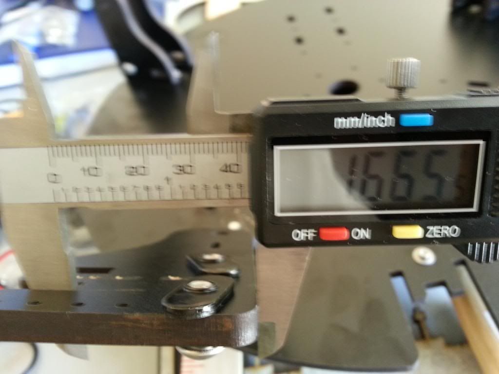

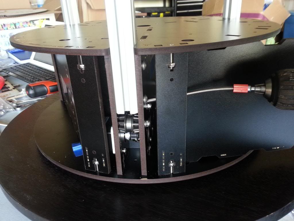

[img]http://i1326.photobucket.com/albums/u65 ... 38eb7a.jpg[/img]
Leveling these things was a Bear! OH, also I pulled my Lazy Susan off the dining table and put the printer on it. SOOO much easier than having to either walk around the thing constantly, or wear out the feet turning this thing!
[img]http://i1326.photobucket.com/albums/u65 ... 54567b.jpg[/img]
THEN I realized the top ends were too thick, so I had to file them down a bit.

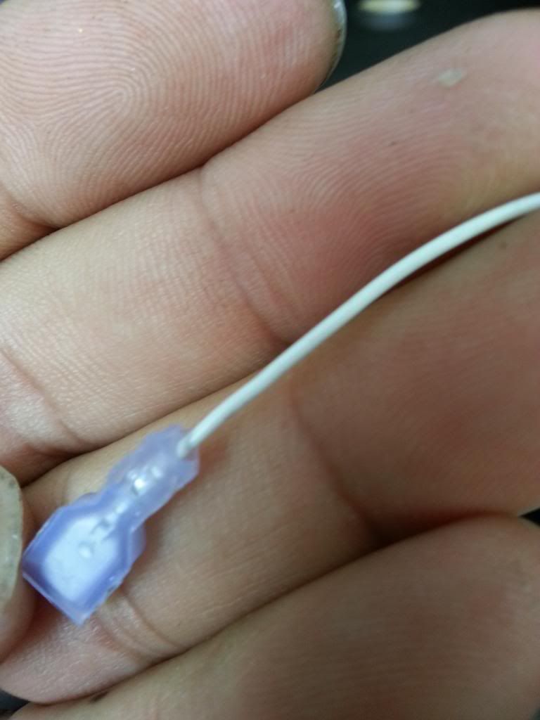

I cut the excess plastic off the rear of this because it ws too tight when connected to the stopswitch.

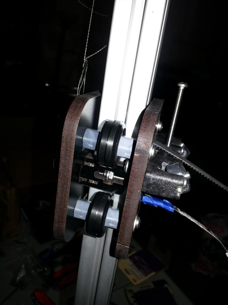

Re: My "FUNstock MAX" has arrived!
[img]http://i1326.photobucket.com/albums/u65 ... f18f75.jpg[/img]
I used the plastic method for the band, but needed tape to make it work. Also, I suspended the brackets with string to better to the belts on. I'm up to this point but I'm short some screws for the clamps, so I have to go buy some

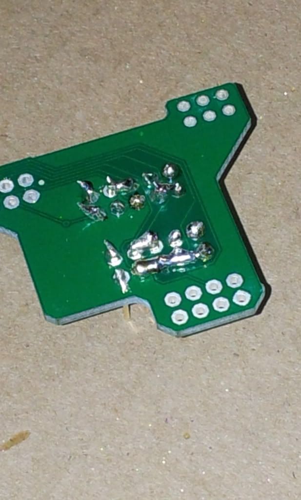

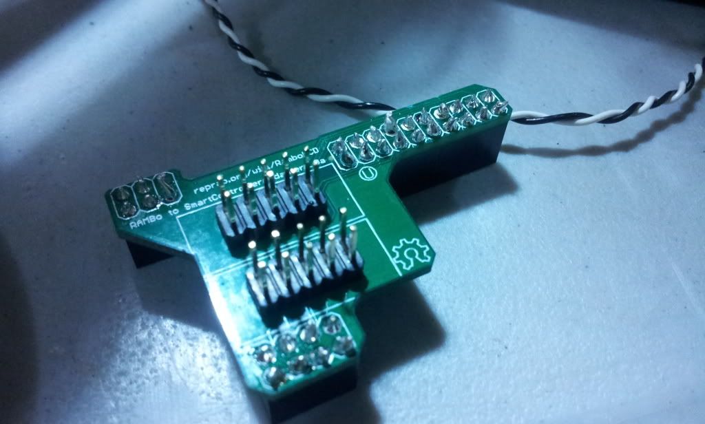

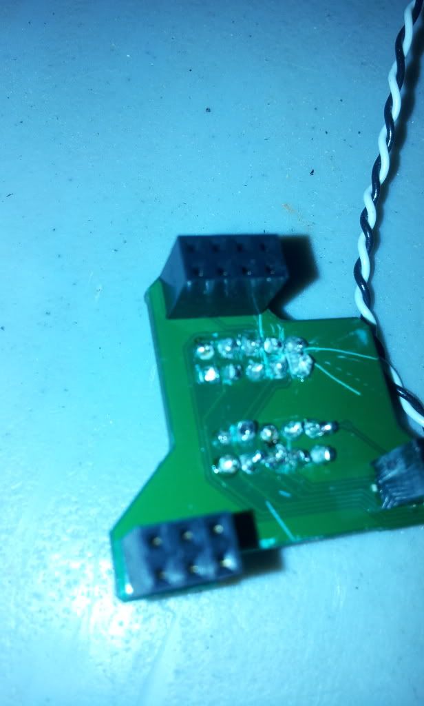

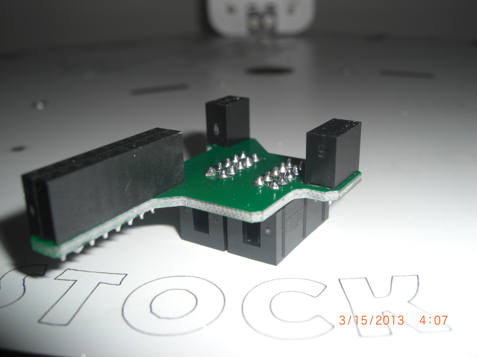

QUESTION...when soldering on the LCD board area, is it important that the solders do not touch other pins, or is it ok? I'm not good at this and some of my pins are connected through the solder
[img]http://i1326.photobucket.com/albums/u65 ... 889fe4.jpg[/img]
Correct. Remove the excess solder and make sure the adjacent pc board pads do not touch each other with solder. Also make sure you get a good connection between the pin sticking through and the pad.m4r1n5 wrote:QUESTION...when soldering on the LCD board area, is it important that the solders do not touch other pins, or is it ok? I'm not good at this and some of my pins are connected through the solder
I am not the electronics guru, but I'm pretty sure this is a bad thing. Each connection should be separate. You can still salvage this board. Just use a solder pump to remove the first try and you get a do over. A lower wattage, very thin soldering iron will help here.
solder pump link: http://www.amazon.com/Desoldering-Vacuu ... ering+pump
Soldering iron(reasonable price): http://www.amazon.com/Soldering-Station ... ron+solder
Excellent link posted by foshon: http://www.youtube.com/watch?v=I_NU2ruzyc4
Hope this helps
solder should look something like this,

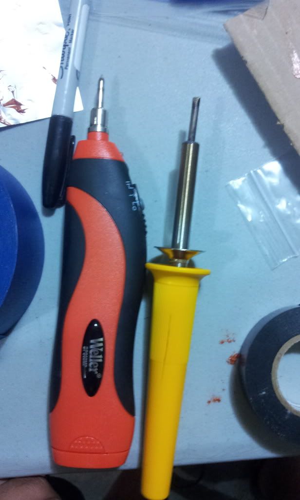

[img]http://i1326.photobucket.com/albums/u65 ... 9e3be7.jpg[/img]
My problem, aside from barely any exp., was I used the one on the right..so I bought the one on the left. Batt powered but works well. I couldn't undo what I did, so I had to take a blade to it. SAD, I know, but the only way I knew how.
[img]http://i1326.photobucket.com/albums/u65 ... 6896f1.jpg[/img]
BUUUT, I did much better with the proper tool.
[img]http://i1326.photobucket.com/albums/u65 ... 1c429e.jpg[/img]
Ouch.. I'd be very surprised if that board still works. It looks like you cut a bunch of traces on the circuit board when you tried to undo your solder bridges.m4r1n5 wrote:, so I had to take a blade to it. SAD, I know, but the only way I knew how.
You should have either a) used solder braid, b) used a solder sucker/vacuum tool or c) let someone with more experience soldering fix it for you.
The yellow soldering iron probably would have worked fine if you got a smaller tip for it.
