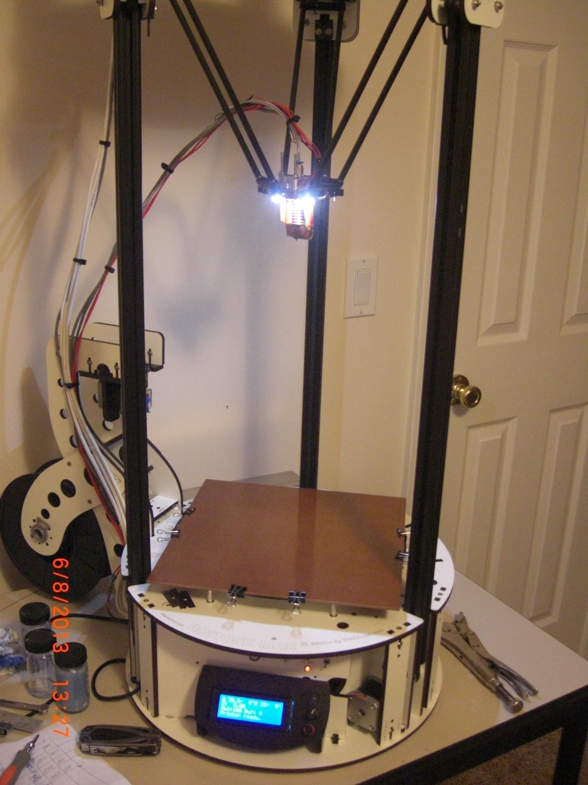

Not sure where to put this post but since i'll be using the rostock for this, I guess this would be a good choice?
but anyway, i'm about to start printing with nylon. I believe i have everything i need to get started, along with the manufacturers suggested settings and bonding surfaces listed here. http://taulman3d.com/618-specifications.html
but anyone have real world experiences to share? I hear it warps but is also difficult to remove from garolite le. That being said warping should be minimal, no ??
I ordered garolite le and some cast nylon sheet to try. Hopefully these manufacture recommendations don't steer me in the wrong direction.
I'll be doing some prints with it this weekend and hopefully i'll have some decent prints to show off.

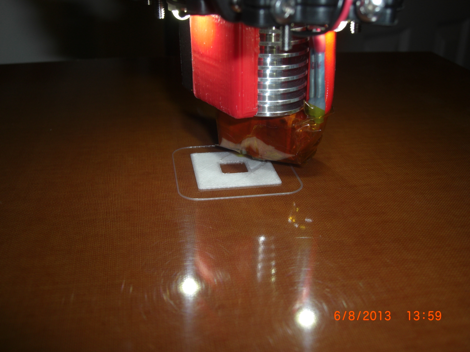

nylon calibration cube printing..
garolite le was about the same thickness of my boro 1/8"
sticks so far, If this works out i'll machine it to match the diameter of the boro. first impression so far: a lot of moisture in the filament, definitely warps, quarter of the way through this print and i'm already seeing signs of warping. Which is probably gonna get worse as the print progresses.

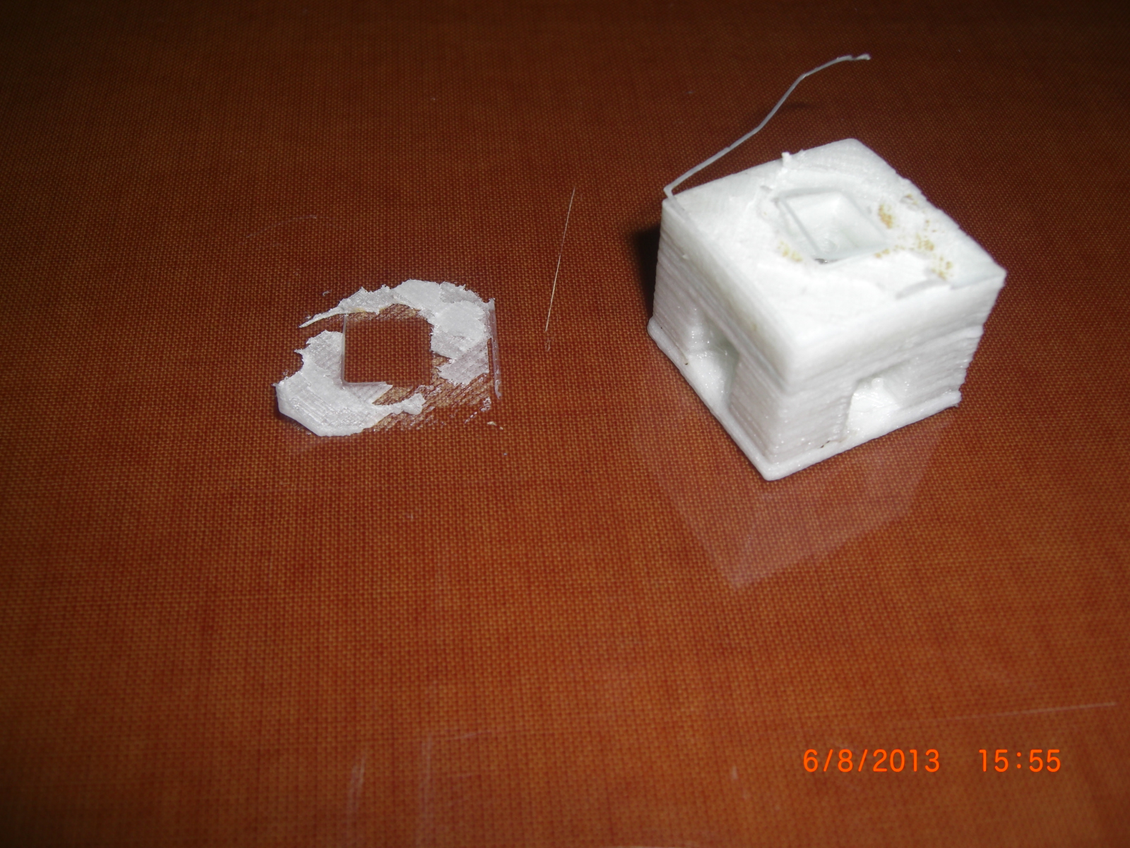

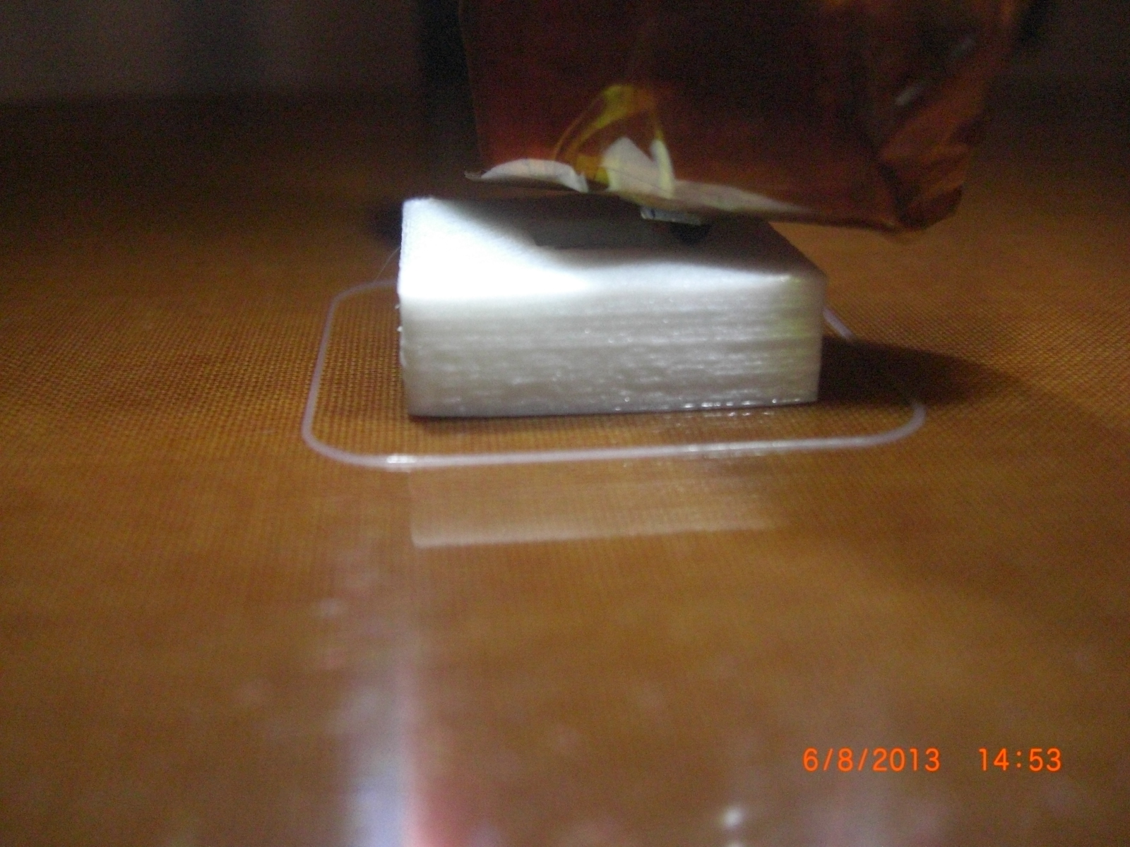

Re: printing with nylon
seeing how it was turning out so far, decided to stop the print
preliminary findings:
Garolite le is working really good as the print surface. too good actually
I couldn't remove the printed part without damaging it. bummer
so manufacturer was right about this one.
warping didn't get worse after all, my guess is that it stuck too well to warp anymore. just minor warping at the edges.
Nylon seems to be moisture prone, will have to bake it for the next try.
I'm guessing if I can get rid of most of the moisture in the nylon, it may help minimize warping also.
ED3 hot end is printing just fine with it, I had it up to 260 during some of the print, and the cold side was barely warm to the touch.
retraction for nylon needs to be increased to get rid of stringing.
Need to figure out to remove these stuck pieces of nylon now.
Seems like it got welded it to the surface of the garolite. sanding might be my only option

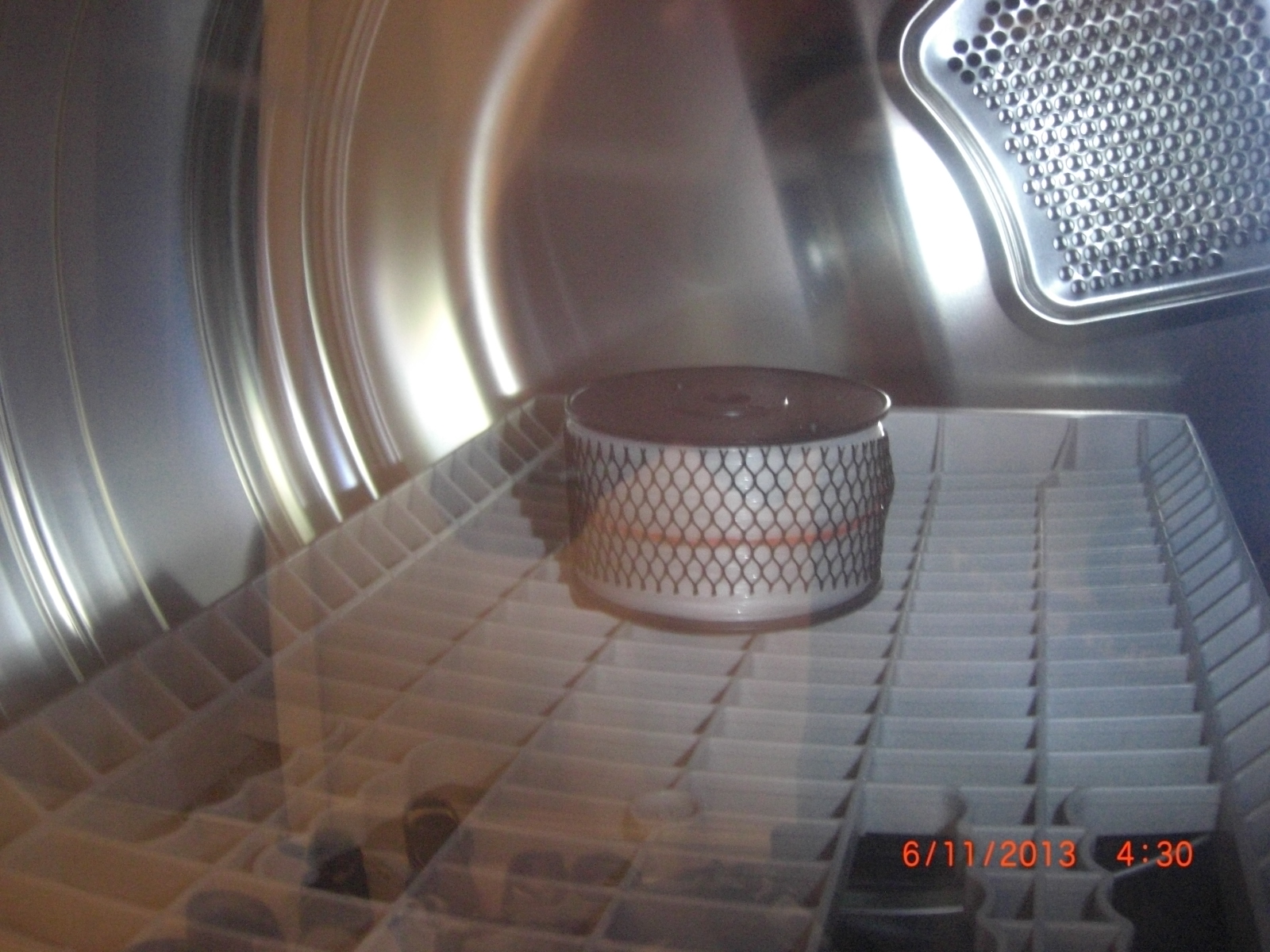

my temporary super hitech nylon drying centrifuge. ok not really but sounds kool =P
Its drying in my clothes dryer at the moment.

Flateric wrote:How hot do dryers get inside? I myself don't have a clue.
My GF will hate this idea without the slightest doubt.
good question, im not sure myself but i'll check with my thermocouple meter.
edit: just checked it with my thermocouple meter and it reads between 65c (159F) and 97c (206f) , on medium heat.
not sure how long I need to leave it in there or what temp it should be, but its been in for 1.5hrs. another 30 minutes i'll take it out for a go in the printer.

How do you keep the spool from tumbling?
Eaglezsoar wrote:How do you keep the spool from tumbling?
my dryer has a shoe drying rack, i just put it on that,
Now that is a neat idea, I'll have to find one to fit my dryer. I didn't know such a thing existed.cambo3d wrote:Eaglezsoar wrote:How do you keep the spool from tumbling?
i think most of the newer dryers come with this.

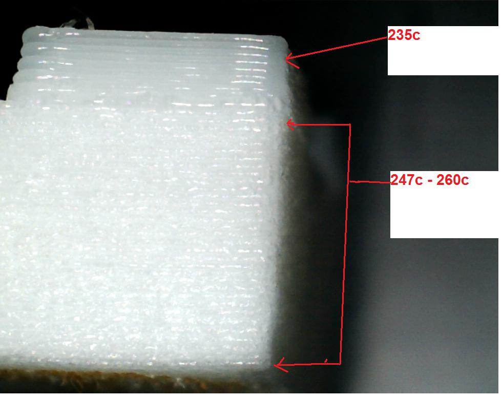

on another note:
I've been experimenting with temperatures. 235c for nylon seems to give the best print quality so far.
I've tried 247c - 260c and the print just doesn't come out right. It leaves roughness in the layers. At 235c this roughness seemed to go away and smooth out. I was under the impression that nylon required a higher temperature to print..hmmmm
Drying the filament in the dryer helped to almost eliminate the moisture in my nylon. There's still some noticeable steam and popping occasionally but not constant like before. Maybe leaving it in the dryer for a little longer might remove all.... just started a new print with the new settings. Looking good so far.....
on another note:

Sam,
Is that an illusion caused by the picture or does the left side of the 235 degree portion have half as many layers as the right? It looks like it lost dimensional integrity as well, unless the lower portion is out of spec.

that's the start of the extrusion that needed to be tweaked also. i have it set to extrude slightly more after retractions.foshon wrote:Sam,
